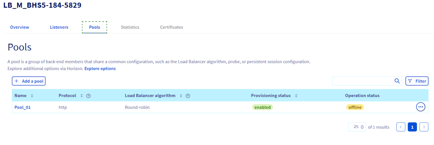

3. Click on Load Balancer in the left menu and select the Load Balancer you want to configure.
4. Go to the Pools tab, then click on the Pool for which you want to create a Health Monitor.

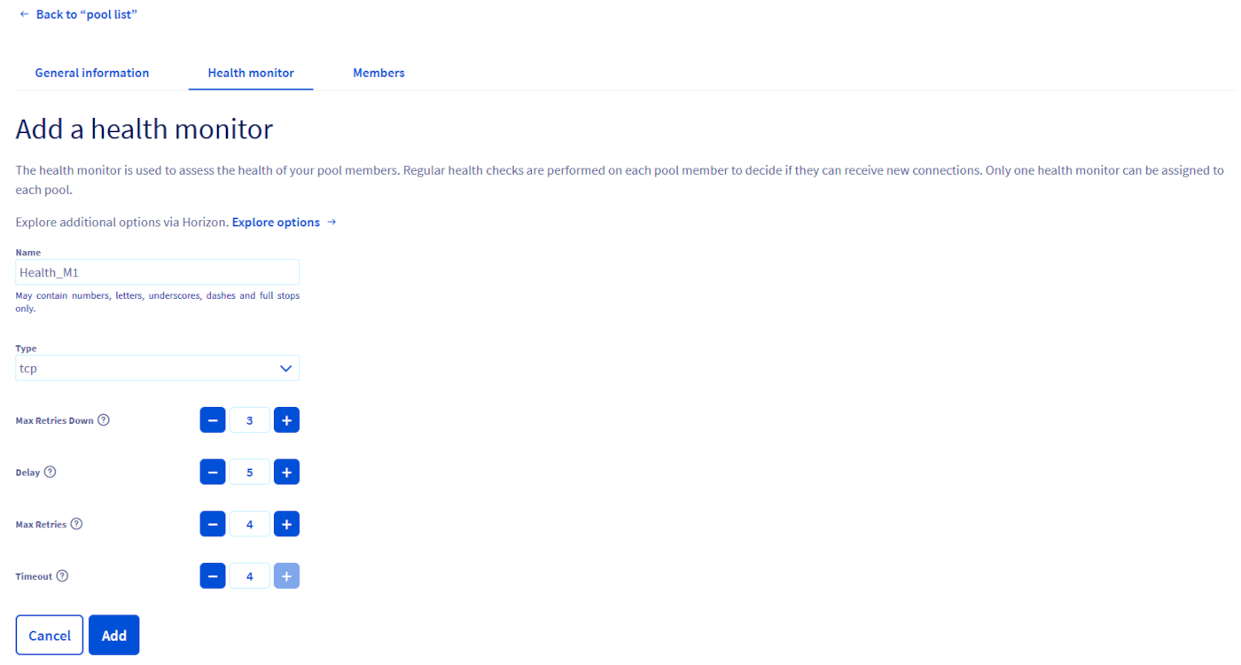

5. Click on the Health Monitors tab within the Pool details, then on Add a Health Monitor.
Schema 1
  • General Information:
    • Name: Must contain only letters, numbers, underscores (_), dashes (-), or dots (.).
    • Type: Select the type of Health Monitor (e.g. HTTP, HTTPS, TCP, TLS-hello).
  • For HTTP and HTTPS types:
    • URL PATH: Specify the path used for the test.
    • Expected Code: Indicate the expected HTTP status codes, which can be a single digit, a list of digits separated by commas, or a range (two digits separated by a hyphen).
  • Test Settings:
    • Max Retries Down: Number of connection failures allowed before marking the member as failing (between 1 and 10, default 3).
    • Delay: Interval between two tests of the Health Monitor (must be greater than the timeout).
    • Max Retries: Total number of connection failures allowed before marking the member as inactive (between 1 and 10).
    • Timeout: Duration after which a test stops (must be equal to or greater than the periodicity).

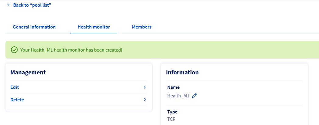

6. Once all the information is filled in, click on Add to activate your Health Monitor.
Schema 1
This process creates a Health Monitor that will regularly perform health checks on each member of the pool, using the results to determine whether the member should receive new connections. Only one Health Monitor can be set for each pool.
