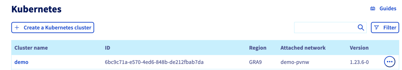

Log in to the OVHcloud Control Panel, go to the Public Cloud section and select the Public Cloud project concerned.
Access the administration UI for your OVHcloud Managed Kubernetes clusters by clicking on Managed Kubernetes Service in the left-hand menu:
Attach a vRack gateway to an OVHcloud Managed Kubernetes cluster

Now wait until your OVHcloud Managed Kubernetes cluster is READY.
For that, you can check its status in the OVHcloud Control Panel:
Create a cluster
As you can see, your new cluster is attached to demo-pvnw network.
And now click in your demo created Kubernetes cluster in order to see its status:
Create a cluster
When your cluster's status is OK, you can go to the next section.
