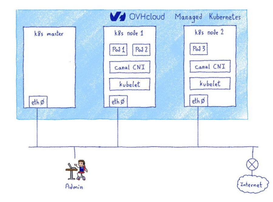

Let's have a look at our Managed Kubernetes without vRack. Both the master and the nodes have IP addresses in a network exposed on the internet:
OVHcloud Managed Kubernetes without vRack
All the traffic between the master and the nodes is done using these IP addresses, as does administrative traffic and traffic to/from resources outside the cluster.

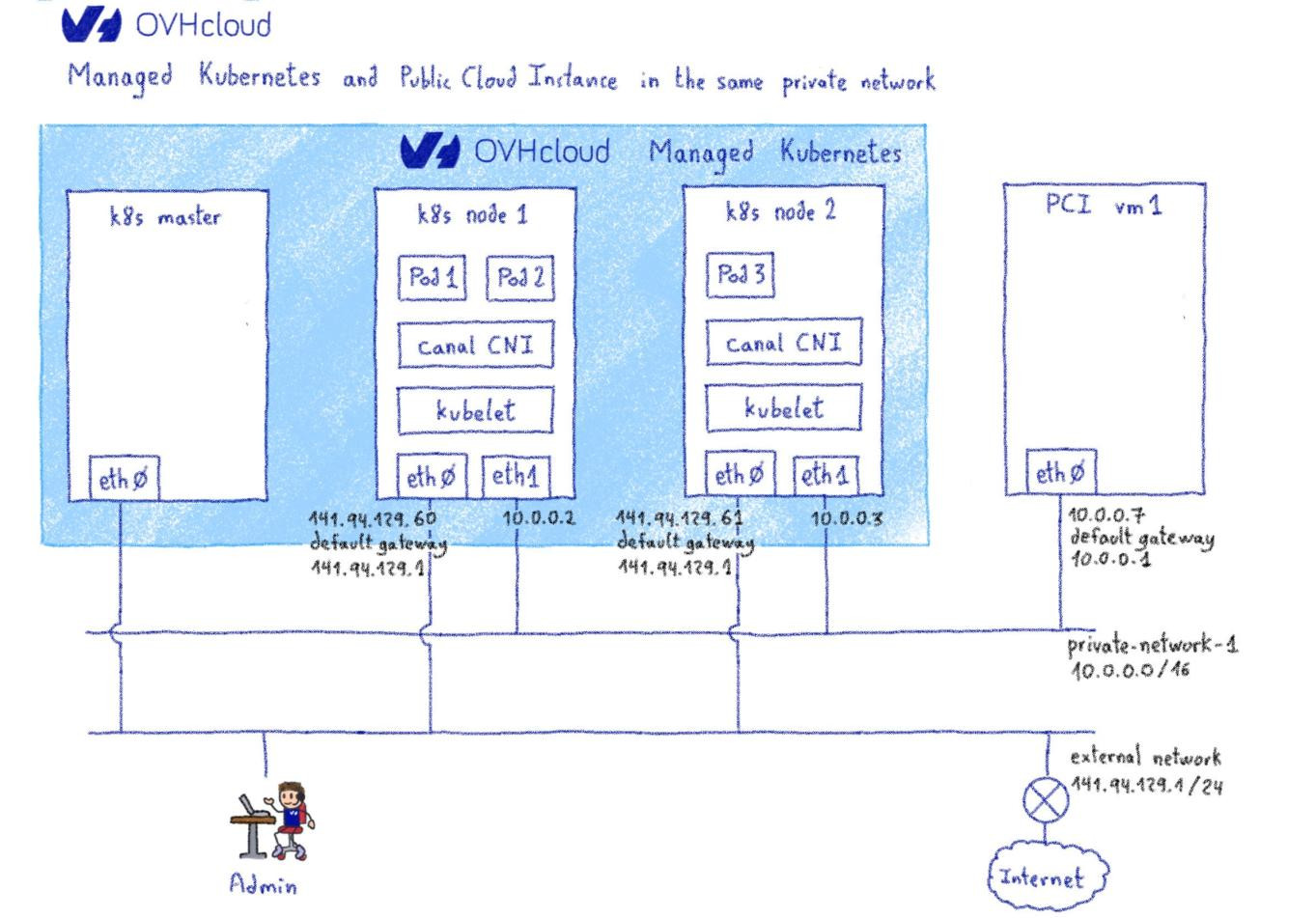

When you put an OVHcloud Managed Kubernetes cluster in a private network in the vRack, a new network interface connected to this private network is added to every node.
OVHcloud Managed Kubernetes inside vRack

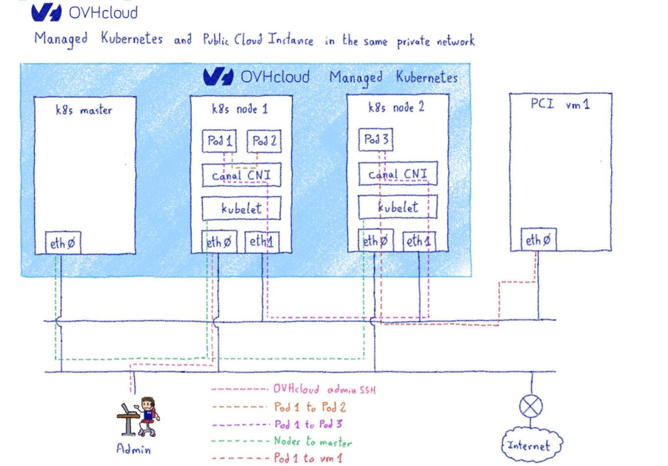

Using the addresses and names in the schema, each node has a eth0 network interface to the external network, and a eth1 to the private network. eth0 is dedicated to the communication between nodes and master, to your managed service administration traffic and to communication with external services. Pod to pod traffic, and traffic to the private network is routed through eth1.
In order to allow this routing, the default gateway for each node is in the external network, via their eth0 interface, and only the traffic towards the private network is routed through eth1.

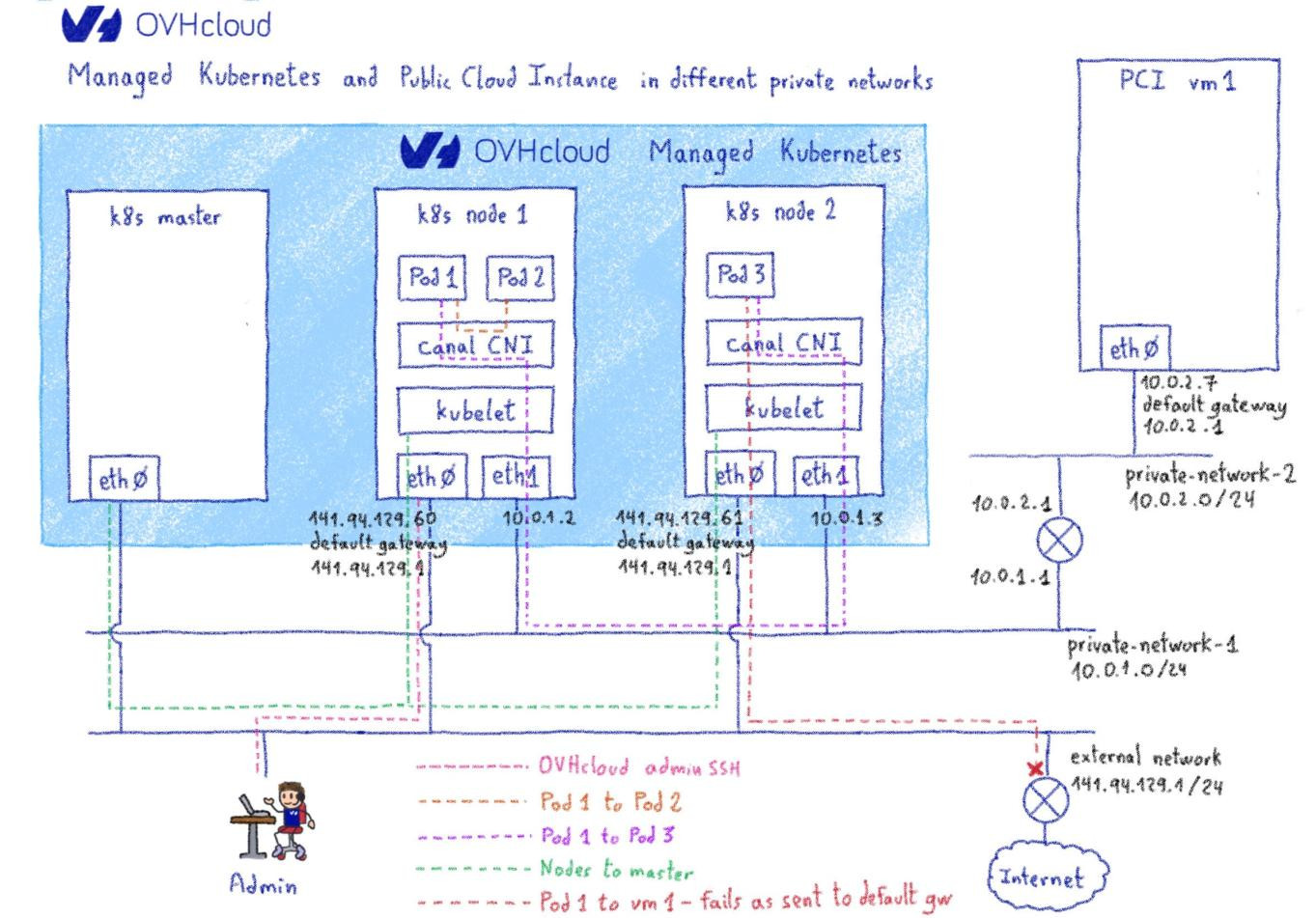

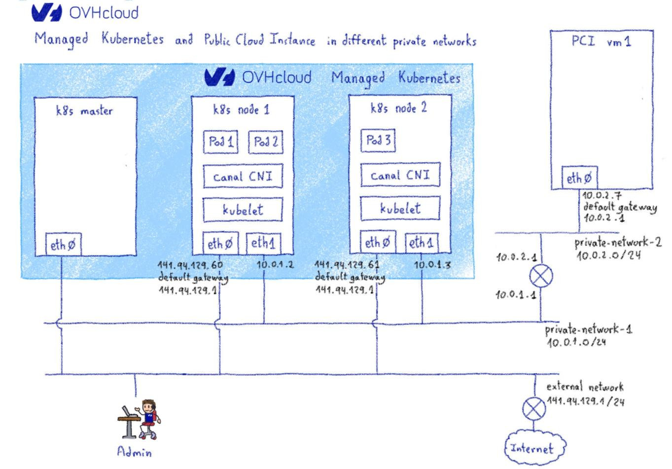

The reason is the networking model we have detailed in the precedent point. Let's adapt the precedent schema to make the PCI virtual machine to be in a different private network than the Managed Kubernetes cluster:
Communication between different private networks
As explained before, in order to allow pod to master communication, the default gateway for Managed Kubernetes nodes is in the external network, by eth0, and only the traffic to the private network to which the cluster is attached is routed to eth1.
That means that if in our schema Pod 3 wants to communicate with the PCI vm1, that is in a different private network, the traffic won't get routed to eth1 but to eth0 towards the default gateway, that has no access to vm1, thus the connection fails.

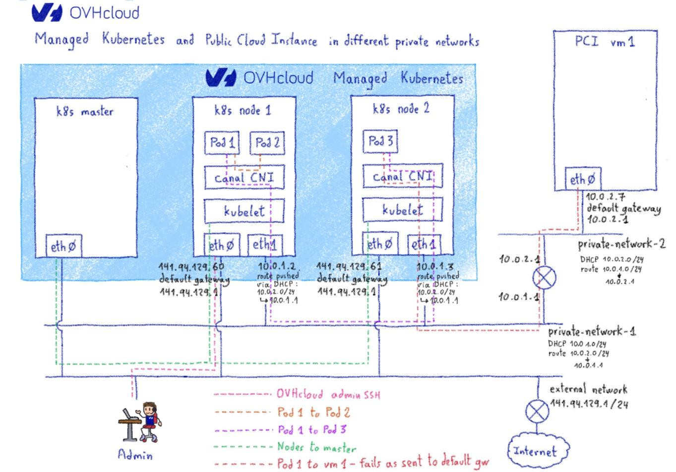

The solution to this problem is to push the routes to the additional private networks via the DHCP of the private networks. This informs the nodes that traffic to the private networks is to be sent via eth1 instead of eth0:
With this setup, if in our schema Pod 3 wants to communicate with the PCI vm1, that is in a different private network, the traffic is routed to eth1, and thus to vm1:
