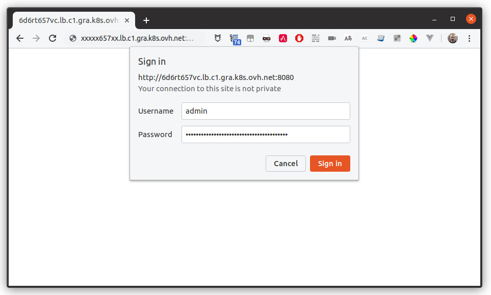

Once the public IP address is available, you may access the OpenFaaS UI at http://PUBLIC_IP:8080.
UI Portal
