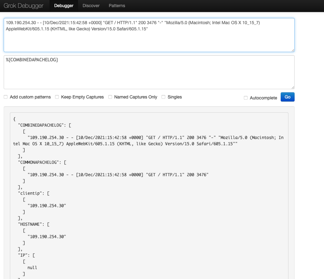

Grok patterns and debugger
As an example of the main pattern matching that are currently used, or to test some more specific ones, you can use some tools like Grok Debugger :
Grok Debugger

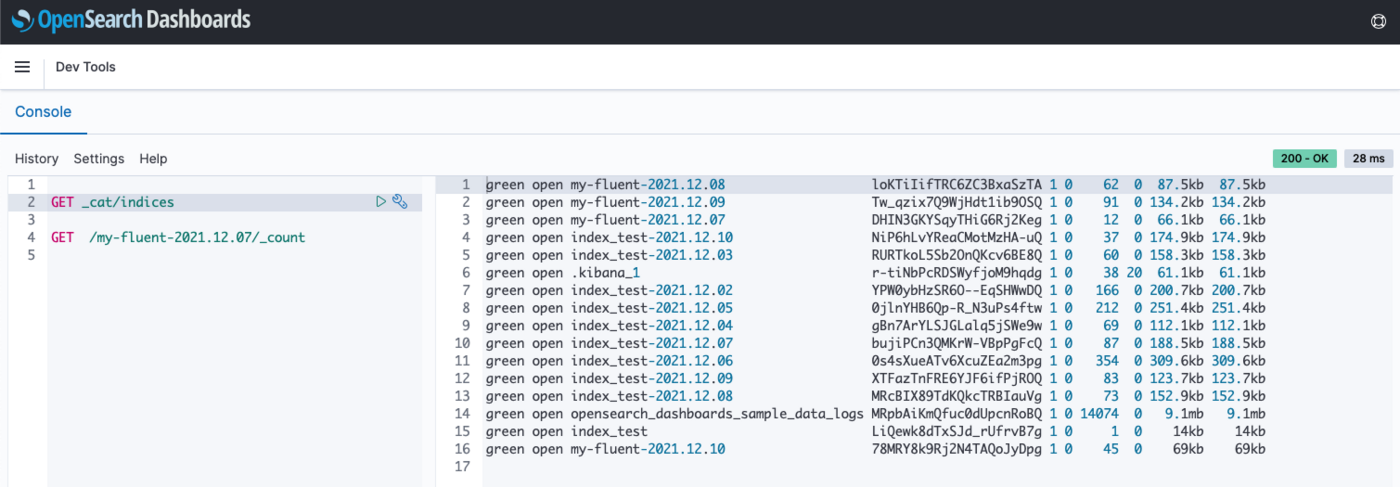

Now that we have Logstash running and parsing the Apache access log file, let's do a different connection to the Apache service and validate that Logstash is forwarding all access data to OpenSearch. Let's also connect to the OpenSearch Dashboard to check that the corresponding index has been created and that some first documents have been populated.

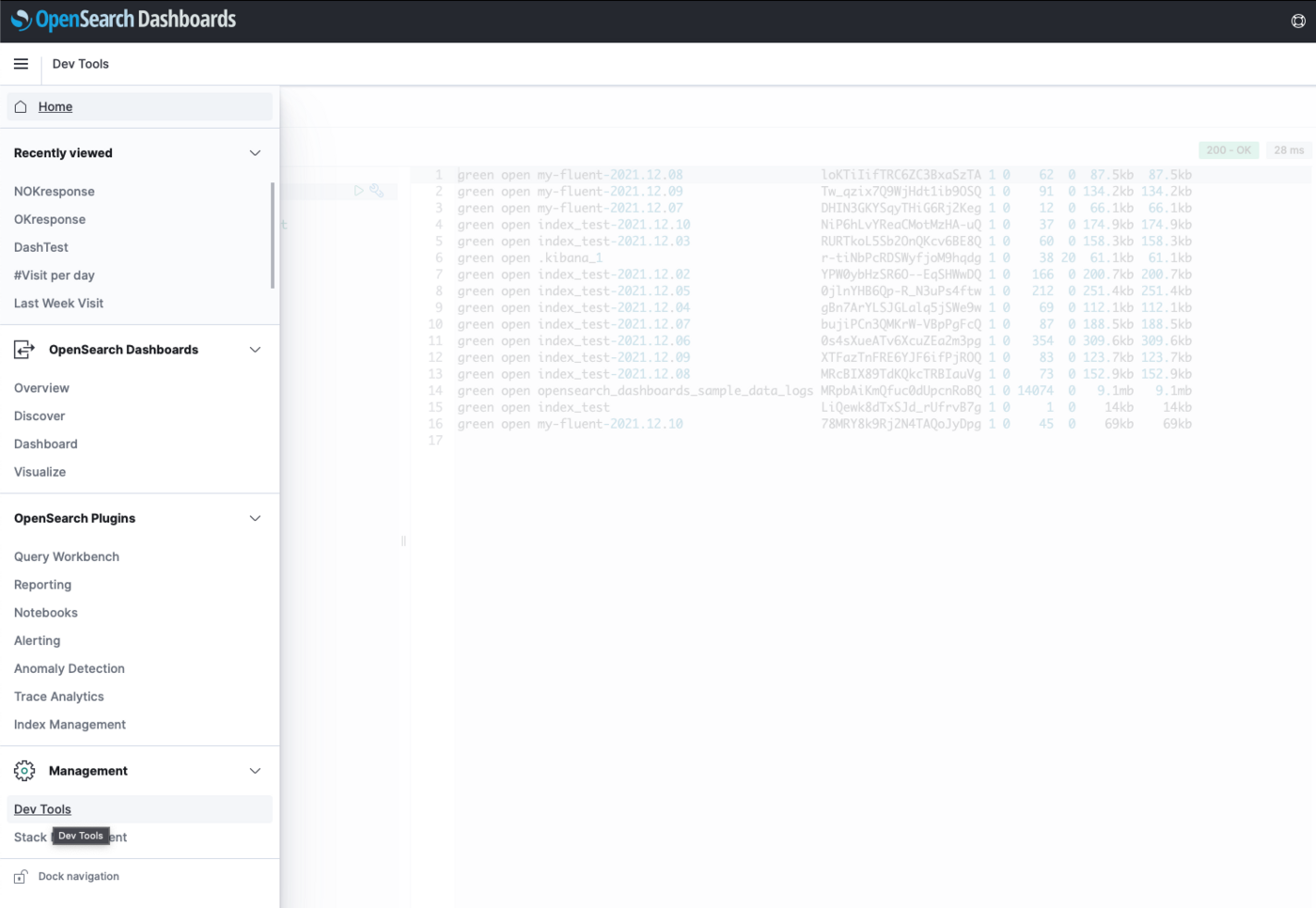

Use the Dev Tools to query the indices:
Dev Tools in OpenSearch Dashboard
Then, in the console, execute a GET /_cat/indices command to get the index list with the number of documents for each:
GET the index list and number of docs

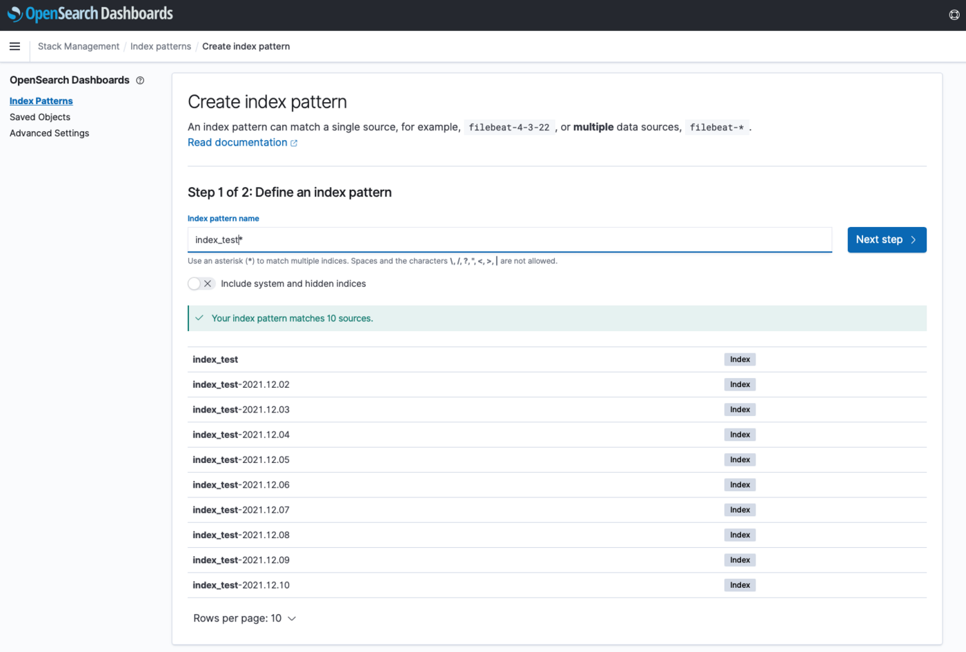

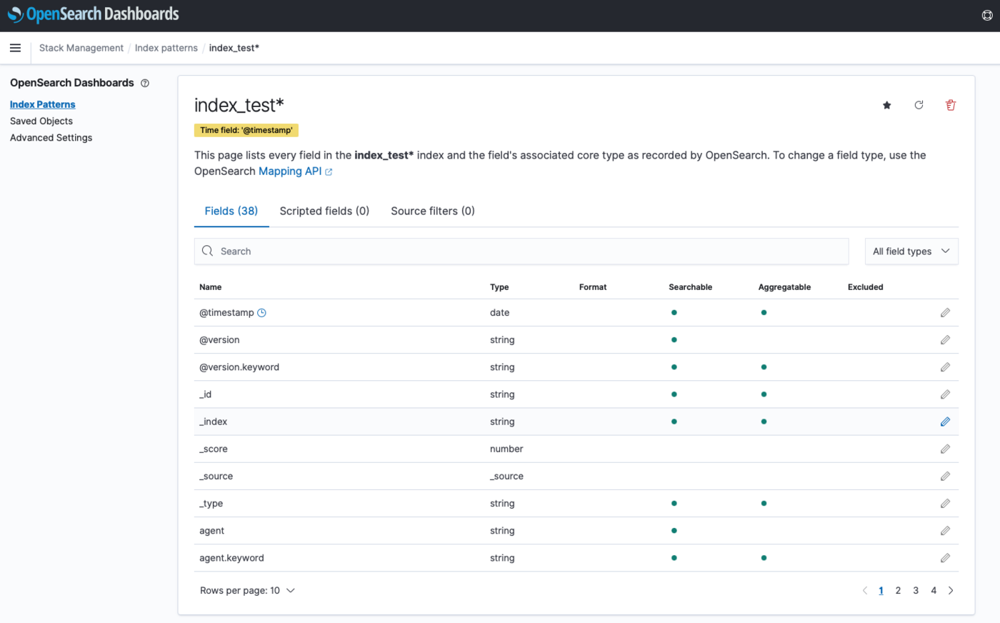

Create an index pattern
To aggregate all corresponding daily indices, we have to create an index pattern from the Stack Management menu:
Stack Management
To create the first index pattern:
First index pattern
As we want to consolidate all our daily indices, let define the pattern as index_test:
Index_test pattern

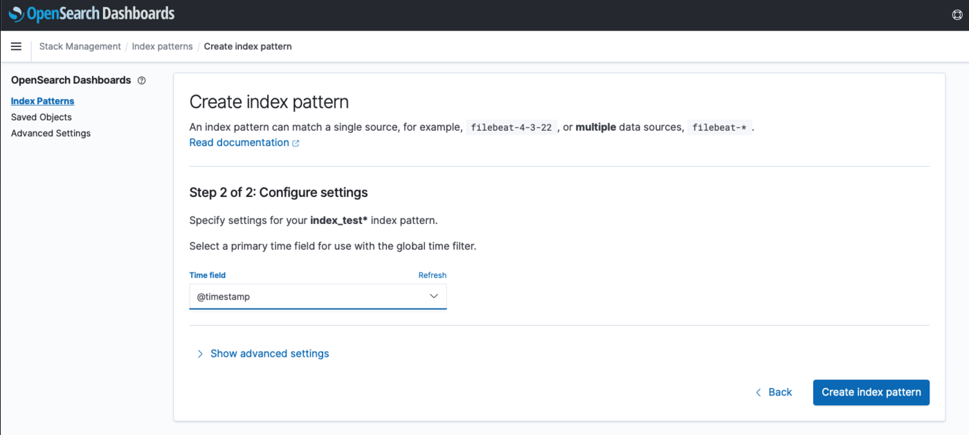

Then define the timestamp:
index_test timestamp
OpenSearch will then define all fields available and their type directly from stored documents in the index:
index_test ready

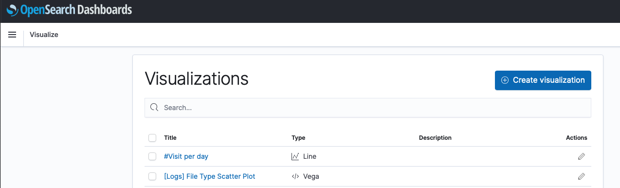

Create a new visualization
In the OpenSearch Dashboard / Visualize, create a new visualization:
index_test ready

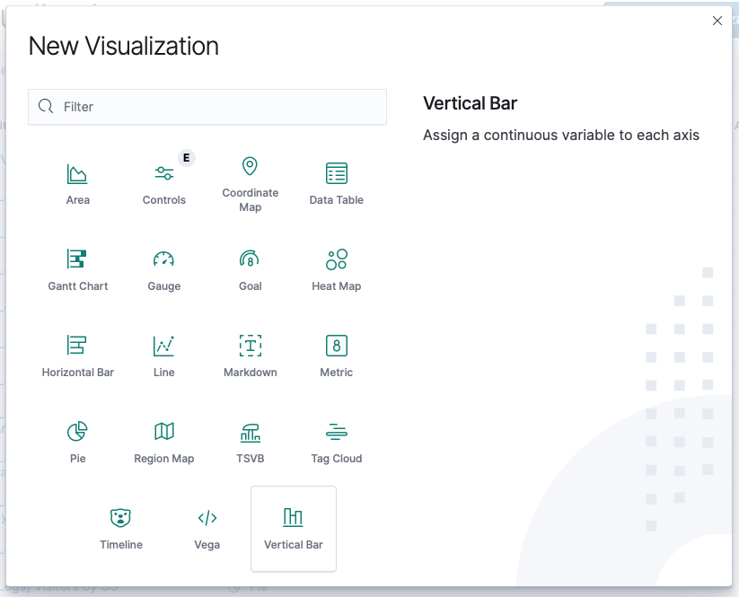

Select the visualization type:
index_test ready

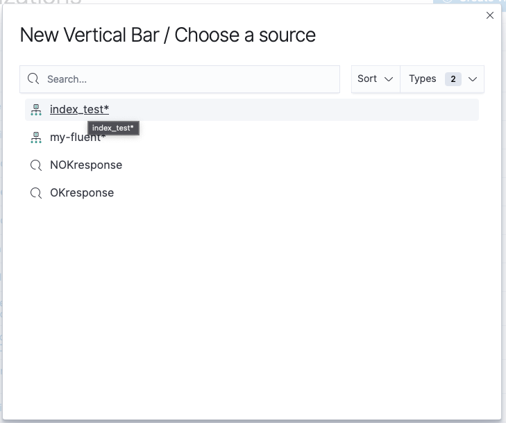

Then select the data source (the index pattern you just created):
index_test ready

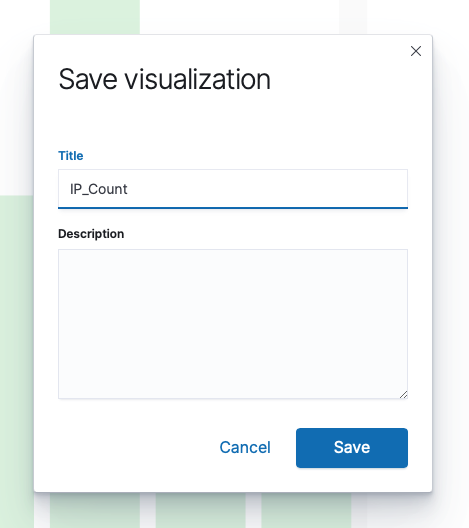

Save your visualization:
Save visualization

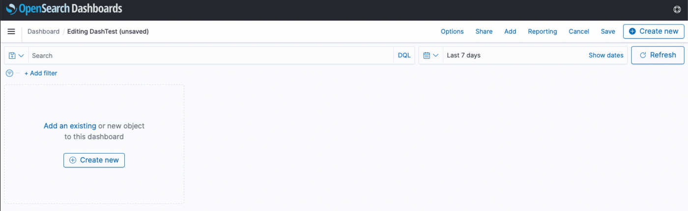

Let's make a dashboard with the visualization you've just saved.
Create a new dashboard :

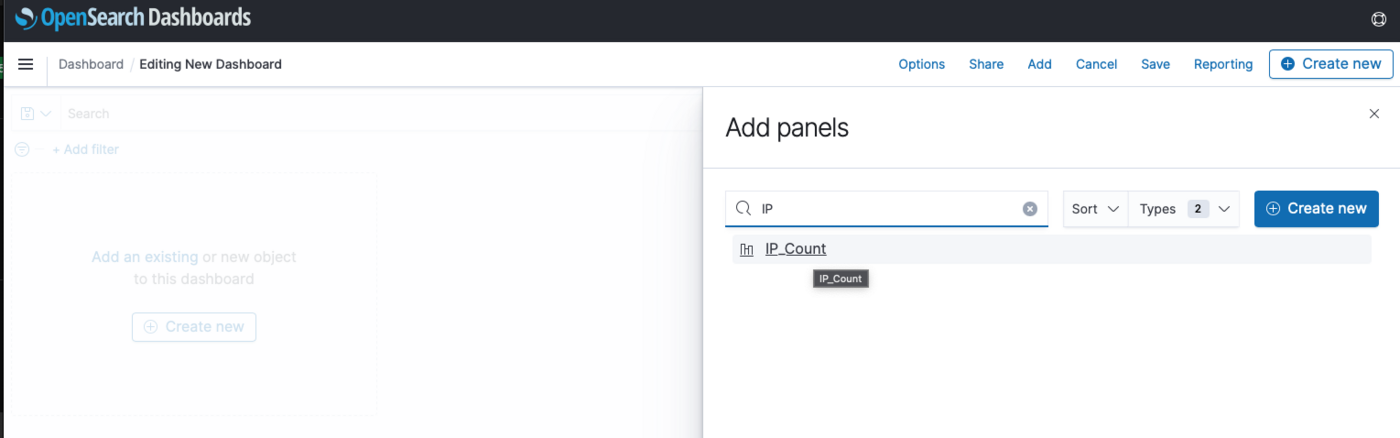

As we have already created a visualization, Add an existing object:
Search and select the one we just created:
Reuse the created visualization

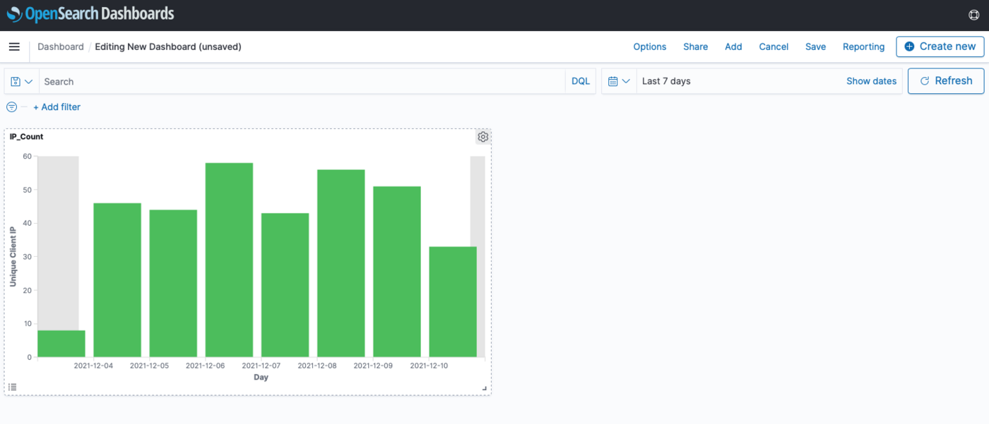

Reorganize your panels, add new or existing ones as wanted:
Dashboard saved
We now have a real time dashboard showing us the unique IP address per day, found in Apache logs.

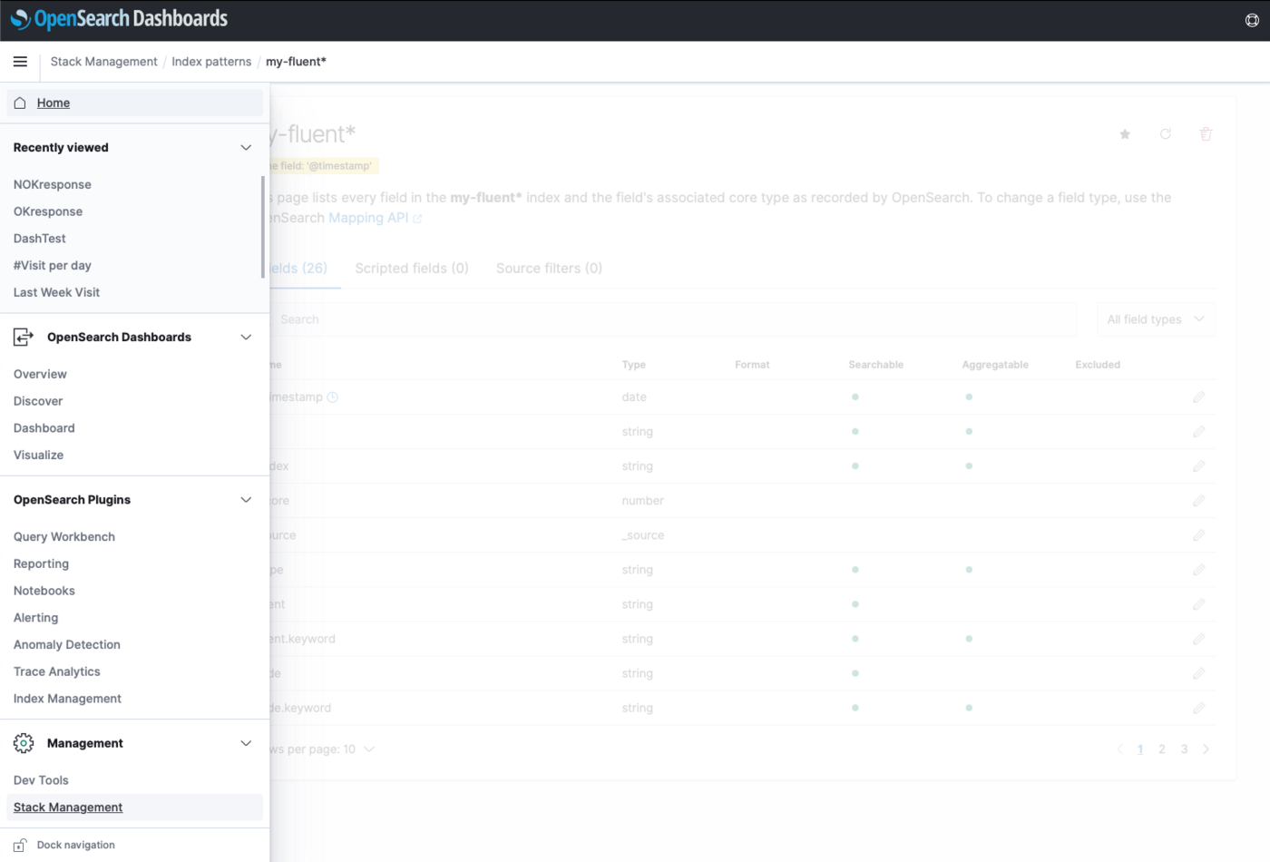

As we did for Logstash, you can create an index pattern to aggregate all the daily data logs stored in OpenSearch then visualize those data or create dashboards. In this example, the indices will be my-fluent-YYYY.MM.DD , so you can define a pattern like : my-fluent-*.
