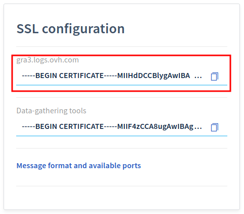

To configure NXLog, you will need to copy and store the LDP cluster certificate. You can find it in the Home page.
LDP certificate
Please put this file under the C:\Program Files(x86)\nxlog\cert folder.

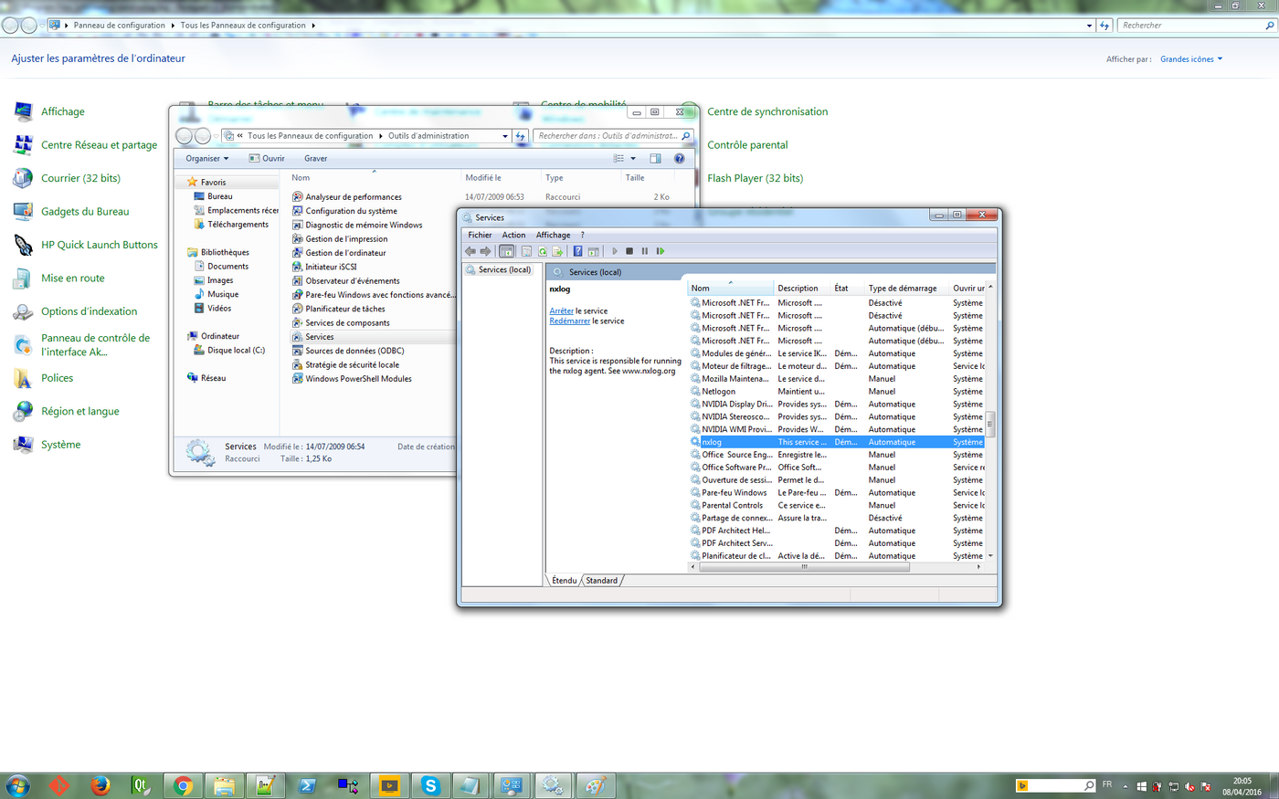

You have two ways to start NXLog. The first one is to launch the main Executable : C:\Program Files(x86)\nxlog\nxlog.exe. This is convenient when you are pretty sure that your configuration is correct. But if you want to be able to start, stop or restart the nxlog service, It would be better to use the Windows Service Manager. This Manager is located deep in the Configuration Panel of Windows.
Go to Control Panel, then locate Administrative Tools and then double-click on Services to display the manager. In this menu you should find the service nxlog in the list. There is a start, stop and restart action available in the contextual menu (Right-click on it).
Excuse my French screenshot detailing where to find it:
Restart Screenshot

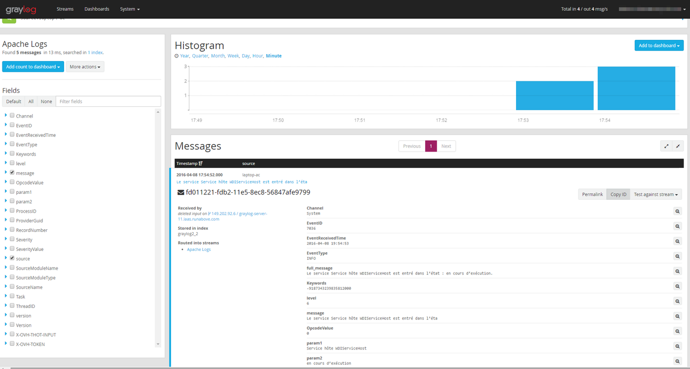

Jump to Graylog (use the Graylog access button in the Manager) and to the stream associated to your token to display your logs. As you can see, The Event Log format of windows is already structured and allows you immediately to analyze your services and processes.
Graylog Screenshot
