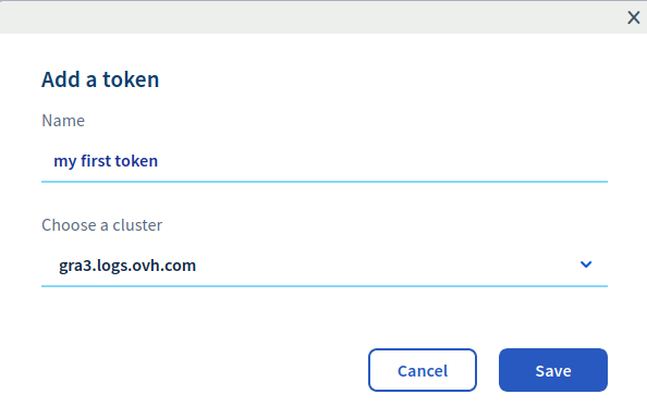

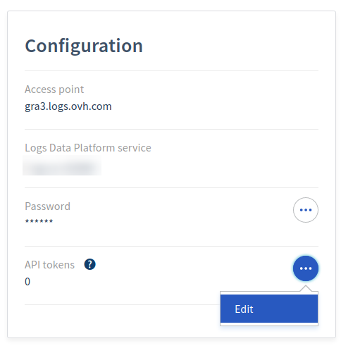

Once you have logged into Logs Data Platform you will have access to the token generation function from the Configuration panel.
Token Menu
On this page you will have the possibility to create a token and to remove them. Note that you cannot modify a token.
token generation
Once the token is created, you can use its value or remove it:
token generated
