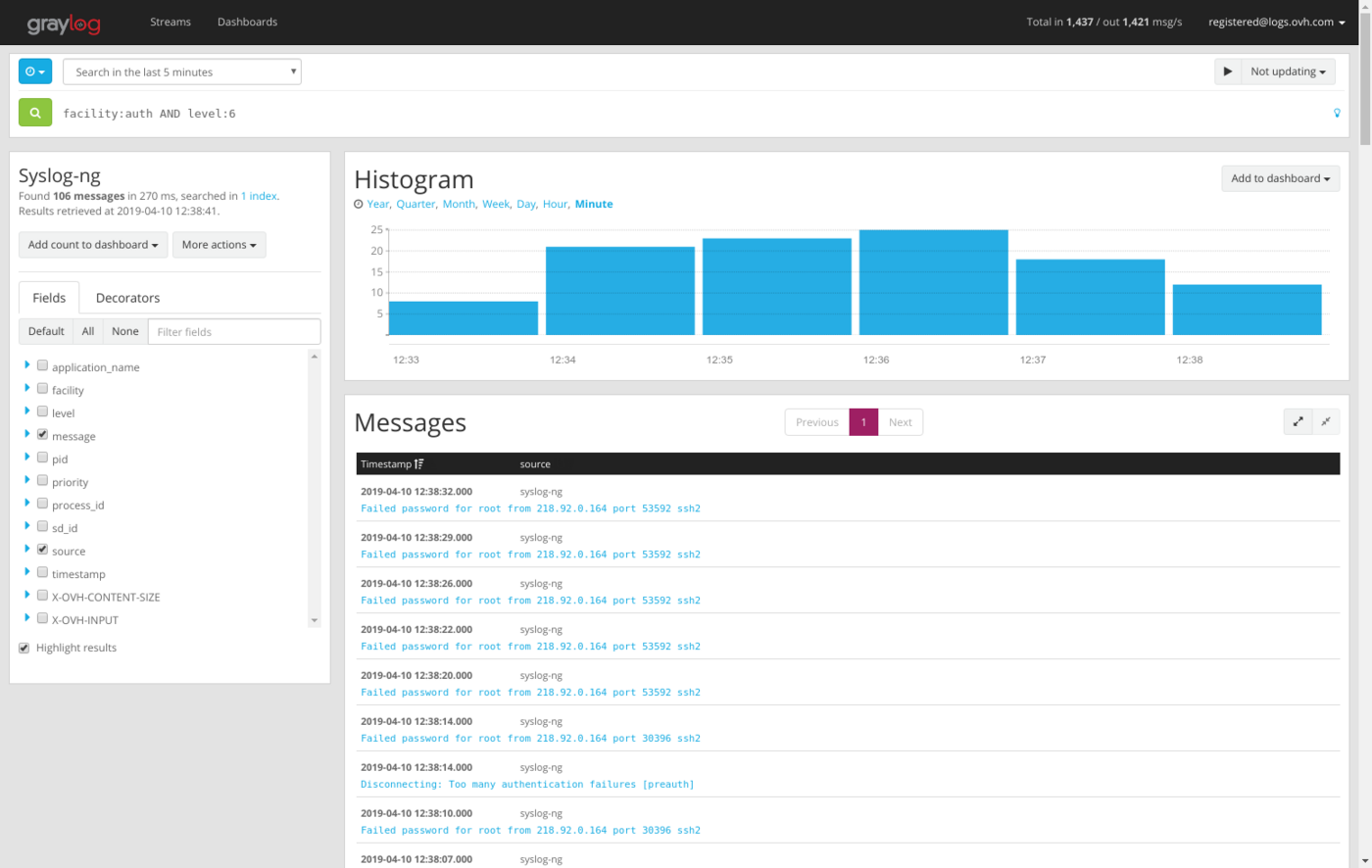

  • Once in Graylog, Go in Stream Tab, click on your stream. In the top-left corner, chose a 1 Day range and click on the green button to search.
  • You should have some results like this:
Graylog search view
  • On the top right corner of the histogram, click on Add to dashboard.

The best feature is the ability to mix criteria, based on what is important to you. For example, facility:auth AND level:6. Why not create an alert on this condition?
