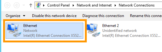

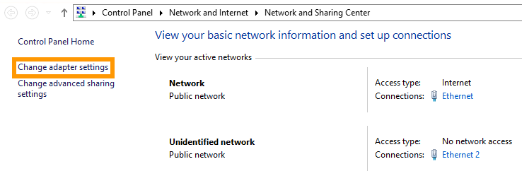

Step 2: Open your server's network configuration
First, right-click on the network icon in the notification area to go to the Network and Sharing Center.
Click Change adapter settings.
Right-click your network adapter, then click Properties.
Network Adapter Properties
