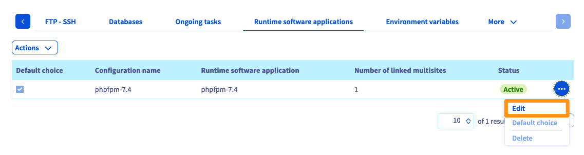

To access the runtime software applications for your Cloud Web hosting plan, click on the tabs below to view each of the 3 steps.
Go to the Hosting plans page, then select the Cloud Web hosting plan concerned.
Web hosting
Click on the Runtime software applications tab. When you set up your hosting plan, a runtime software application is created automatically. It is listed as Default choice in the table that appears.
To modify a runtime software that has already been set, click on the ... button to the right, then Modify.
If you have the Cloud Web offer with 2 vCores, you can add a second runtime environment (maximum 2 per plan) by clicking on the Actions button, then on Add a runtime software application.
Once you have done this, please ensure that you have the runtime software application (or applications) required for your project before you continue.

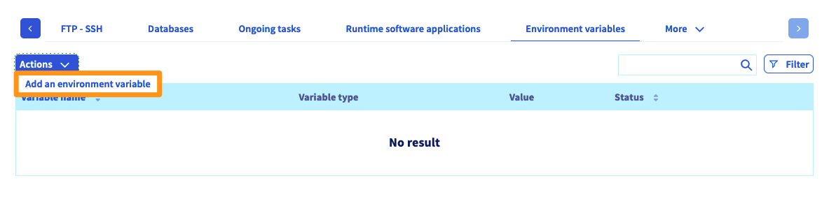

3 - Create environment variables (optional)
If you would like to deploy your project several times in different environments (e.g. development, test and production), you will need to provide variables in order for your code to run properly. To do this, Cloud Web prompts you to define environment variables that can be accessed by the code for your website or web application.
For example, this way you can leave out the .env file in the PHP Laravel framework, as described in this guide: https://laravel.com/docs/master/configuration.
To add an environment variable, click on the tabs below to view each of the 3 steps.
Web hosting
Click on the Environment variables tab. A table will display the environment variables created for your solution.
To add a new one, click on the Actions button, then Add an environment variable. Follow the appropriate instructions for the variable you would like to create.
Adding an environment variable on a Cloud Web hosting
If you do not use a development framework that includes the environment variables, or would simply like to check that your variables are working properly, you can create a script to do this. Below are examples of two scripts that can help you with this process, although they are no substitute for the assistance of a webmaster:
  • for PHP:
<?php echo "ENV: " . $_ENV['DB_DATABASE']; ?>
  • for Node.js:
var http = require('http');
http.createServer(function(request, response) {
    response.writeHeader(200, {"Content-Type": "text/html"});
    response.write( process.env.DB_DATABASE);
    response.end();
}).listen(80);
Make sure you replace the generic information included in these scripts (e.g. DB_DATABASE) with the environment variable concerned.

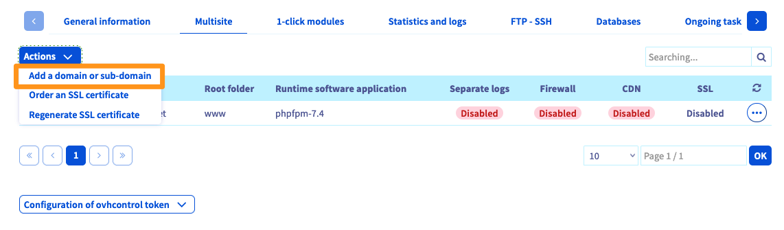

4 - Configure additional domains as multisites (optional)
Now that the technical environment of your Cloud Web hosting plan is ready, you can configure additional domain names on it as multisites. This way, you can partition your space in order to host several websites on it, for example. If you would like to do this for your project, click on the tabs below to view each of the 3 steps.
Web hosting
Click on the Multisite tab. The table displayed will contain all of the domain names that have been added to your hosting plan. Some of these will have been created automatically, when your hosting plan was set up.
To add a new one, click on the Add a domain or sub-domain button, and follow the instructions that appear. The method may be different, depending on whether the domain name concerned is registered with OVHcloud.
We strongly advise taking special care when you enter the following information:
  • Root directory: the directory where the domain name entered must be hosted on the storage space for your Cloud Web hosting plan.
  • Runtime software application: the runtime software application previously set, which will be used by the multisite you are currently configuring.
If you have added a domain name that is considered to be external, you will need to add a TXT record called ovhcontrol to its DNS configuration. This way, OVHcloud can ensure that the domain addition is approved. If you skip this step, your domain will not be added.
Repeat this step if you would like to add several domain names to your Cloud Web hosting plan. For more information on adding a domain name as a multisite, please read the following guide: Hosting multiple websites on your Web Hosting plan.

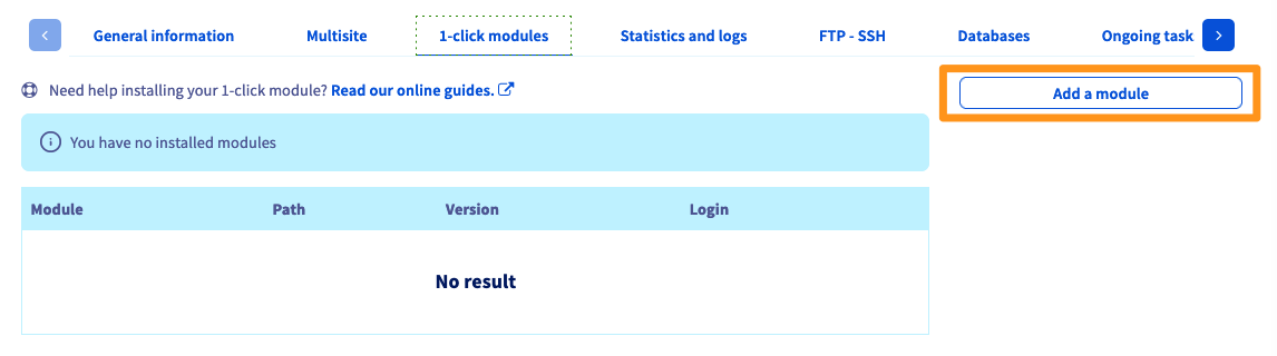

1. Use our 1-click modules
By using our 1-click modules, you will get a ready-to-use website template that you can customise with a variety of themes, texts, and much more. OVHcloud offers four structures with its 1-click modules. You can find out more about them by browsing our webpage on Creating a website with 1-click modules.
If your choice of method involves using our 1-click modules, click on the tabs below to view each of the 3 steps.
Web hosting
Click on the 1-click modules tab, then click Add a module.
You can then choose whether to install it in 'basic' mode (non-customisable), or 'advanced' mode (customisable).
If you need more information on OVHcloud 1-click modules, please read our guide: Setting up your website with 1-click modules.
In order to use these modules, you must use the PHP runtime software application.
