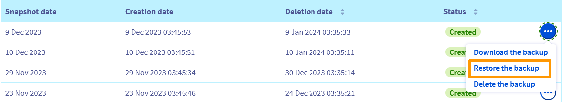

All available backups for the database you have selected will now be diplayed. You can view the exact date of each backup, and the date on which they will be deleted from the OVHcloud tool.
Click on the three dots to the right of the backup that you would like to restore, then on Restore the backup. In the popup window, check that the information is correct, then click Confirm. Then wait for the restore process to complete.

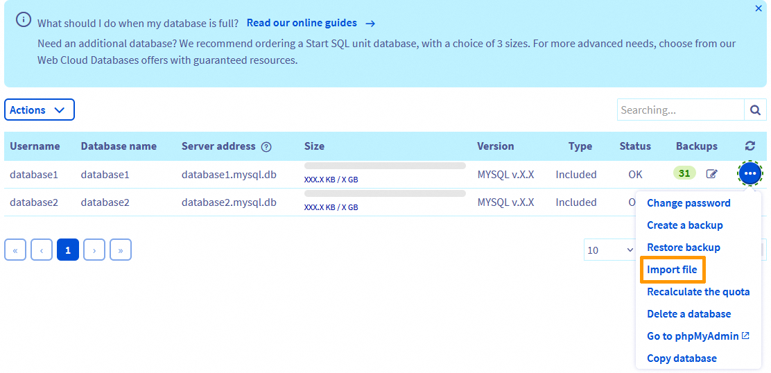

The table shown contains all the databases created as part of your Web Hosting plan. You can now click on the three dots to the right of the database you want to import data into, then on Import file.

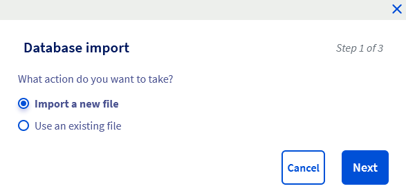

On the window that opens, select Import a new file, then click Next.
By clicking the Use an existing file button, you can reimport data from a file you have already sent to the import tool.

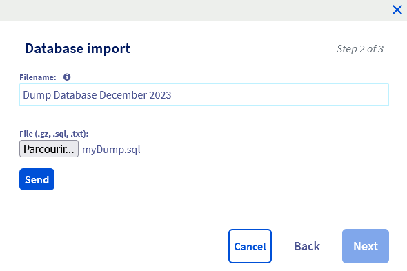

Enter a filename (which you can use to identify this backup at a later date, if you wish to restore it again), then next to File, select the database backup file on your computer. Click on Send.
Wait until the interface confirms that the file has been sent successfully, then click Next.

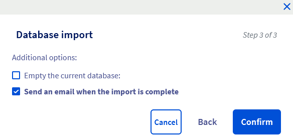

Finally, you can choose whether or not to apply the additional options displayed:
  • Empty the current database. By ticking this box, the content currently stored in the database will be completely deleted, then replaced by your backup. If (and only if) you wish to replace the current contents of the database with the contents of the backup file, we recommend ticking this box.
  • Send an email when the import is complete. By ticking this box, you will be sent an email notification when the database import is complete.
Once you have made your choice, click the Confirm button, and wait for the import process to finish.
