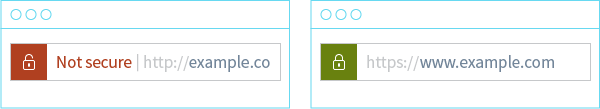

When you visit a website with a secure connection, your web browser will show this in its address bar (URL) in several ways, such as:
- A logo (usually a padlock)
- A message
- A color code
- The protocol used, HTTPS rather than HTTP
These indicators help to determine whether your website has a secure connection or not.

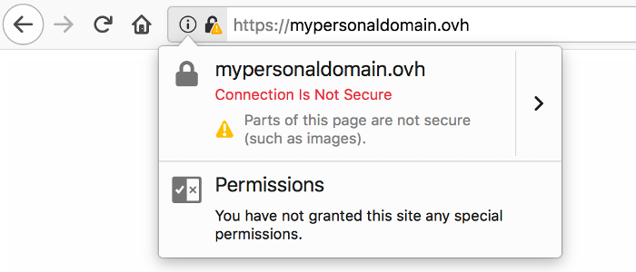

There are two possible scenarios for Mixed Content:
The website will display correctly, but a warning will appear in the address bar: Passive content (images, videos, etc.) uploaded to your page by your web browser from an unsecured source.
Some parts of the website are not displayed and a warning is present in the address bar: Content considered active by your web browser (scripts, iframes, CSS files, etc.) from an unsecured source has been blocked.
Make sure that all content loaded from your website comes from a secure source.
