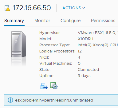

After the hosts have been updated, the following alert message will appear in your host summary:

After the ESXi hosts have been updated, the patch has not yet been applied.

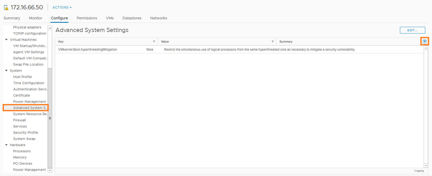

Once you have read about these problems, you can enable the setting that is used to disable hyper-threading, by going to the Advanced System Settings.
A filter is available in the top right-hand corner of the window.
You will need to do this for each host.
To find out more, you can go to step 3 in the ‘Resolution’ section of this VMware knowledge base.
