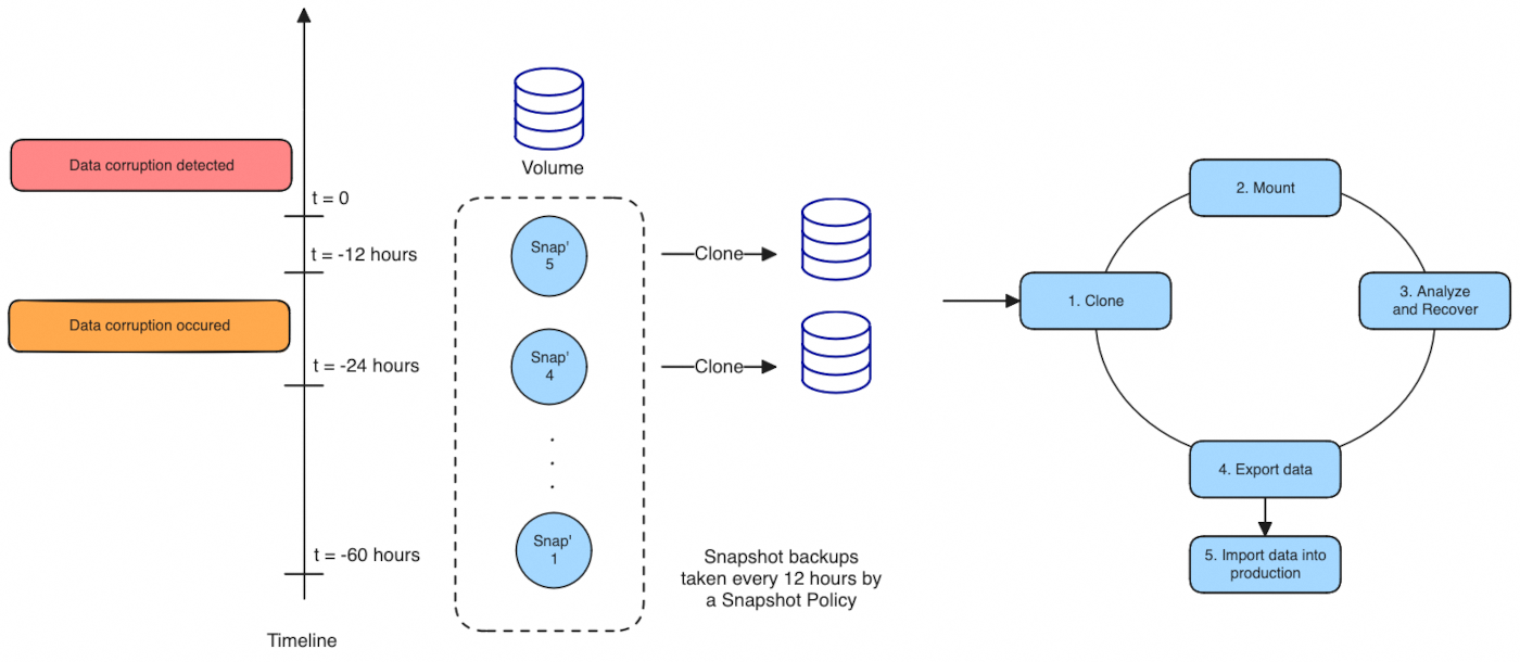

Address and remedy logical data corruption
Logical data corruptions can be caused by software errors, human errors or malicious activity.
Unfortunately, logical data corruptions often cannot be addressed with standard high-availability and disaster recovery solutions. By creating Snapshots at a regular interval using a Snapshot Policy and with the help of the volume clone feature it is possible to restore the system to a point in time before the corruption occurred.
It is also possible to isolate the corrupted data and try to resolve the cause of the corruption by analysing the problem in a separate system.
CloneVolumeUseCaseDataCorruption

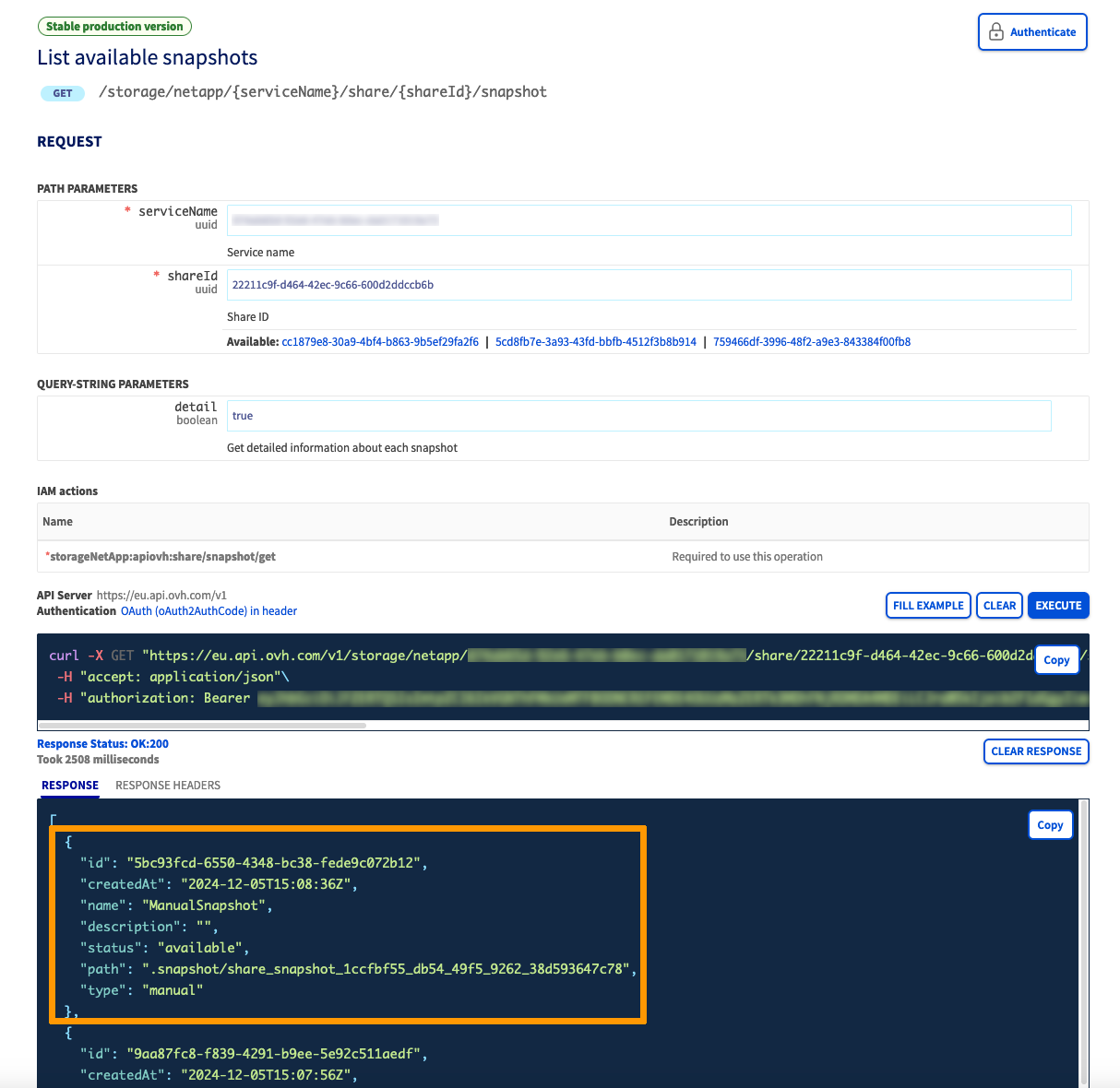

1. Identify the id of the snapshot that will be used with the following API call:
Parameters:
  • serviceName: is the service unique ID
  • shareId: is the share to clone from
CloneVolume

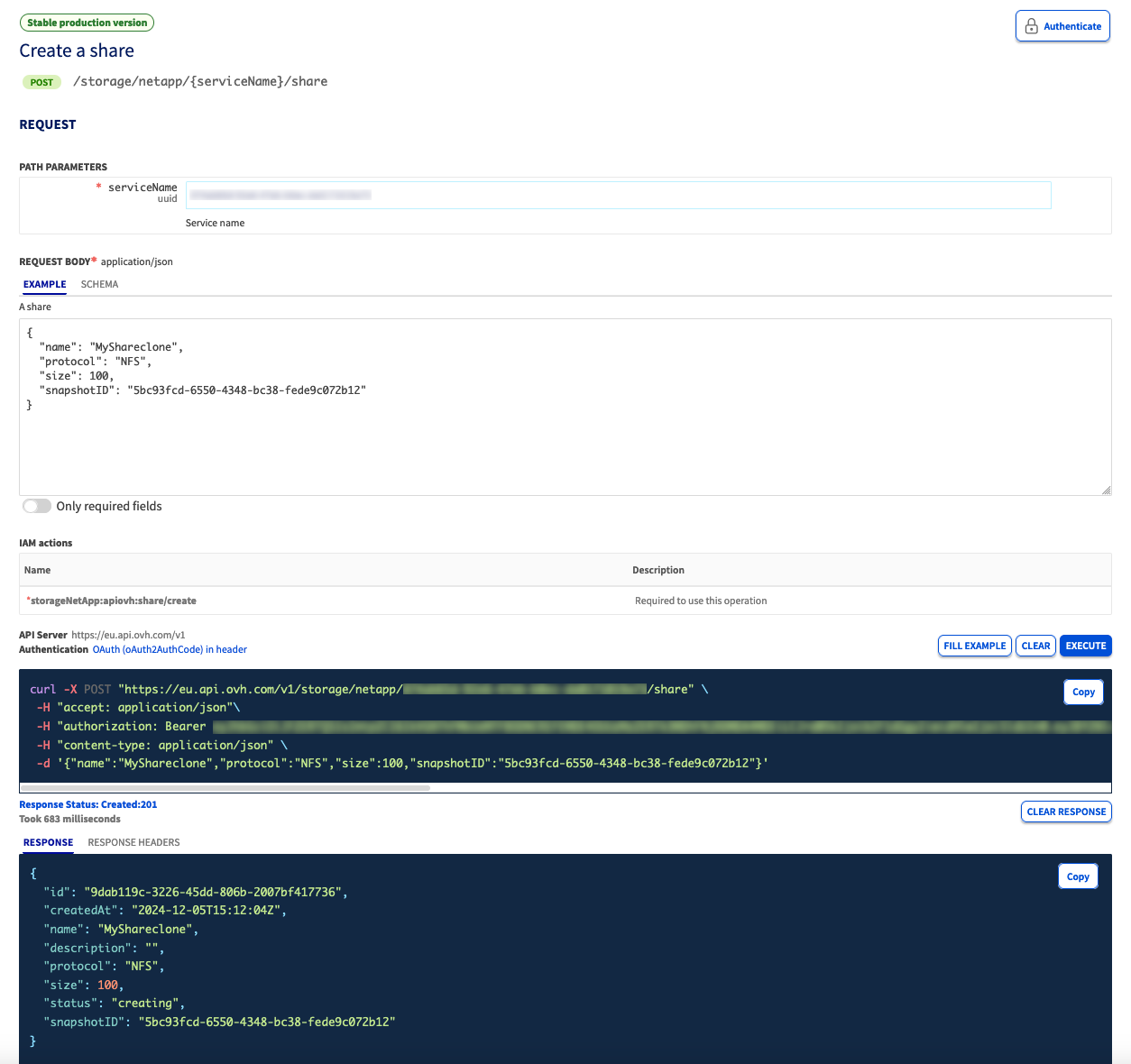

2. Clone the volume from the snapshot by using the /share API route:
Parameters:
  • size: is the share size. It should be equal or greater than the snapshot size.
  • protocol: is the share protocol. Only NFS is allowed.
  • snapshotID: is the snapshot ID to use when creating the share
  • name: (Optional) is the share name
  • description: (Optional) is the share description
CloneVolume
The OVHcloud API will return an HTTP 201 (Created) code along with volume information.
The volume status will be set to creating_from_snapshot and then will change to available once the volume creation is complete.
Depending on the snapshot size, the volume creation may take some time.
