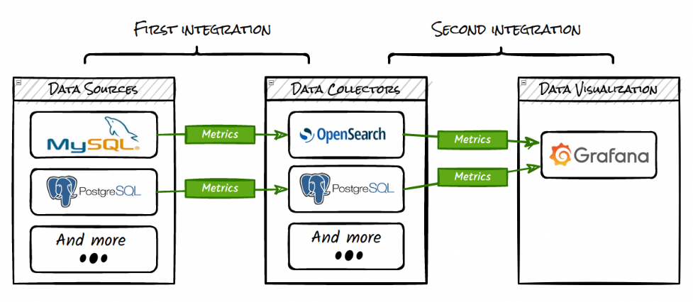

Concept
The Cross Service Integrations for Logs and Metrics allow you for example:
  • To send Valkey or MySQL metrics in PostgreSQL.
  • To send PostgreSQL or MySQL metrics to OpenSearch.
  • To show metrics in Dashboards service.
For that you need:
  • A source service
  • A destination service

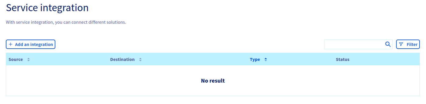

Click on Databases in the left-hand navigation bar, select your engine instance and open the Service integration tab.
Click on Add an integration:
Service integration

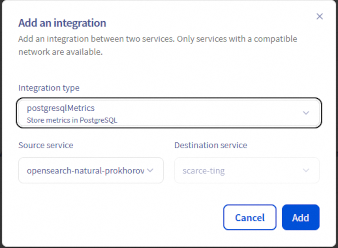

Define the Integration type and the Destination service:
First create a Public Cloud Database for your Destination service via your Control Panel or API.
Create integration

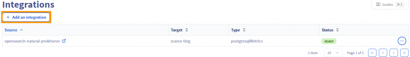

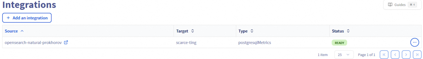

Your first integration is ready:
Result

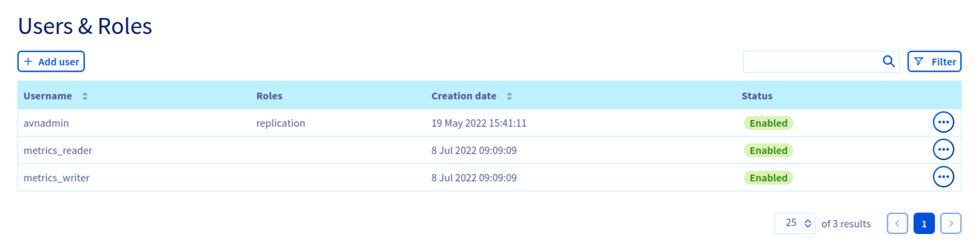

Note that this integration creation may have created two users, respectively: metrics_reader and metrics_writer in your engine instance.
Users & Roles
Don't delete them.

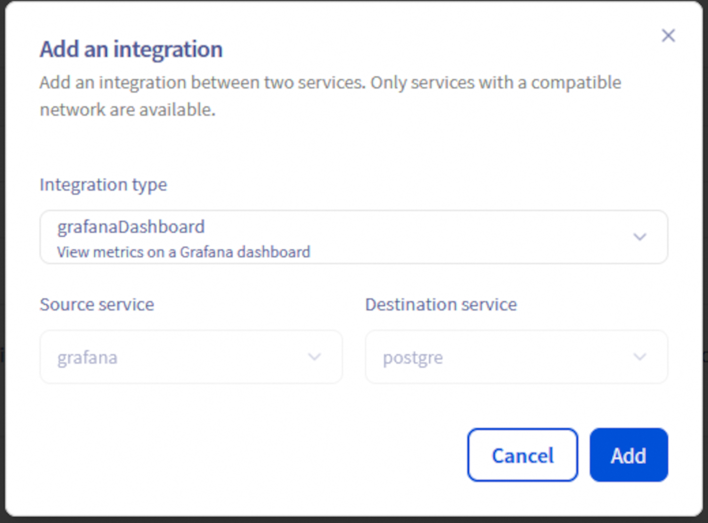

Allow metrics visualization into Dashboards service
Go to the Service integration tab of your Destination service service and click on Add an integration
Service integration
As you can see, the first integration is referenced.
Define grafanaDashboard as Integration type and the Source service:
Create integration

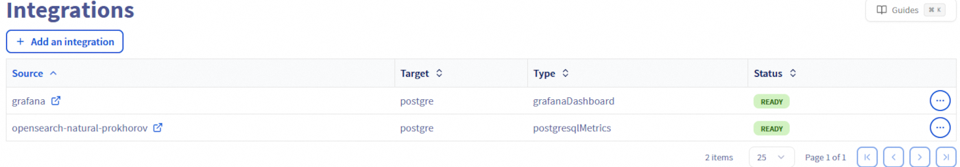

Your second integration is ready:
Result

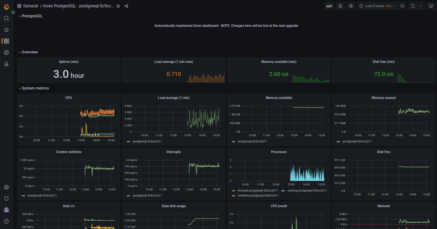

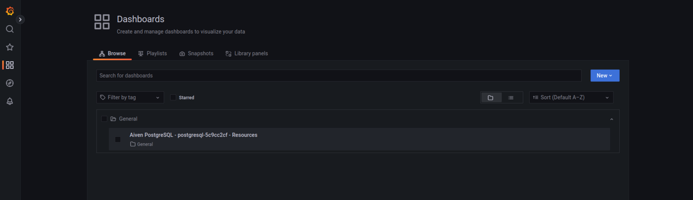

Connect to your Dashboards instance and browse the dashboards:
Browse Dashboards
Then open your new dashboard:
PostgreSQL Dashboard

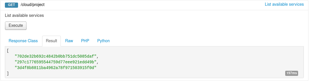

Get the desired service ID
Execute the following API call:
serviceName
From the resulting list, select and copy the service identifier corresponding to the desired service, also known as serviceName.

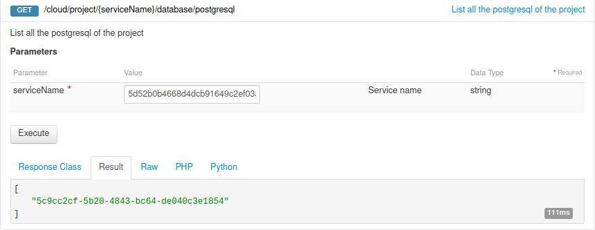

Get the desired cluster ID
Open the following API call, paste your service ID into the serviceName input field and click Execute:
Cluster ID

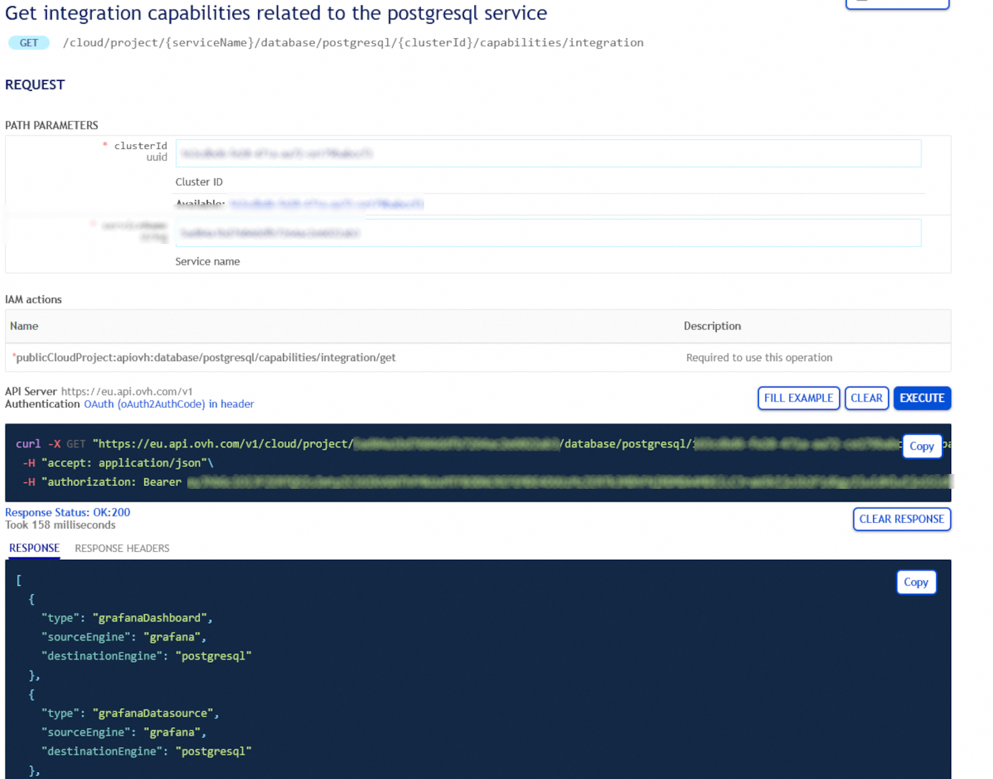

Get integration capabilities
Get integration capabilities related to your Public Cloud Databases service:
Get Integration Capabilities

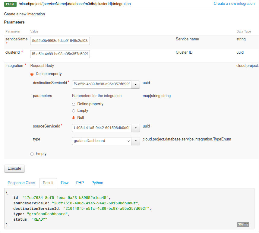

The destionationServiceId and the sourceServiceId correspond to the destination cluster ID and to the source cluster ID.

Once done, get the GrafanaDashboard integration capability related to the destination service:
Get Dashboards integration capabilitie
Then create a second integration from your Destination service name:
Create Dashboards Integration
Browse Dashboards
