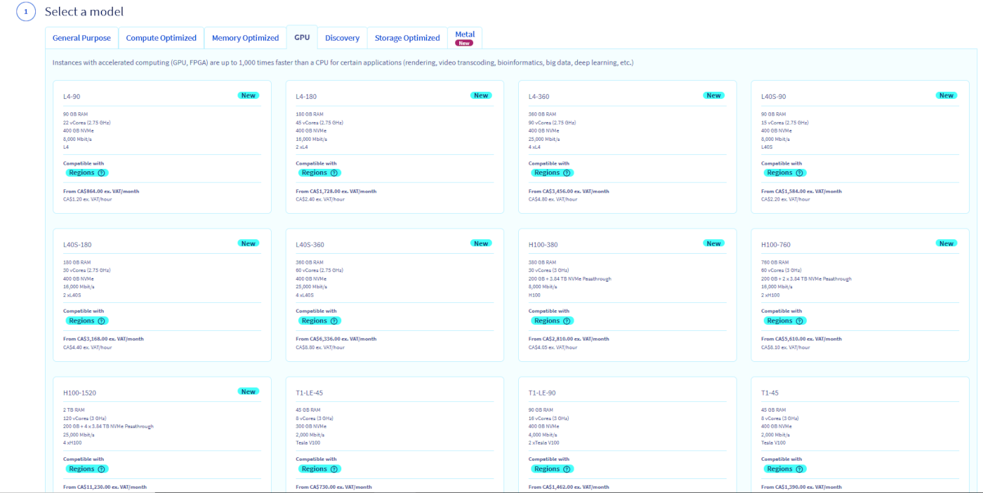

Click on Instances in the left-hand menu under the Compute tab. Next, click on Create an instance and choose a compatible GPU instance:
public-cloud
Next, follow the remaining steps as detailed in this guide. This process may take a few minutes.

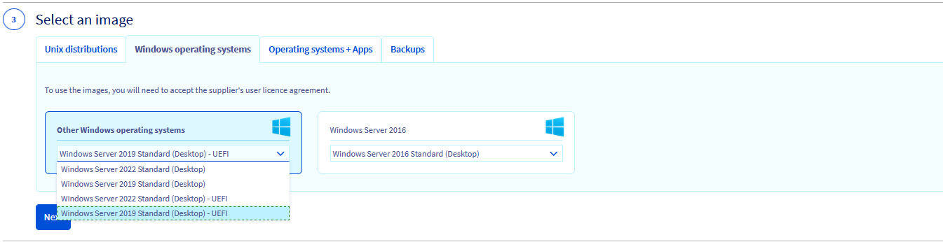

In the next step, go to the Windows operating systems tab and click ont the drop-down arrow to select the compatible Windows image:
public-cloud

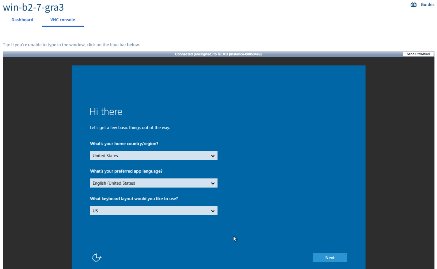

After the instance has been created, the Windows installation needs to be finalised (sysprep). To achieve this, click on ... and then on Instance details. Switch to the tab VNC console. The console should already display the post-installation interface.
windows sysprep
In the first step, decide on your localisation settings by selecting a region, a language and a keyboard layout. Click on Next to proceed.

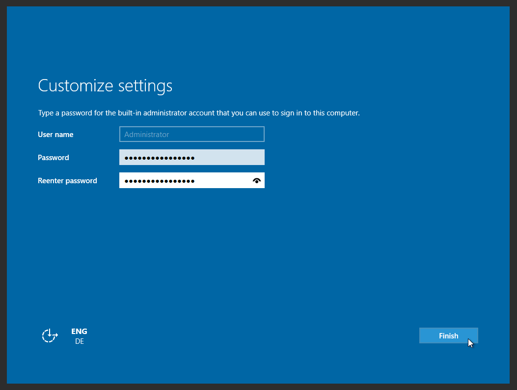

The second step requires to set up the default "Administrator" account. Enter your passphrase twice and click on Finish to complete the installation process. Use the eye symbol to check if all the characters entered into the fields match the actual layout of your keyboard.
The instance will reboot and you will be able to log in with these credentials using a remote desktop client.

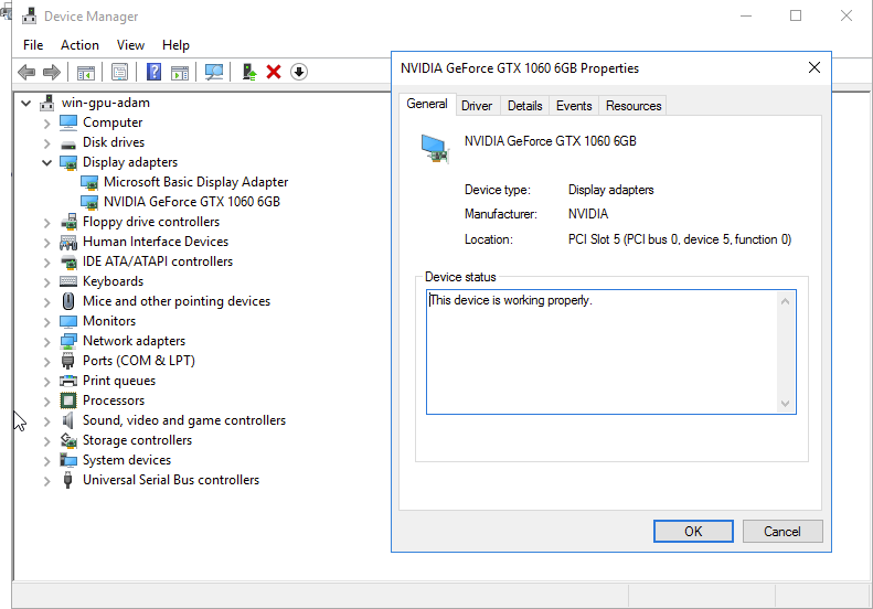

Once you have connected to your instance, you will need to install the NVIDIA driver from the official website.
Afterwards, all that’s left to do is to install the required driver, which will then be displayed here:
public-cloud
public-cloud
