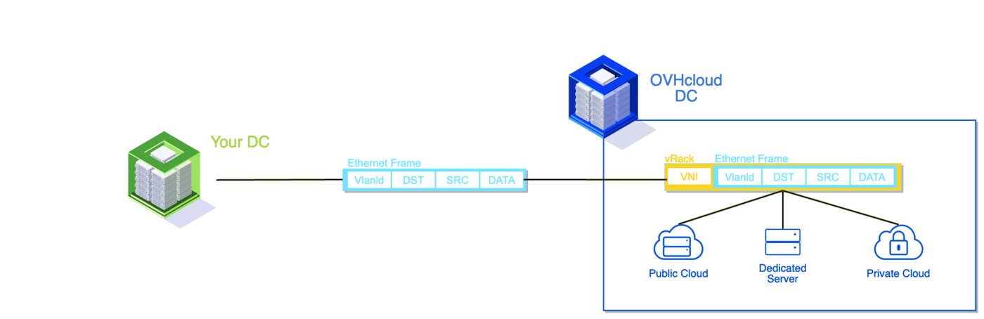

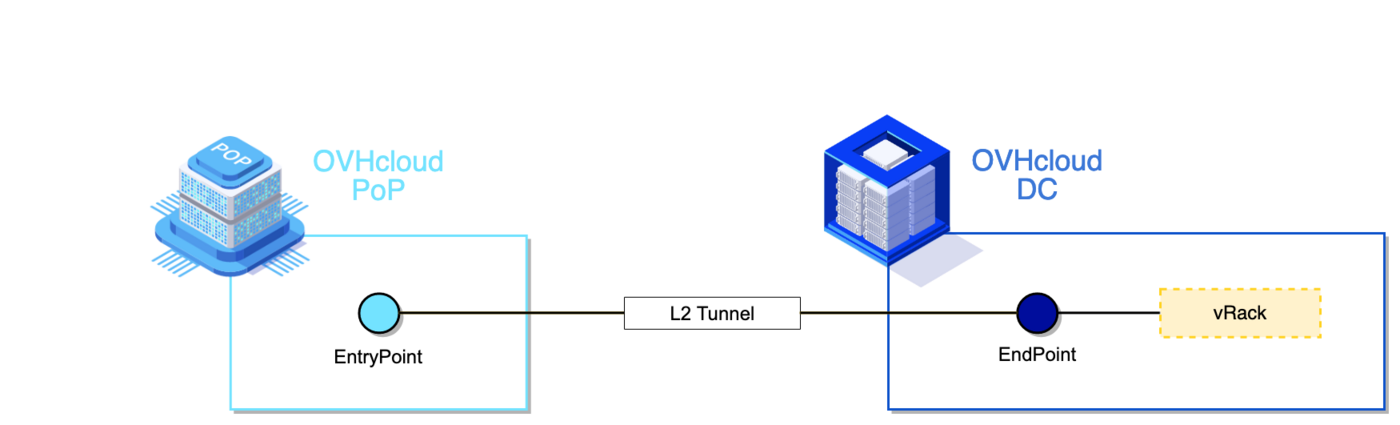

The L2 tunnel is forwarded directly to/from the vRack, so all L2 traffic is forwarded to/from the customer inter-connection.
L2 traffic refers to Ethernet frames, with an 802.1q header, if applicable:
  • Ethernet broadcast is forwarded.
  • Unknown Ethernet unicast is forwarded.
  • Multicast is forwarded (considered broadcast, limited to 20pps).
  • Specific point-to-point Ethernet frames (like LLDP or LACP) are not forwarded

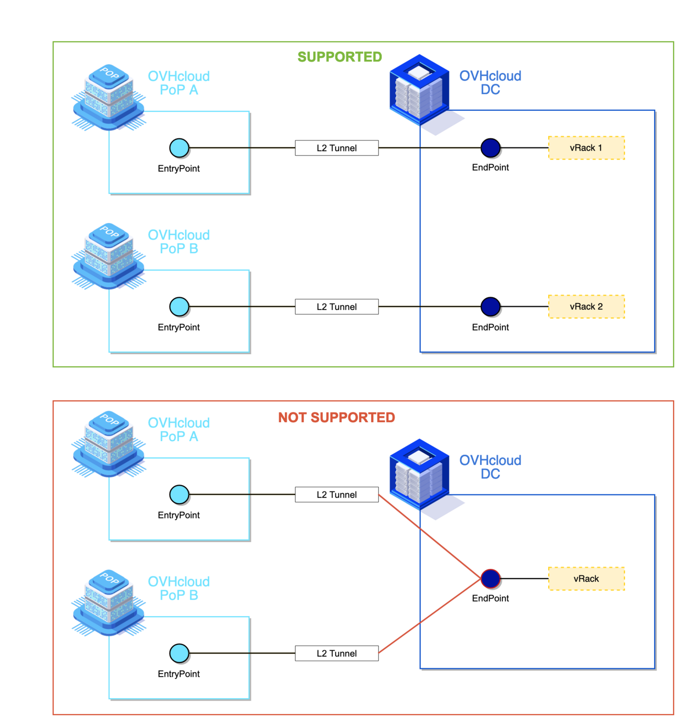

Only one OVHcloud Connect L2 is supported per vRack: each PoP/EntryPoint can only be associated with one DC/EndPoint.

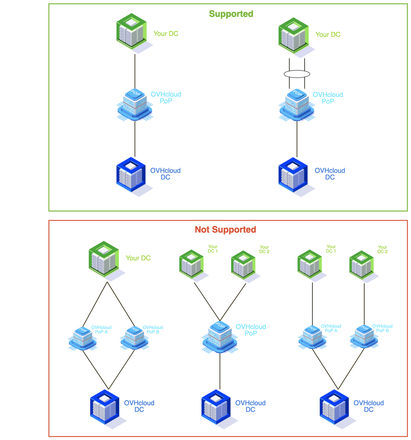

Supported and unsupported L2 Design
With L2 mode, redundancy cannot be exploited between two PoP/EntryPoint. The only solution is to use a LAG on a PoP/EntryPoint.

L2 operates at the Ethernet level. The customer's vRack is extended "as-is" from OVHcloud and forwarded to the customer link. Transparent to VLANs, this mode is the best way to inter-connect the customer's legacy network with an OVHcloud vRack.

The L2 mode is limited to a point-to-point topology: a backup link through a second PoP is not supported.
L2 Topologies
LACP is mandatory for aggregation when 2 links are configured with PoP.

Connections between a PoP and a DC benefit from the OVHcloud backbone. An internal link failure is therefore supported and will not impact customer traffic.
