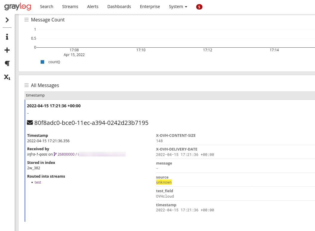

The OpenSearch endpoint is a dedicated index where you can send a JSON document. The port used is the 9200, the same HTTP port used for all other OpenSearch APIs of Logs Data Platform. The request must include the X‑OVH‑TOKEN field, which is a token used by the logging pipeline, and any additional custom fields. Authentication for the endpoint is performed via basic username/password (or a legacy token) for non‑IAM users, or via an IAM Bearer token when IAM is enabled. Don't hesitate to go to the Quick Start documentation if you are not familiar with this notion. This document log will be transformed into a valid GELF log and any missing field will be filled automatically. In order to respect the GELF convention, you can also use all the GELF format reserved fields. Here is one example of the minimal message you can send:
$ curl -H 'Content-Type: application/json' -u '<user>:<password>' -XPOST https://<ldp-cluster>.logs.ovh.com:9200/ldp-logs/_doc -d '{ "X-OVH-TOKEN" : "7f00cc33-1a7a-4464-830f-91be90dcc880" , "test_field" : "OVHcloud"}'
or with IAM enabled
$ curl -H 'Content-Type: application/json' --oauth2-bearer '<YOUR_IAM_TOKEN>' -XPOST https://<ldp-cluster>.logs.ovh.com:9200/ldp-logs/_doc -d '{ "X-OVH-TOKEN" : "7f00cc33-1a7a-4464-830f-91be90dcc880" , "test_field" : "OVHcloud"}'
Replace the <user>, <password> and <ldp-cluster> with your Logs Data Platform username, password and cluster. You can also use tokens in place of your credentials. Sending this payload will result in this log:
simple_log
The system automatically set the timestamp at the date when the log was received and added the field test_field to the log message. Source was set to unknown and the message to -. Note that the payload follows the JSON specification (and not the GELF one). The system will still recognize any reserved field used by the GELF specification. Here is another example:

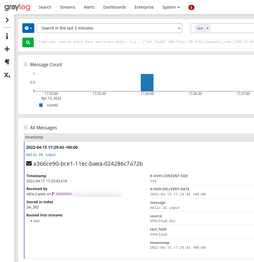

$ curl -H 'Content-Type: application/json' -u '<user>:<password>' -XPOST https://<ldp-cluster>.logs.ovh.com:9200/ldp-logs/_doc -d '{ "X-OVH-TOKEN" : "7f00cc33-1a7a-4464-830f-91be90dcc880" , "test_field" : "OVHcloud" , "short_message" : "Hello OS input", "host" : "OVHcloud_doc" }'
This will create the following log:
gelf_log
The system used the reserved fields associated with GELF to create the message and the source fields.

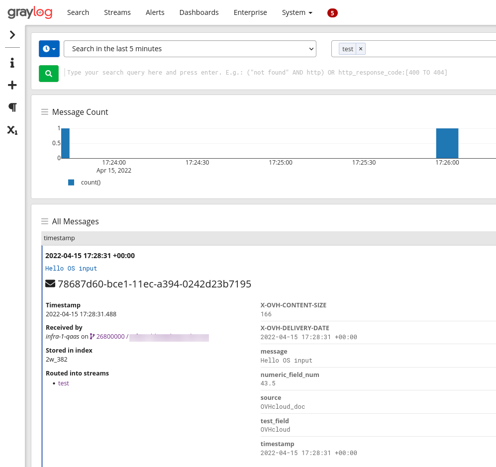

Logs Data Platform will also detect any typed field in the original data and convert them accordingly to our field naming convention. This last example illustrates it:
$ curl -H 'Content-Type: application/json' -u '<user>:<password>' -XPOST https://<ldp-cluster>.logs.ovh.com:9200/ldp-logs/_doc -d '{ "X-OVH-TOKEN" : "7f00cc33-1a7a-4464-830f-91be90dcc880" , "test_field" : "OVHcloud" , "short_message" : "Hello OS input", "host" : "OVHcloud_doc", "numeric_field" : 43.5  }'
The numeric field numeric_field will be detected as a number and will be suffixed to follow our naming conventions.
gelf_convention

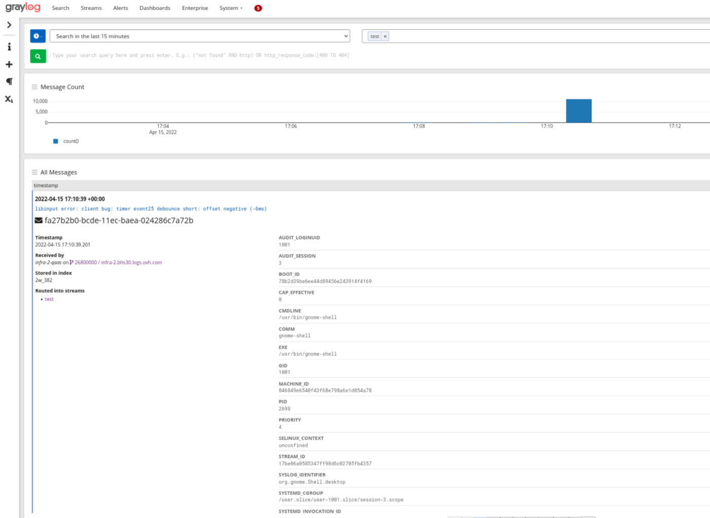

Once configured and launched you will immediately see this type of logs in Graylog:
vector_logs
The logs from journald arrived fully parsed and ready to be explored. Use different sources and transforms to send your application logs to Logs Data Platform.
