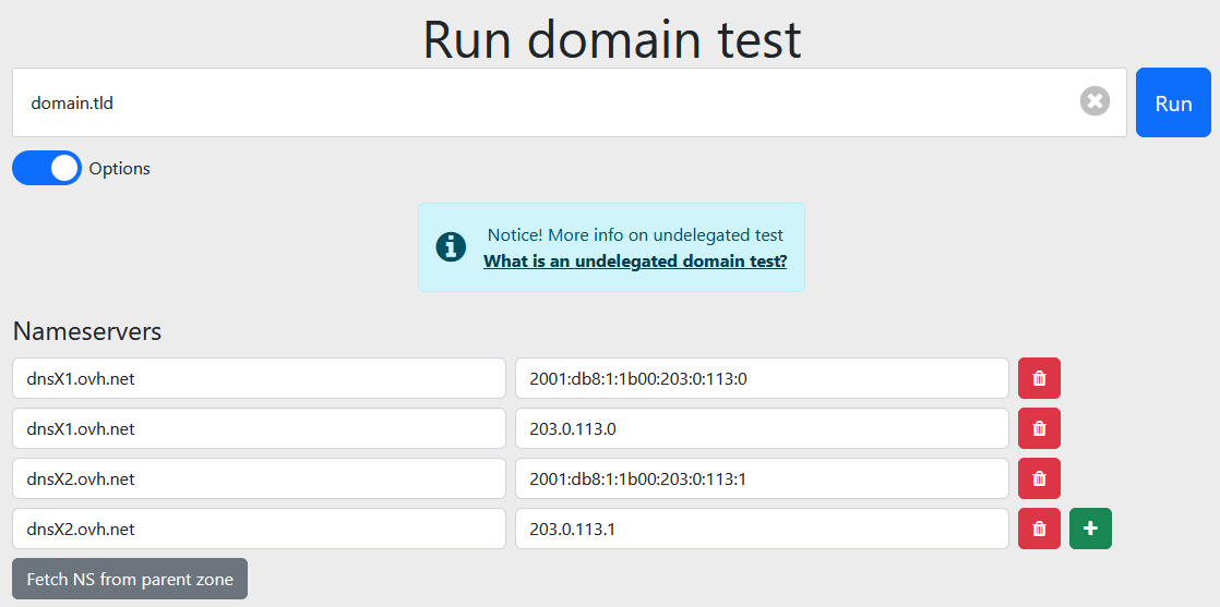

2 - Retrieving the DNS servers currently used by your domain name
You can retrieve the DNS servers currently used by your domain name using the online DNS tool Zonemaster.
To do this, go to https://zonemaster.net, enter your domain name without www (domain.tld), then tick the Options button located just below the domain name entry form.
In the available options, click on the button Fetch NS from parent zone.
A result is displayed:
glue-zonemaster
Retrieve the DNS servers information including all their associated IPv4 addresses (in the form of X.X.X.X where X is a number between 0 and 255) and IPv6 (other addresses that are not IPv4). You will need them for the rest of this guide.
In our example shown above, the domain.tld domain currently uses the following DNS servers:
  • dnsX1.ovh.net associated with IPv4 203.0.113.0 and IPv6 2001:db8:1:1b00:203:0:113:0
  • dnsX2.ovh.net associated with IPv4 203.0.113.1 and IPv6 2001:db8:1:1b00:203:0:113:1
If you need more information, please read our tutorial on the Zonemaster tool.

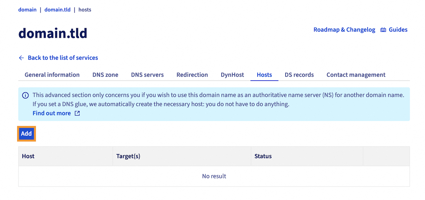

On the new page, click on the Hosts tab.
A table will display the hosts currently configured at OVHcloud for your domain name. To add a new host record, click the Add button.
glueregistry

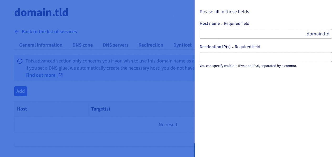

In the window that opens, enter the information requested:
InformationDetails
Host NameCustomise the host name you want to use as a custom DNS server.
Target IP(s)Specify all IP addresses (IPv4 and/or IPv6) to which the host name should resolve. These are IP addresses of the DNS server currently used by your domain name. If there are multiple IP addresses, separate them with commas.
glueregistry
In the image above, taking the example from step 2, the host you want to add here (from the domain name domain.tld) is dns1.domain.tld.
For this host, the IP addresses of target DNS server are indicated as 203.0.113.0 (IPv4) and 2001:db8:1:1b00:203:0:113:0 (IPv6). These IPs correspond to one of the two DNS servers currently used for domain.tld (dnsX1.ovh.net).
This host is added so that dns1.domain.tld can ultimately replace the DNS server name dnsX1.ovh.net currently used by the domain name domain.tld.
Once you have entered this information, click the Next button, read the information displayed, then click Confirm. Repeat this step as many times as necessary, depending on the number of DNS servers your domain name uses.
In our example, you will need to repeat the operation to create the dns2.domain.tld host. This will then replace the DNS server dnsX2.ovh.net currently associated with IPv4 203.0.113.1 and IPv6 2001:db8:1:1b00:203:0:113:1.

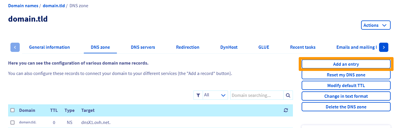

  • Your domain name uses an active DNS zone at OVHcloud: Log in to your OVHcloud Control Panel then go to the Web Cloud section. In the left-hand column, click DNS zones, then select the domain name for which you have customised the DNS servers. Go to the DNS Zone tab, then click Change in text format.

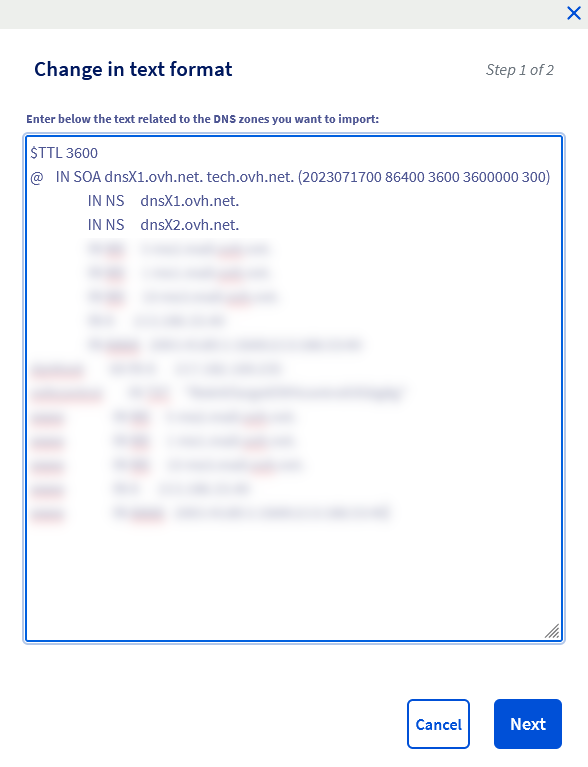

A window will appear with your DNS zone in text mode:
glueregistry
As a reminder, making an inappropriate change in text mode in your DNS zone can prevent access to your website and/or make your email addresses unable to receive incoming emails. Contact a specialist provider if you have any doubts.
In this window, replace only in records of the type NS the names of the DNS servers with your own custom DNS server names. You also have to increment the first numeric value in the SOA line by "1". Once you have made your changes, click Next then Confirm.
The change will not be visible immediately in the OVHcloud Control Panel. Wait around 20 minutes, then log in to the OVHcloud Control Panel to ensure that your changes have been processed.
You will need to wait between 4 and 24 hours for the changes in your DNS zone to propagate across the entire DNS network.
To get a better understanding of this step, let’s take a look at our example: The domain name domain.tld and its DNS zone in "text” mode, visible in the image above.
The following elements are observed:
  • The first numeric value of the line SOA is as follows: 2023071700.
  • There are two NS records for the domain name domain.tld.
  • Records of type NS still target the two DNS servers dnsX1.ovh.net and dnsX2.ovh.net.
To continue the customisation of the DNS servers for the domain name domain.tld, you will need to:
  • Increment the first numeric value of the SOA line by "1": 2023071701. (If the first numeric value was 2023071704, you would get the following result: 202307170**5).
  • Replace the target dnsX1.ovh.net. with dns1.domain.tld. only for the line that starts with IN NS.
  • Replace the target dnsX2.ovh.net. with dns2.domain.tld. only for the line that starts with IN NS.
Once the modifications are made, the result of our example will be the following:
$TTL 3600
@   IN SOA dnsX1.ovh.net. tech.ovh.net. (2023071701 86400 3600 3600000 300)
                  IN NS     dns1.domain.tld.
                  IN NS     dns2.domain.tld.

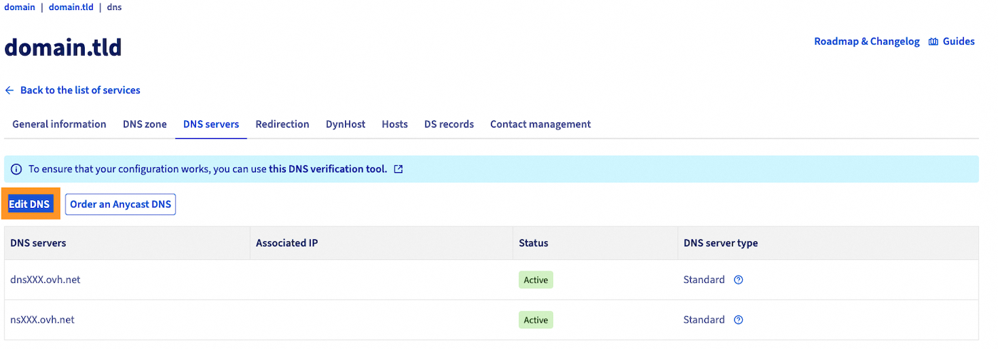

To do this, log in to your OVHcloud Control Panel, then go to the Web Cloud section. In the left-hand column, click Domain names, then select the domain name for which you want to customise the DNS servers.
Go to the DNS servers tab, then click Modify DNS servers. Then replace your current DNS servers with those you would like to use as custom DNS servers.
