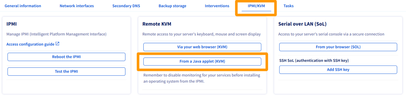

To enable one of these methods, click on the IPMI/KVM tab.
Open KVM via Java applet
We recommend installing the latest version of Java.
You will need to ensure that Java is installed on your desktop for the Java applet to work. If you do not have Java installed, go to the official page to do so.
In the Remote KVM section of the OVHcloud Control Panel, click on From a Java applet (KVM):
Java KVM Access

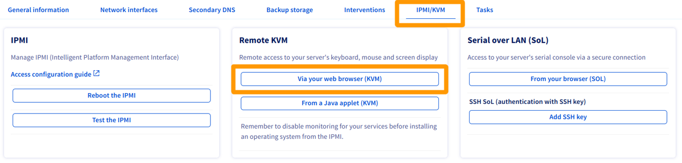

In the Remote KVM section of the OVHcloud Control Panel, click on Via your web browser (KVM).
HTML KVM Access

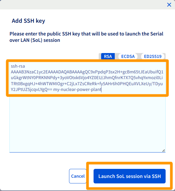

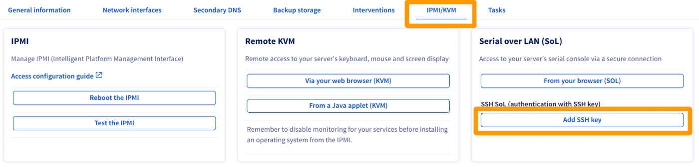

In the Serial over LAN (SoL) section of the OVHcloud Control Panel, click on Add SSH key.
SSH SoL Access
A popup will open so you can enter the public SSH key you want to use to connect with. Then click Launch SoL session via SSH.
SSH SoL SSH Public Key

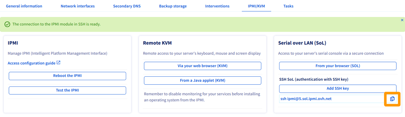

When the session is ready, a success message and an URI will appear so you can connect to the dedicated server via Serial via SSH. Copy that URI to the clipboard.
SSH SoL Opening

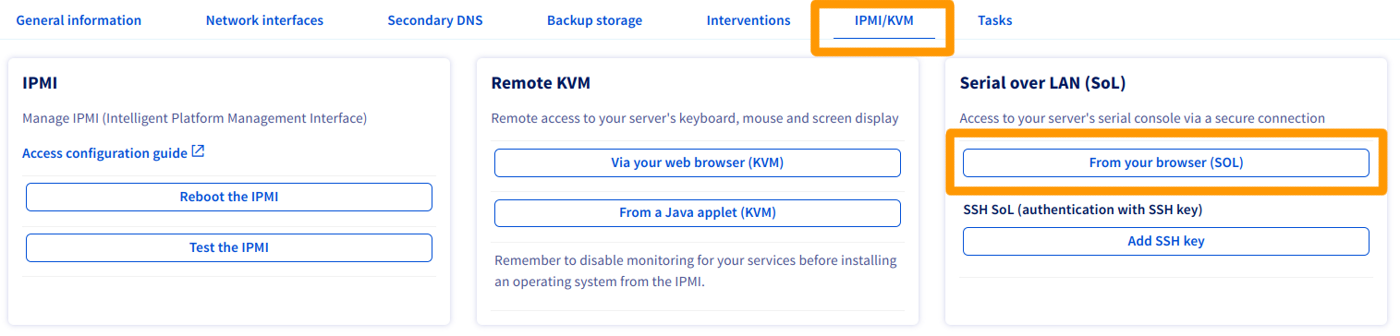

Open SoL via web browser
Click on From your browser (SoL) in the Serial over LAN (SoL) section of the OVHcloud Control Panel:
JavaScript SoL Access
If the switch to the popup does not happen automatically, you can still click the Go to console (SoL) button.
JavaScript SoL Opening

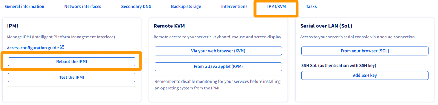

Test and reboot the IPMI
Your IPMI may stop responding. If you cannot access it, you can test it first by clicking on Test the IPMI, and checking the result of the diagnostic:
IPMI Test
If everything appears to be normal, as per our example, you may be experiencing a local technical issue (internet connection, local desktop). If the IPMI encounters any issues, you can reboot it by clicking Reboot the IPMI.
IPMI Reboot
It will take several minutes for the IPMI to reboot.

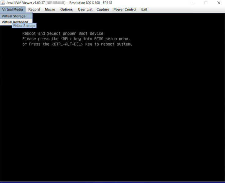

To begin, open IPMI in a Java applet from the OVHcloud Control Panel. Then, click Virtual Media and select Virtual Storage.
Virtual Storage option in the Virtual Media menu
From the new screen, select ISO File from the "Logical Drive Type" drop-down menu. Next, click Open Image and navigate to your ISO file. Finally, click Plug-in and OK to finish.
Select and mount an ISO file in Virtual Storage
In order to be able to boot from our ISO file, we need to access the BIOS and switch our boot options. To do so, select Power Control and click Set Power Reset.
Power Control menu with Set Power Reset option
You may need to use the soft keyboard for inputs to register in IPMI. To access this, click the Virtual Media option from the menu bar at the top of the window. Then, select Virtual Keyboard from the drop-down menu.
During the bootup process, press the DEL key when prompted to access the BIOS. You may also press the F11 key and navigate to the BIOS by selecting the option Enter Setup.

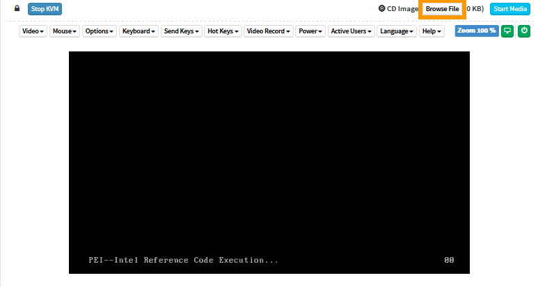

Installing an OS using web browser KVM (only for the latest servers)
OVHcloud does not guarantee the functionality of any operating systems installed via IPMI. This route should only be taken by an experienced server administrator.
In the OVHcloud Control Panel, open the KVM web browser console.
Here you have access to the same information and functionalities as in the Java-based IPMI modules.
Be sure to execute the next steps at a good pace. The process might be cancelled if there are longer pauses between actions.
Click on the Browse File button and select your image file.

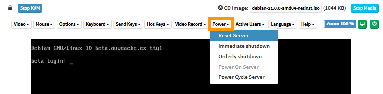

Click on Power and select Reset Server from the drop-down menu.
Power menu with Reset Server option in KVM

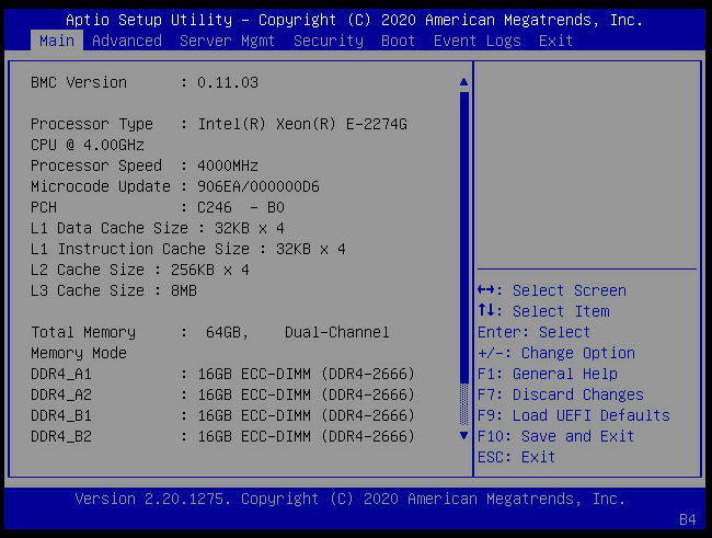

Rebooting a server into the BIOS menu
You might want to access the BIOS when configuring or troubleshooting your server. A convenient way to achieve this is by using the tool ipmiutil (refer to the project page for more information).
When the server is in rescue mode and you have logged in, install it with the following commands:
apt install ipmiutil
Then reboot the server with this command:
ipmiutil reset -b
Afterwards, access the IPMI console in your OVHcloud Control Panel. You should see the server's BIOS menu displayed.
KVM BIOS
