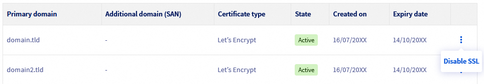

On the page that pops up, click on the SSL certificates tab.
SSL certificates
In the table at the bottom of the new page that pops up, click the button, located to the right of the line corresponding to the domain name concerned, then click Disable SSL.
Disable SSL

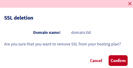

In the window that opens, confirm the deactivation by clicking Confirm.
Delete SSL
The SSL certificate will be deactivated within a few hours.
