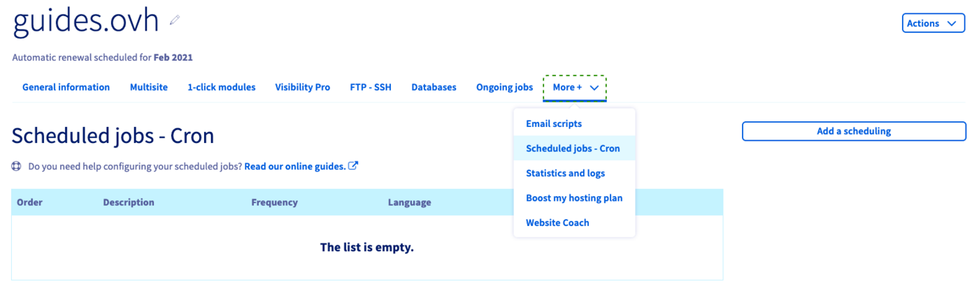

Log in to your OVHcloud Control Panel and select Web Cloud in the top navigation bar. Click Hosting plans, then choose the Web Hosting plan concerned. Next, navigate to the cron tab by selecting it in the More submenu.
In this section you will see an overview of your scheduled jobs and their settings.
cron control panel

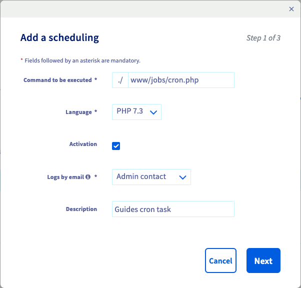

To create a new cron task, click on the Add a scheduling button on the right-hand side. You can customise the settings for the task in the new window.
adding scheduling
OptionDescription
Command to be executedDefine the path to the file containing your script. Example: www/jobs/cron.php
LanguageSelect the PHP version the script is using.
ActivationChoose whether the task will be active after creation or activated later.
Logs by emailIf necessary, select a contact (admin or technical) to whom a report will be sent in case of an execution error. You can also provide an alternative email address.
DescriptionEnter a description to keep track of what your tasks do.
Click on Next to proceed to the second step.

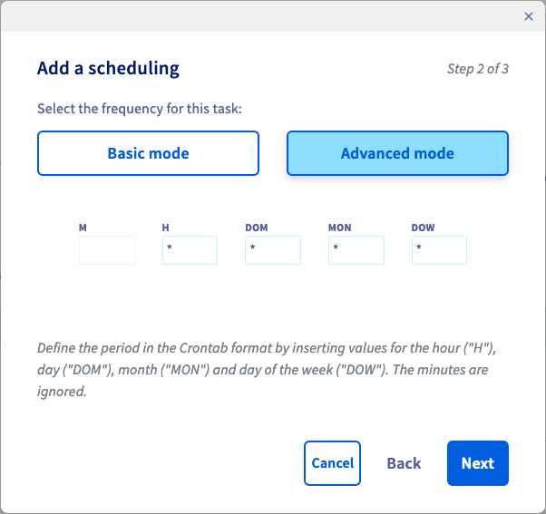

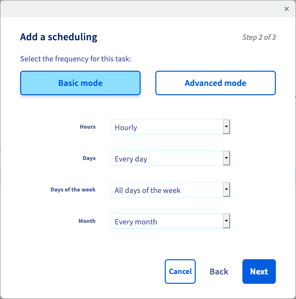

The interface offers two modes to configure the frequency of your task. Use the Basic mode for a beginner-friendly selection of scheduling options. If you prefer to directly enter a frequency, similar to a cron table format (crontab), choose the Advanced mode.
Basic mode
Use the drop-down menus to specify the time of day, days of a month, week days and months for the task.
cron frequency
Advanced mode
Enter numeric values as you would in a crontab. The asterisk operator denotes "every value" of the time period, meaning the task would continuously run once an hour every day in this example.
cron frequency
The Days form allows you to define execution frequencies on a monthly cycle.
The Days of the week form allows you to define additional execution frequencies, but on a weekly cycle.
You can switch between the two modes during configuration to view the changes accordingly. Please also note the limitations when scheduling a task on a Web Hosting.

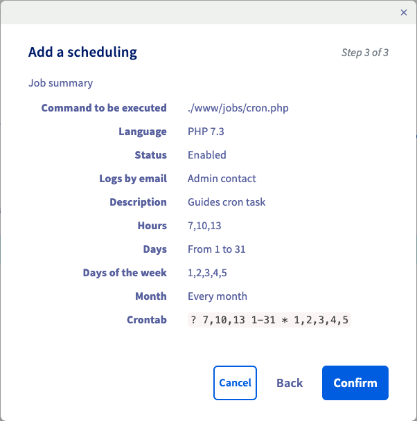

Step 3: Finishing the setup
The summary lists all your settings including the crontab notation of the execution frequency. If everything is correct, click on Confirm.
cron confirmation

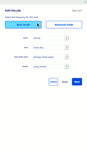

The task will be ready within a few minutes. You can then modify all of its settings or delete the task by clicking on ... in the overview table in your OVHcloud Control Panel.
Modify or delete a scheduled task
Click on the tabs below to view each of the 3 steps.
Click this link, then select the web hosting plan concerned.
Web Hosting
On the page that pops up, click on the More tab, then Cron.
In the table that appears, click the ... button to the right of the scheduled task concerned.
Click on the Edit or Delete button, depending on the action you want to perform on the scheduled task.
