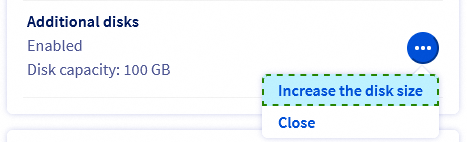

In the Home tab, go to the section labelled Your configuration. Click on ... next to the option Additional disks and in the context menu click on Increase the disk size.

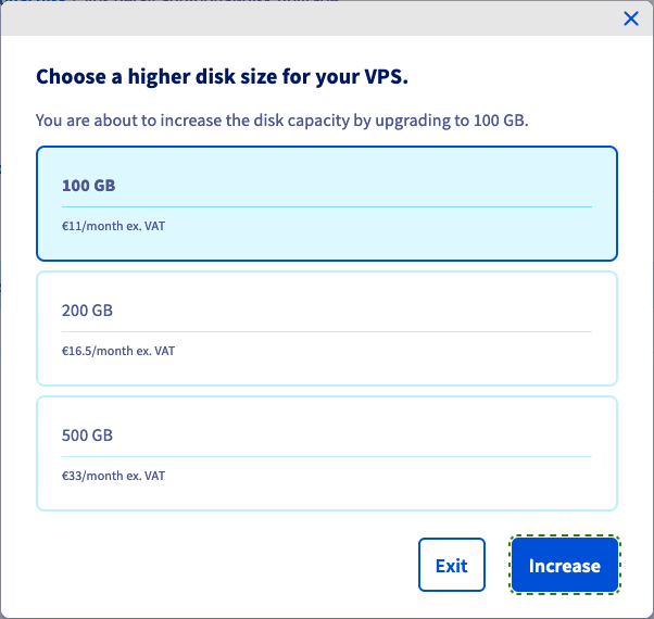

Choose the new disk size in the popup window, then click on Increase.

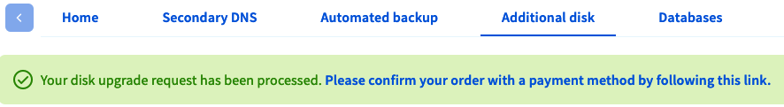

A message will appear to confirm your request. Click on the link inside the message box and follow the order process. A new browser tab opens to finalize the order.

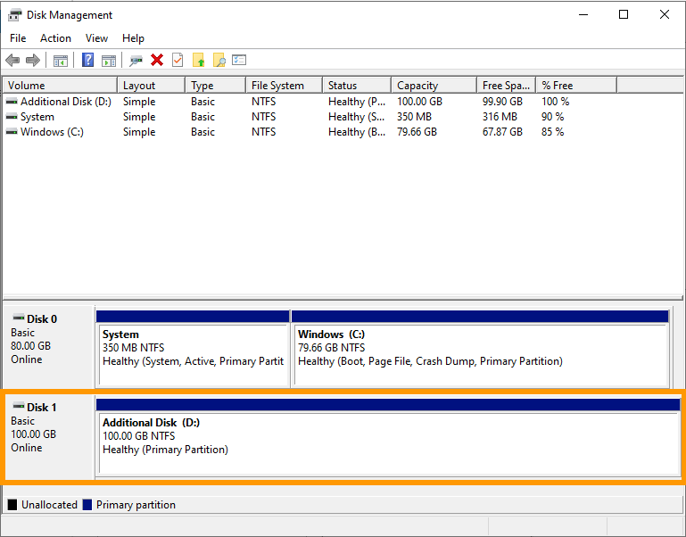

On a Windows VPS
If a Windows OS is installed on your VPS, establish a remote desktop (RDP) connection to your server.

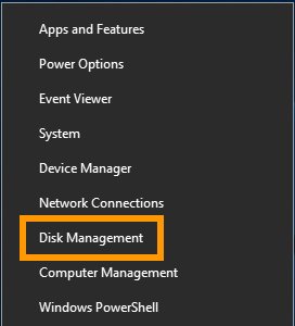

Once logged in, right-click on the Start Menu button and open Disk Management.
winmountdiskvps

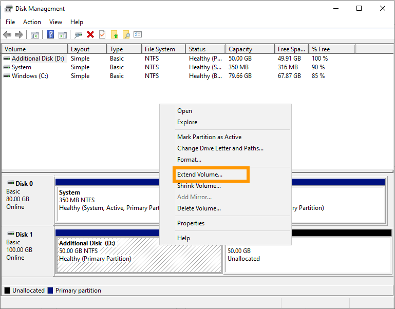

The extended disk displays the additional capacity as unallocated space. Right-click on the volume of your additional disk and select Extend Volume from the context menu.
winmountdiskvps

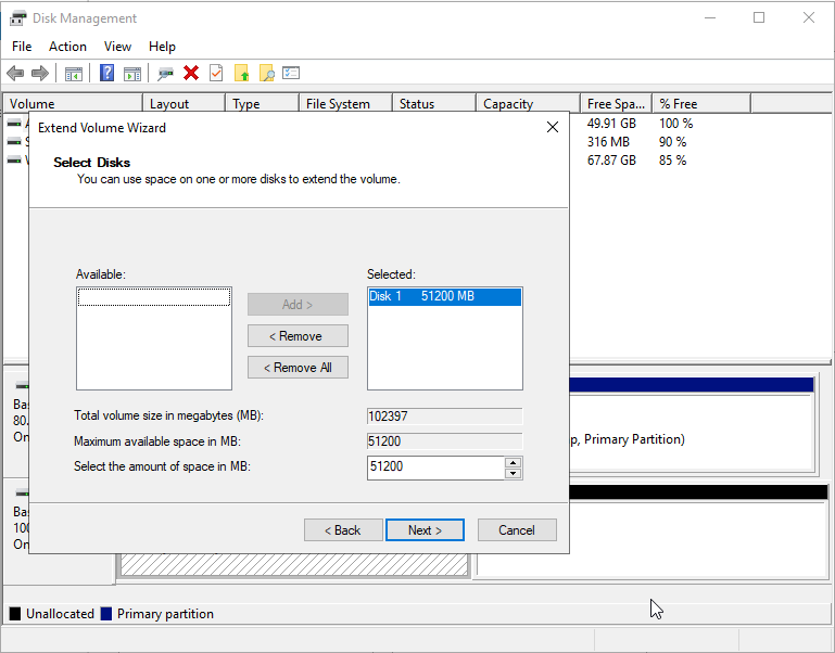

In the "Extend Volume Wizard", click on Next to proceed.
You can modify the disk space in this step if necessary. Click on Next.
winmountdiskvps
Click on Finish to complete the process.
The resized volume now includes the additional disk space.
winmountdiskvps
