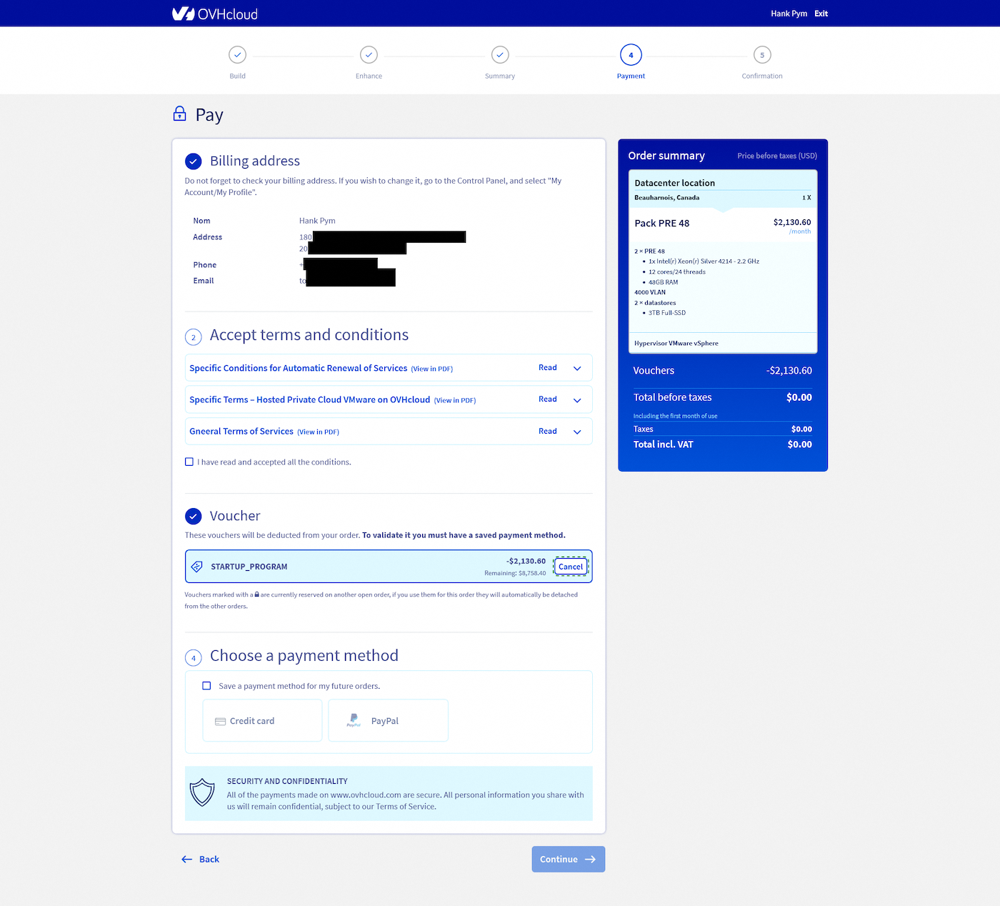

- Select the payment method:
- At the end of the order, when prompted to choose a payment method, go to the
Vouchersection. - Select the
STARTUP_PROGRAMvoucher by clickingApply. - Add or select a payment method to cover the cost of non-eligible products using the voucher.
- Proceed to payment: Click
Payto finalize the order using your credits.
