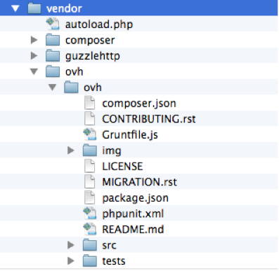

In your project, you will retrieve the directory ./vendor/ovh/ovh/, as well as the file autoload.php, which is used to manage all dependencies and imports.
your project with Composer
