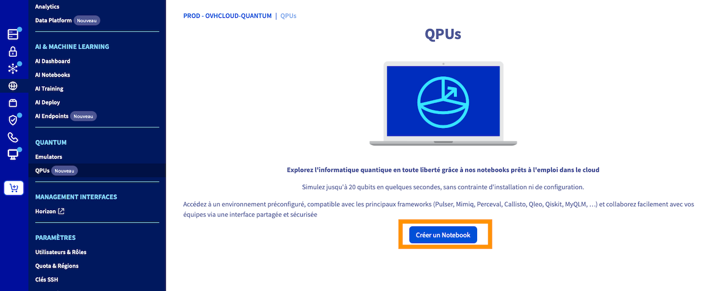

To create a Quantum Notebook, follow these steps:
Navigate to the Public Cloud section of the OVHcloud Control Panel and click the Quantum QPUs category. Click the Create a Notebook button and follow the prompts to specify the configuration of your Quantum Notebook.
Create a Notebook Control Panel manager 01

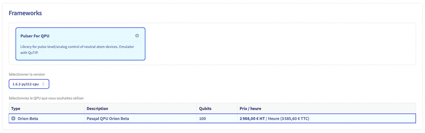

4. Pre-configured frameworks
Choose the Quantum Python framework you want to use, which will be pre-installed and ready to use when your notebook is launched. Select the version that suits your needs. Then, click Next to continue.

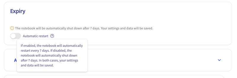

7. Notebook lifecycle
Our main motivation is to keep the platform up-to-date in terms of security patches and new feature alignment. To achieve this, we need to update and restart hosts from time to time, which requires them to be free from any customer workload.
By default, your AI notebook will automatically shut down after 7 consecutive days of running. Rest assured that all your settings and data will be preserved. You have the option to enable Automatic Restart, which will automatically restart your notebook every 7 days, ensuring minimal disruption to your workflow. Alternatively, you can also contact our support to extend this automatic restart period from 7 to 28 days.
Create a Notebook Control Panel manager 06

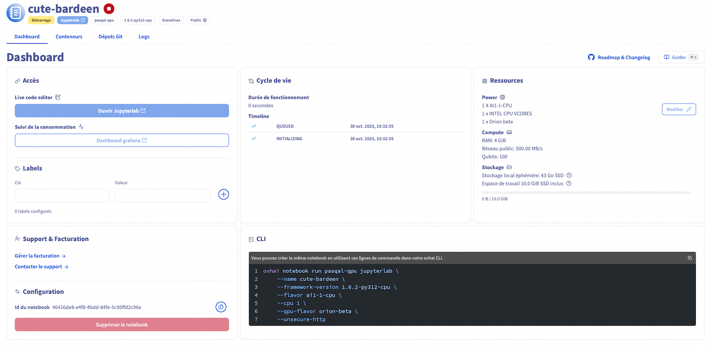

9. Launch the Quantum Notebook
At the end of the process, review your settings and click the Order now button to confirm and launch the creation of your Notebook. You will be redirected to your notebook dashboard:
Create a Notebook Control Panel manager 10
Note at the bottom of the screen the equivalent ovhai CLI command. This command allows you to run the exact same Notebook using the CLI.

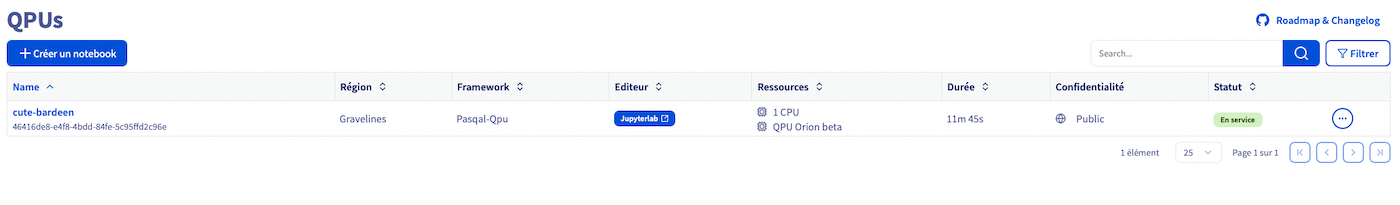

When your Notebook is created, it will appear on your Quantum QPUs tab:
Create a Notebook Control Panel manager 11

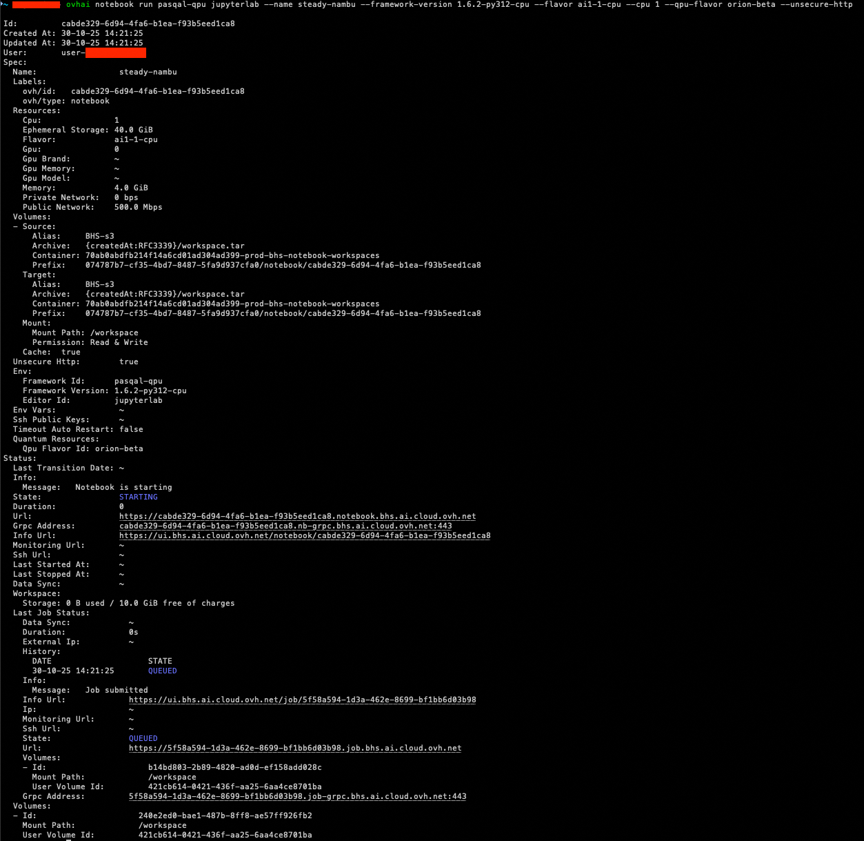

If you prefer to use the command line interface to launch your Quantum Notebook, please follow these steps:
  1. Follow this AI & Machine learning documentation to install the ovhai CLI and log in.
  2. Visit this second documentation to learn how to create your Quantum Notebook using commands.
Create a Notebook ovhai CLI

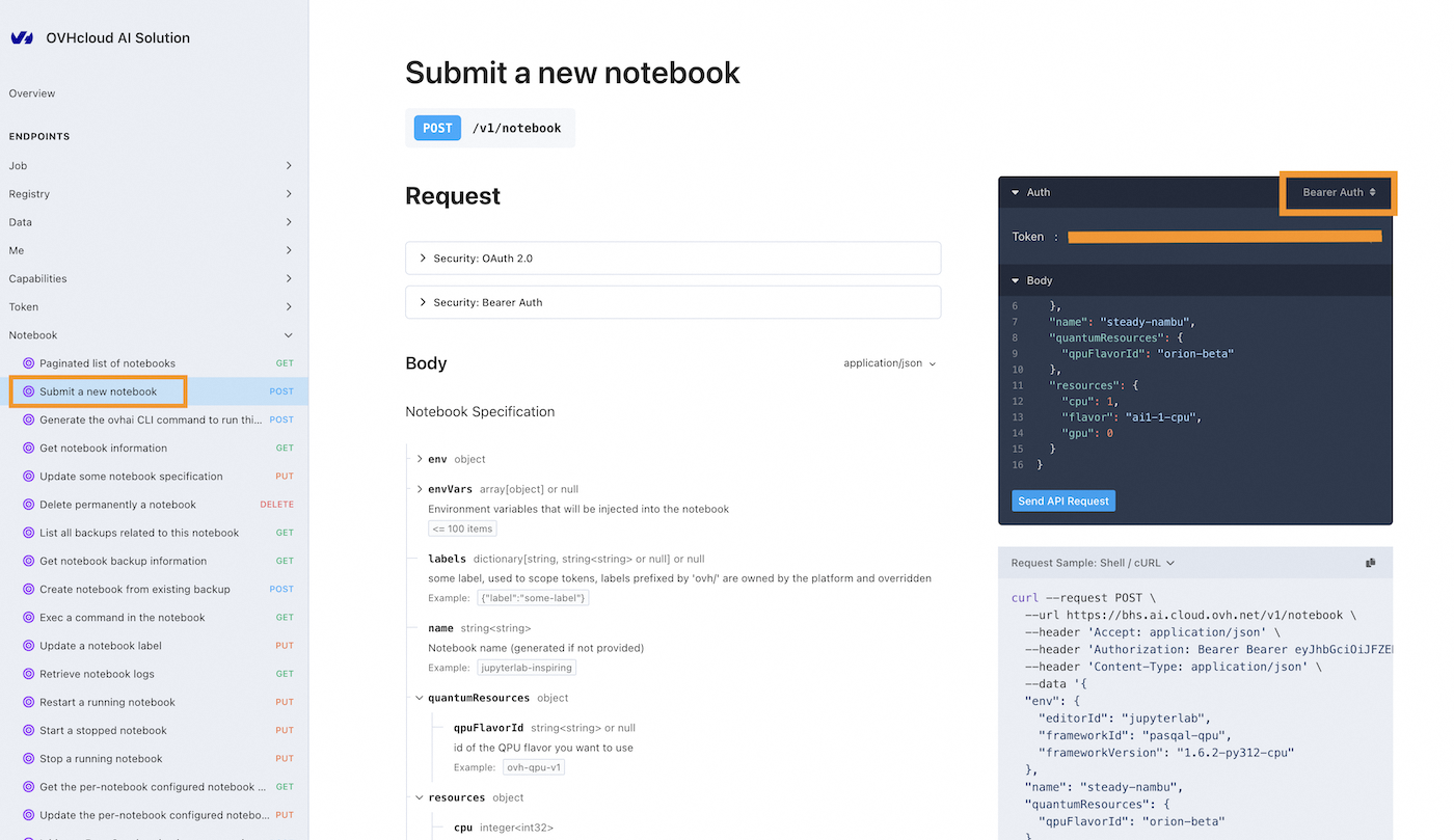

  1. Create a bearer token from the ovhai CLI. For more detailed instructions on creating a token, check the manage access tokens documentation.
  2. Navigate to the desired region and follow the instructions to create a Quantum Notebook.
  3. Submit a new notebook POST method
Make sure to select Bearer Auth instead of OAuth 2.0, which is selected by default.
Create a Notebook API token authentication

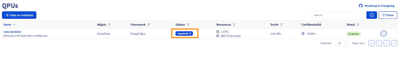

Once your Quantum Notebook is created and running, you can access it using the JupyterLab link in the Quantum Notebooks board or through the ovhai CLI, Quantum API, or Python SDK.
Click the JupyterLab link in the Access column:

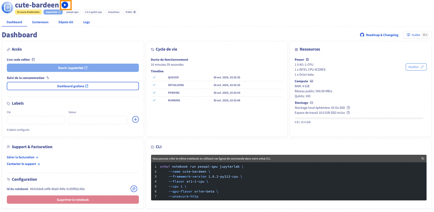

You can also access the Notebook from its dedicated page:
Accessing a Notebook Control Panel manager 2
On the Notebook page, you will find information about the Notebook, including specifications, billing, and attached data, as well as a monitoring URL for real-time metrics.
The URL of your Notebook should be displayed in your terminal and you can display it by running ovhai notebook list to retrieve the URL.
Access a Notebook ovhai CLI

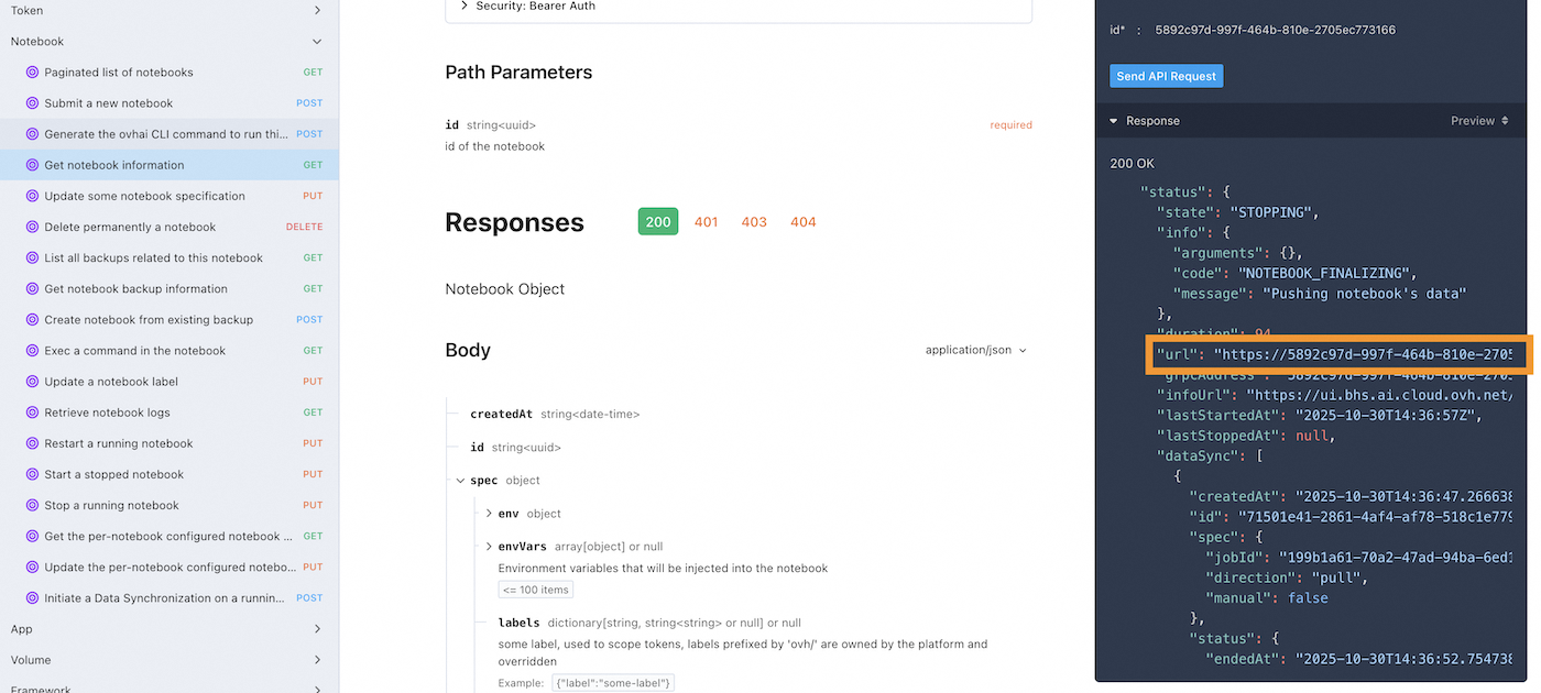

You can also get Notebook information using ovhai notebook get <NOTEBOOK_UUID>.
The URL of your Notebook should appear in the Response panel:
Access a Notebook API
If not, use the Paginated list of notebooks GET endpoint method:
You can also get Notebook information using the Get notebook information GET endpoint method.

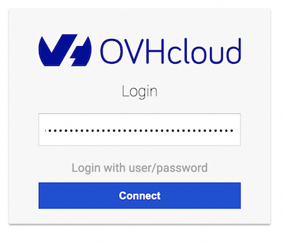

Connecting to your Quantum Notebook
To connect to your Quantum Notebook, you'll need to authenticate using a username and password combination or an access token.
Using a Username and Password
Enter your Public Cloud project user's credentials to log in to your Quantum Notebook.
Notebook Authentication Credentials
Using an Access Token
Click the Login with token button and enter your access token to log in to your Quantum Notebook.
Notebook Authentication Token

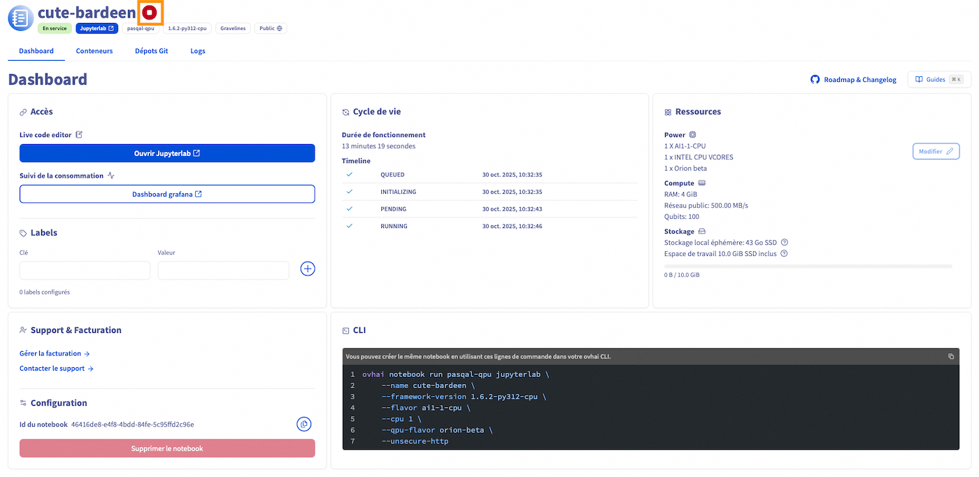

Stopping a Quantum Notebook
You can stop your Quantum Notebook at any time to release its compute resources. This will release its compute resources but will keep your Notebook data and installed libraries. Therefore, you will not incur any further charges for compute unless you restart the Notebook. However, attached storage will be billed at the price of OVHcloud Object Storage (consult the Quantum Notebooks Billing documentation for more information). To do so, follow these steps:
Go to the Quantum Notebooks board and click on the ... button next to the Notebook you want to stop. Click the Stop button to stop the Notebook. Or, on the notebook board, you can click on the red button at the top of the page.
Stop a Notebook Control Panel manager
Run the command ovhai notebook stop <NOTEBOOK_UUID> to stop the Notebook.
If you do not know its UUID, remember that you can easily list all your existing Quantum Notebooks by running ovhai notebook list.

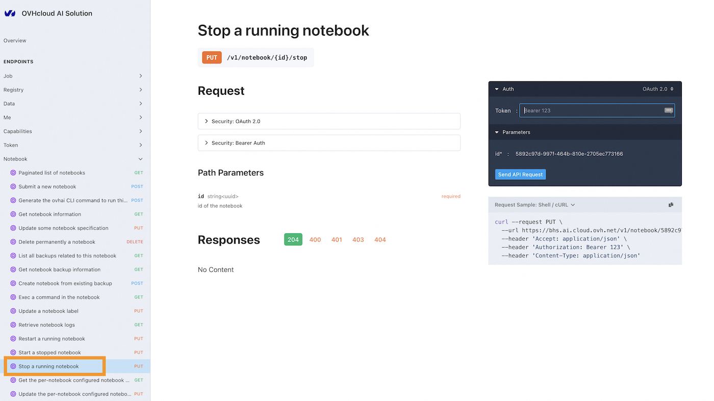

Select the Stop a running notebook endpoint and provide the UUID of the Notebook you want to stop.
Stop a Notebook API
Use the notebook_stop method to stop the Notebook.

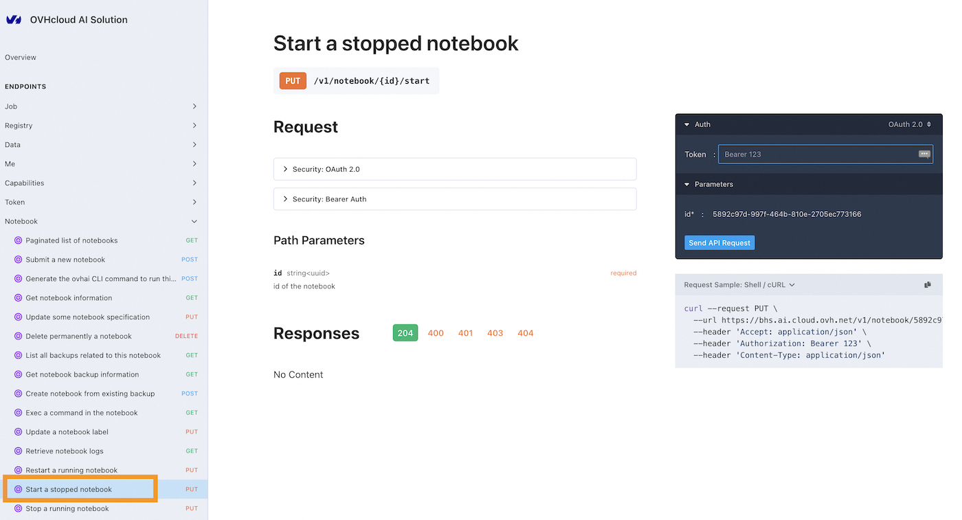

Restarting a stopped Notebook
To restart a stopped Notebook, follow these steps:
Go to the Quantum Notebooks board and click on the ... button next to the Notebook you want to restart. Click the Start button to restart the Notebook. Or, on the notebook board, you can click on the blue button at the top of the page.
Restart a Notebook Control Panel manager
Run the command ovhai notebook start <NOTEBOOK_UUID> to restart the Notebook.
Select the Start a stopped notebook endpoint and provide the UUID of the Notebook you want to restart.
Restart a Notebook API
Use the notebook_start method to restart the Notebook.

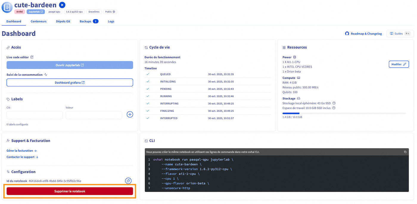

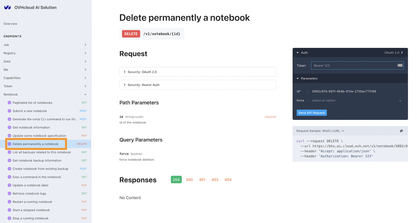

Deleting a Notebook
The notebook must be stopped before deleting it. To delete a Notebook, follow these steps:
Go to the Quantum Notebooks board and click on the ... button next to the Notebook you want to delete. Click the Delete button to stop the Notebook. Or, on the notebook board, you can click on the Delete notebook button at the bottom of the page.
Delete a Notebook Control Panel manager
Run the command ovhai notebook delete <NOTEBOOK_UUID> to delete the Notebook.
Select the Delete permanently a notebook endpoint and provide the UUID of the Notebook you want to delete.
Delete a Notebook API
Use the notebook_delete method to delete the Notebook.
