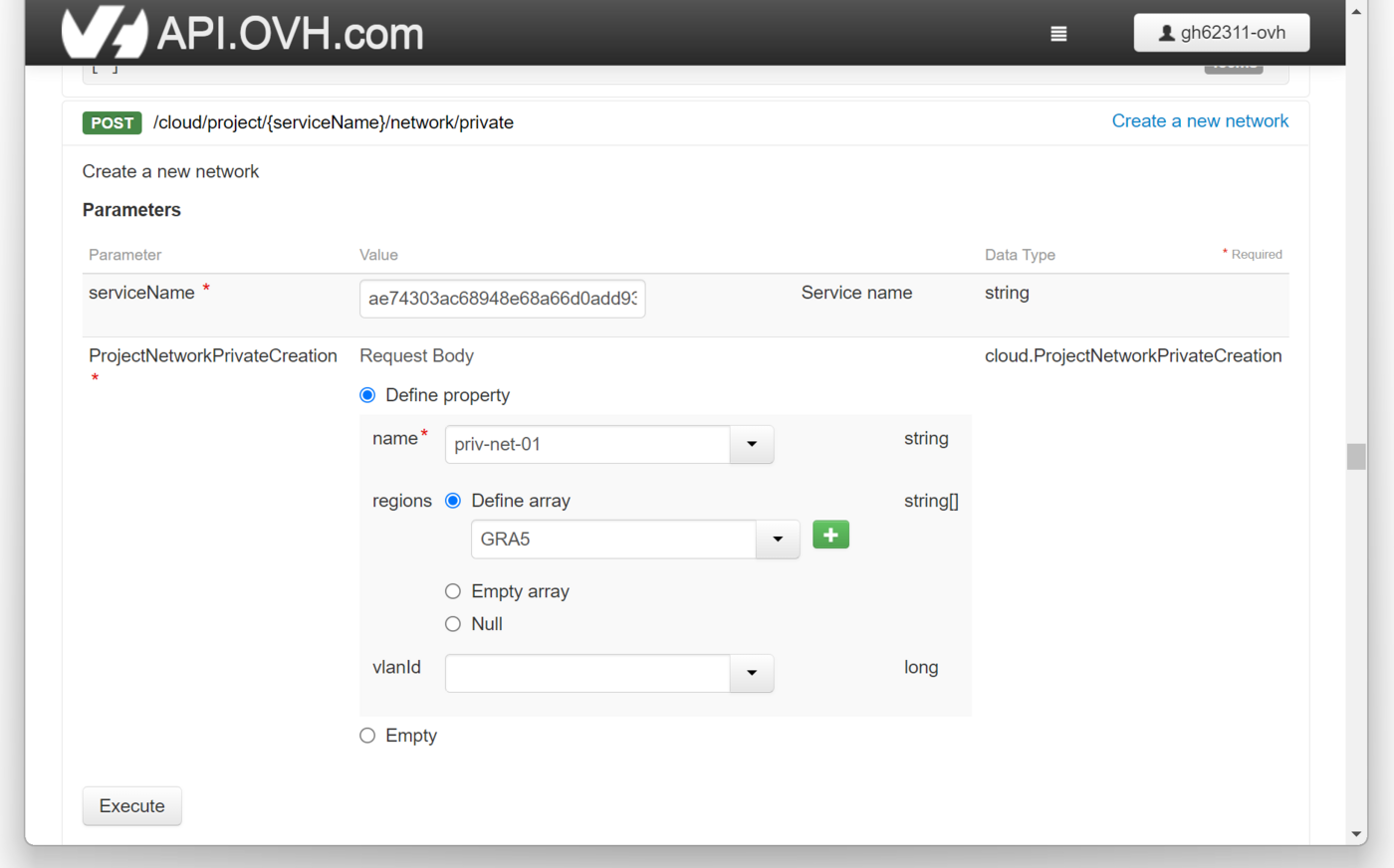

Once we have created a vRack, we need to create two different Private Networks enabled at least on the region of our cluster (GRA5 in our example). The private networks created via the OVHcloud Manager have by-default ranges, that can't be easily modified. We are thus creating the private networks using the OVHcloud API.
For this example we are creating two private networks, priv-net-01 & priv-net-02, with DHCP subnets with ranges of 10.0.1.0/24 et 10.0.2.0/24.

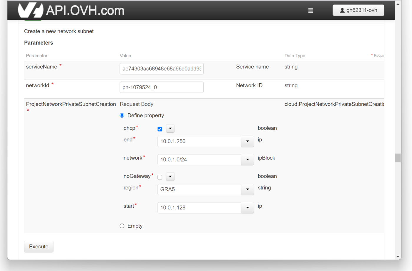

We will use the POST /cloud/project/{serviceName}/network/private endpoint to create the private networks:
Setting-up the vRack
And then we assign them the subnets using the POST /cloud/project/{serviceName}/network/private/{networkId}/subnet endpoint:

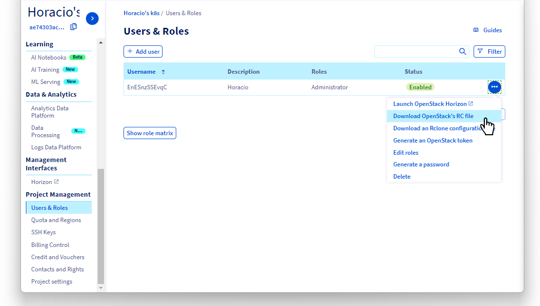

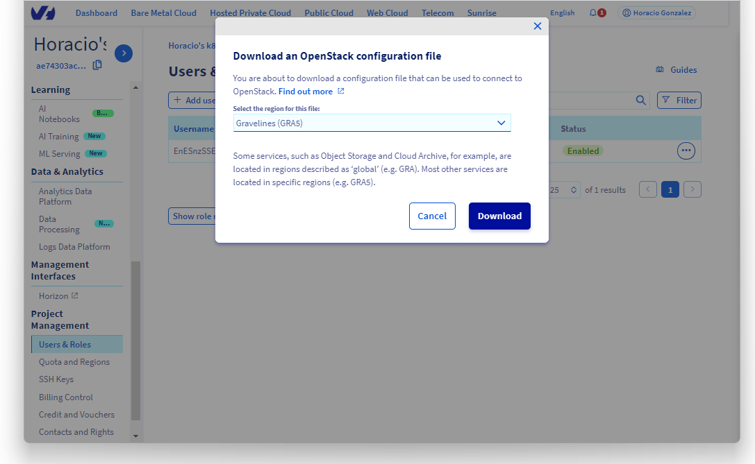

Retrieving the Openstack configuration file
Now we need to download the openrc.sh configuration file, as explained in the Setting OpenStack environment variables guide.
We will be working on GRA5 region, so we download the Gravelines (GRA5) file.
Following the steps on the Setting OpenStack environment variables guide to be sure that the Openstack CLI is working on our workstation.

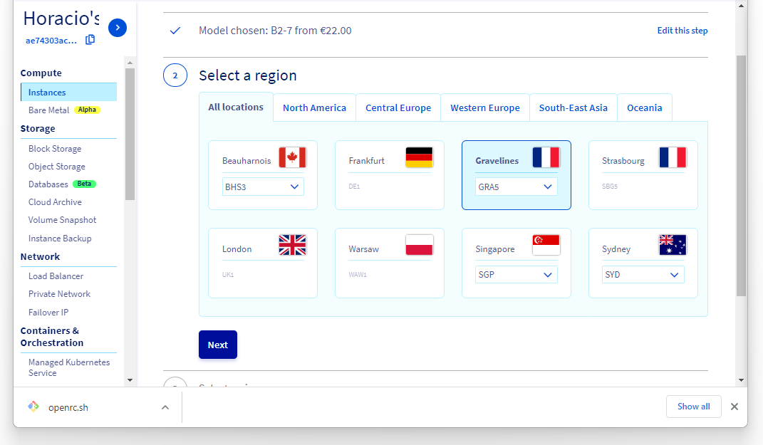

Now we are going to create a Public Cloud instance in GRA5, to act as a gateway for our vRack.
Setting-up a PCI gateway

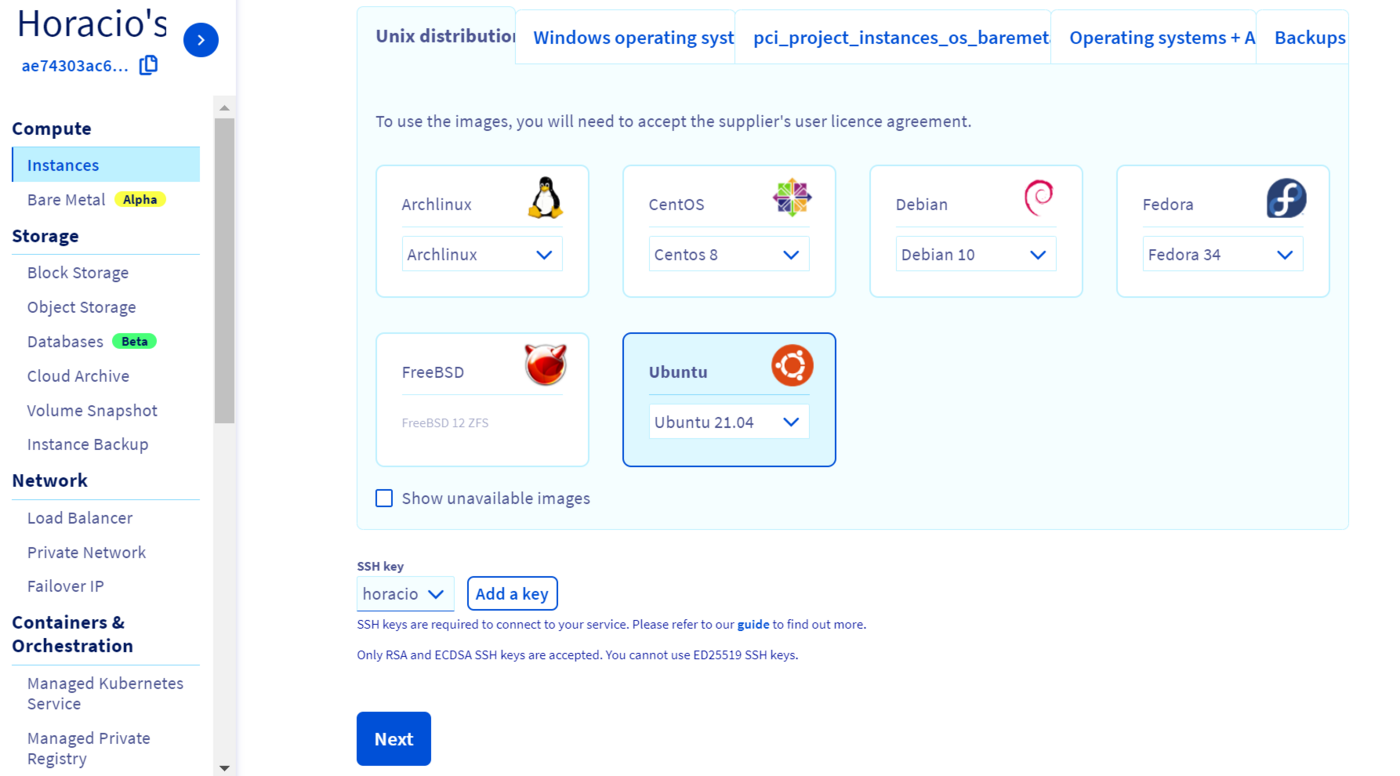

We are going to create an Ubuntu instance:

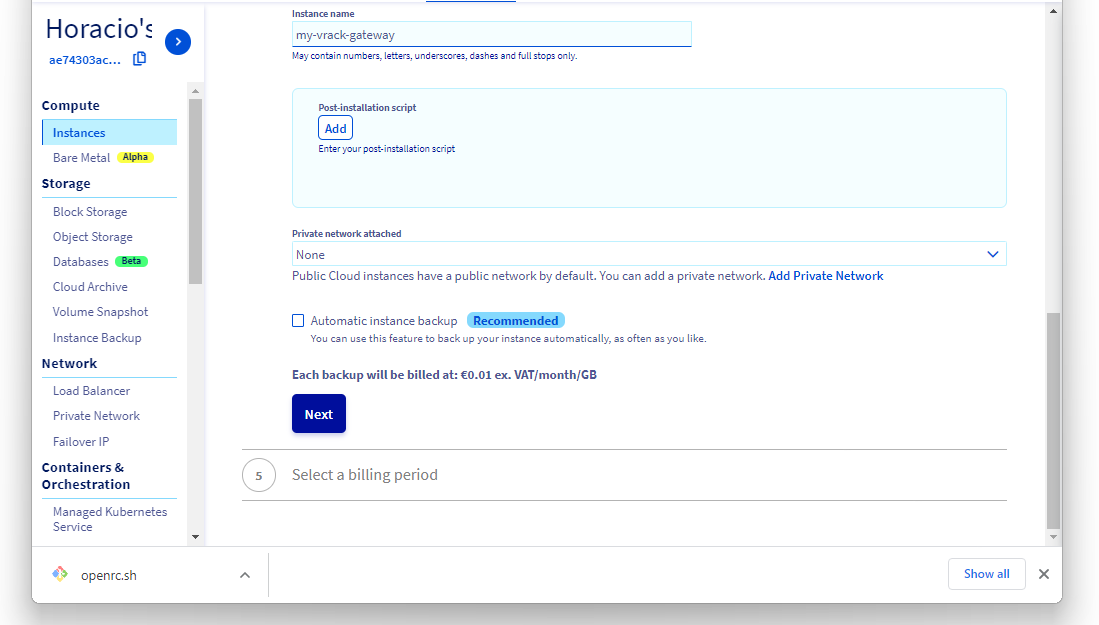

We do NOT attach the instance to a private network yet, as you can unfortunately configure only one private network at the creation stage in the OVHcloud Manager.

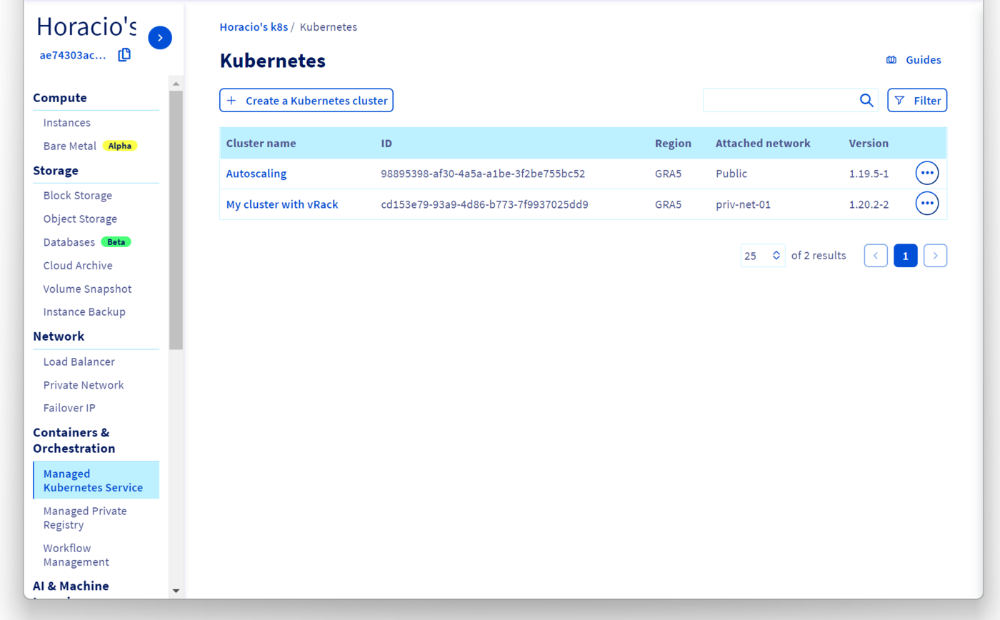

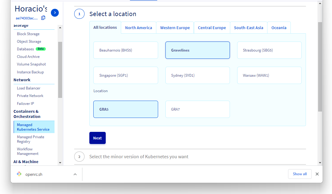

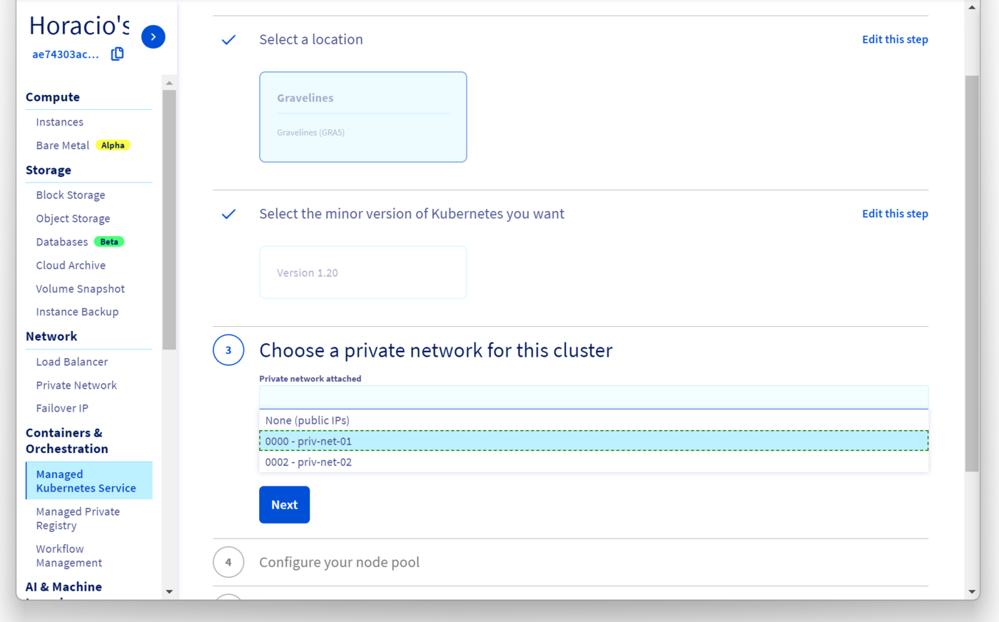

Setting up the Managed Kubernetes attached to priv_net_01
Then we create a Kubernetes cluster in GRA5 region, attached topriv_net_01, as explained in the Create a cluster guide.
Choose a private network for this cluster
Integrating a cluster into a vRack Private Network must be done at the third step on cluster creation, when we can choose an existing private network for the cluster:
Our new cluster will be created inside priv_net_01.
In the Managed Kubernetes Service Dashboard, we can see the cluster, with the chosen private network in the Attached network column:
Private network information in Attached network column
Don't forget to grab your kubeconfig and configure kubectl to use it, as explained in the Configuring kubectl on an OVHcloud Managed Kubernetes cluster guide.

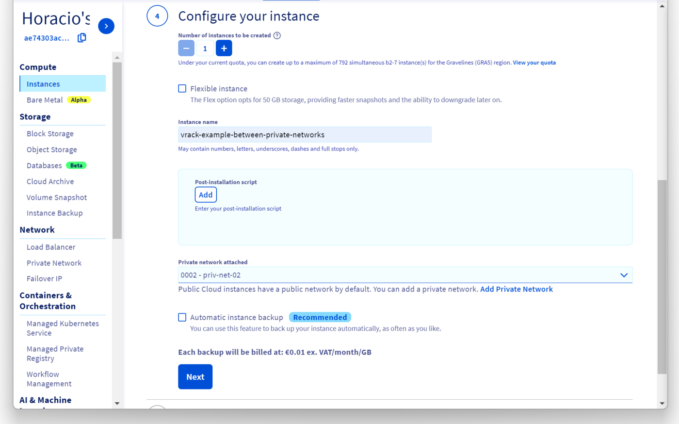

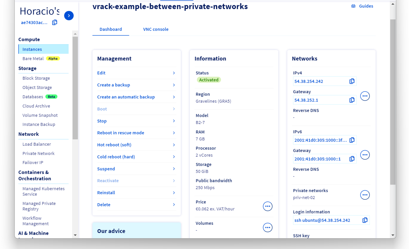

Setting up a PCI attached to priv_net_02
Now we can create a new Public Cloud instance, also in GRA5 region, and attach it to priv_net_02 by following the Integrating an instance into vRack guide.
Setting-up a PCI attached to priv_net_02
In the fourth step of the creation, we call it vrack-example-between-private-networks and we attach it to priv_net_02:
After the instance creation, we can see the connection details in the OVHcloud Control Panel.
If we log in to the instance using SSH, we can see that it has two network interfaces, one attached to the public IP address we use to log in, the other attached to the private network:
~$ ssh ubuntu@54.38.254.242
Welcome to Ubuntu 21.04 (GNU/Linux 5.11.0-18-generic x86_64)
  System information as of Fri Jun 18 04:37:54 UTC 2021
  System load:  0.35              Processes:             113
  Usage of /:   3.6% of 48.29GB   Users logged in:       0
  Memory usage: 3%                IPv4 address for ens3: 54.38.254.242
  Swap usage:   0%                IPv4 address for ens4: 10.0.2.142
ubuntu@example-vrack-k8s-pci:~$ exit
Please take note of the private network IP address (in my case 10.0.2.142), as we will need to use it later.
