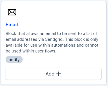

To access the lists of blocks, go to your Prefect Cloud account. In the sidebar, locate the tab Blocks and click on it. You will be able to see a list of softwares. It can be Docker, Github, json, etc. Here, we will use the Email Block. It should be similar to this:
Click on the Add + button and fill in the block with a name and the desired email address where you will receive a notification. You can enter multiple email addresses. Once your block is created, let's see what an automation is and why it will be useful to send our email.

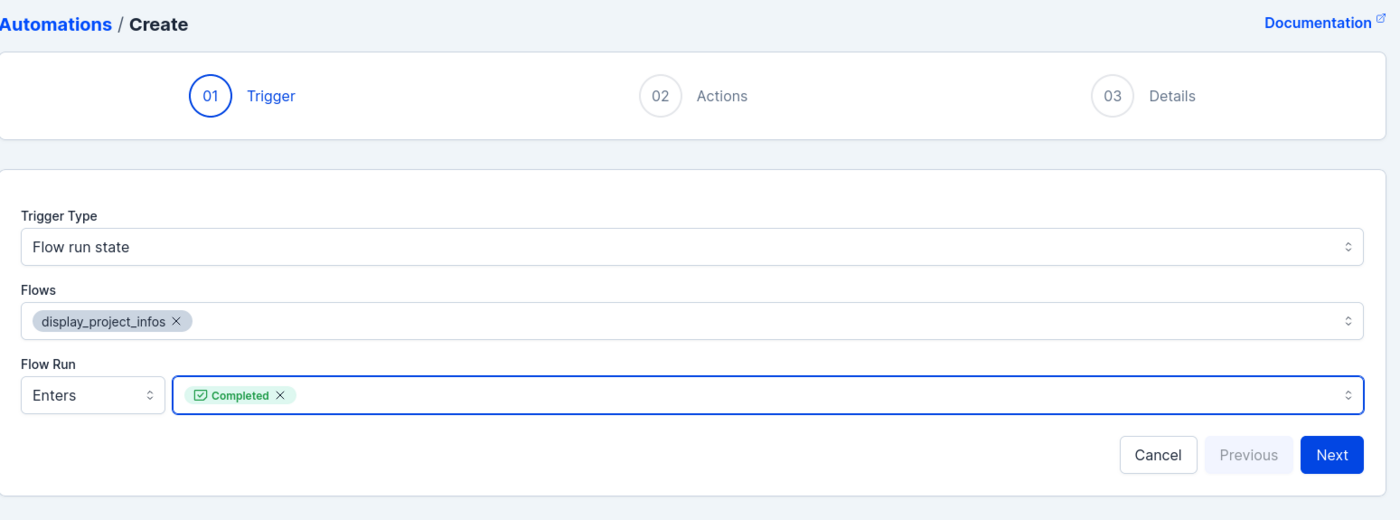

The first step to complete is the trigger. In this example, we will send an email when the flow previously created in our Getting Started guide is completed. You can fill in the page as follows:
You can select multiple flows for an aggregated email notification.

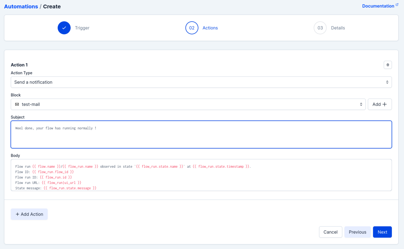

Next, you will need to describe the action to be taken when your flow ends. Here, we want to send a notification, more precisely an email. Choose Send a notification as an action type, then choose the email block we created earlier and define the subject of the email and the body. The creation of the automation is responsive. The suggestions will vary depending on the action chosen. Your actions page should look like this:

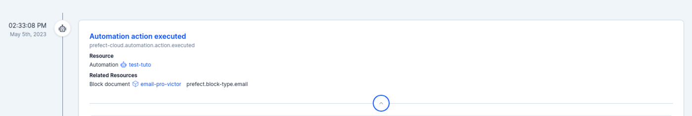

Wait until your flow is completed and check your mailbox, you will receive an email from Prefect. If you go directly on the events feed in the Prefect UI, you can see the email has been sent. Here is a picture of the event run by your automation:
The event feed tab is a good way to see if your flow failed or not and if the automation has been processed. In our case, we also received an e-mail at the address provided.
