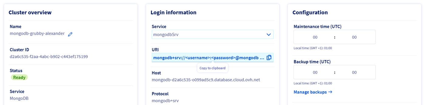

To retrieve the MongoDB URI (mongodbSrv), open your Public Cloud project and click on Databases in the left-hand navigation bar and select your MongoDB instance.
From the central Login information panel, select mongodbSrv as Service and copy the URI.
Copy SRV URI from the OVHcloud manager

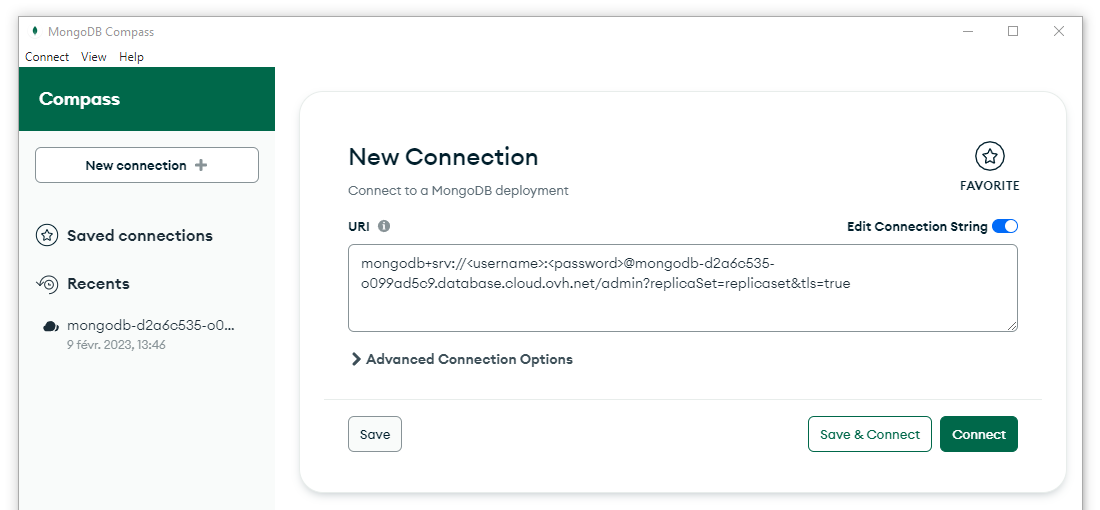

Open MongoDB Compass and fill in the connection field with the mongodbSrv connection string you just copied. Substitute the username and password by their actual values and click Connect.
Connect from MongoDB Compass

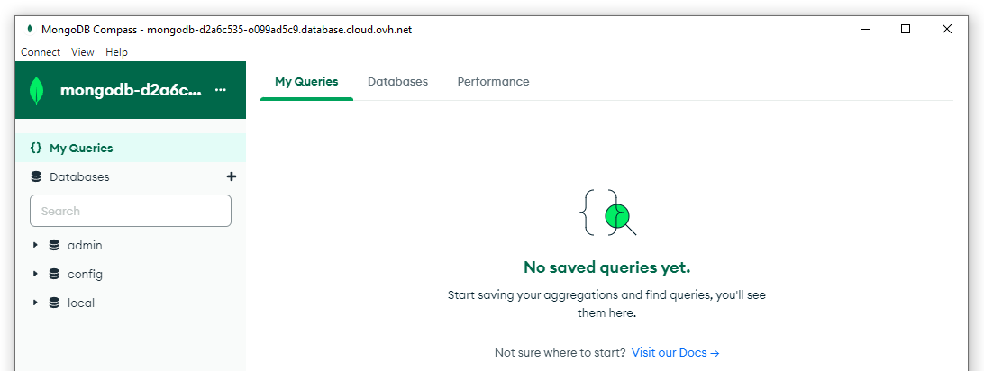

MongoDB Compass establishes the connection and you should now be able to explore your databases.
MongoDB Compass is connected

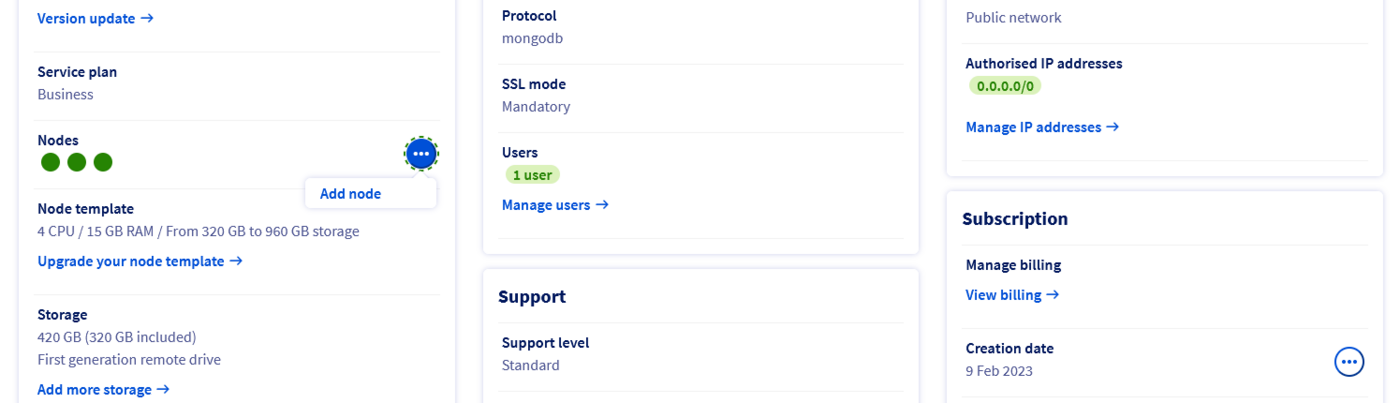

Add a node to a cluster
Imagine you want to scale your cluster up to support additional load.
From the OVHcloud Control Panel, click the Add node button and confirm.
Add node from OVHcloud Control Panel
Once the new node is spawned, no need to reconfigure your connection.

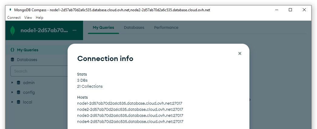

Once MongoDB Compass has established the connection, click the three dots ... menu besides the connection name.
From the menu, click Connection info.
MongoDB Compass connection info 4 nodes
Your MongoDB Compass is now connected to the 4 nodes of the cluster.

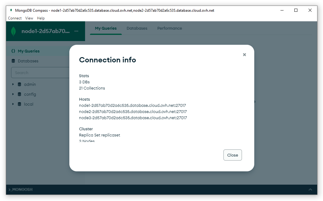

After a few seconds, the node is effectively deleted from the cluster. Return to MongoDB Compass and open the Connection info. You should be able to see that MongoDB Compass has updated the list of nodes of your cluster, and lists only 3 nodes.
Without having updated the connection string, the client application has dynamically updated its connection information.
