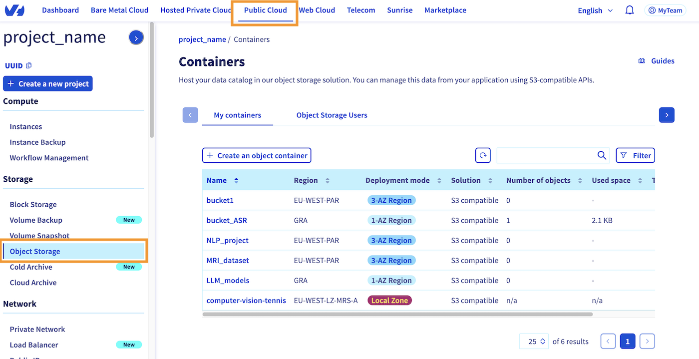

Create an S3 compatible bucket
To create your first S3 compatible Object Storage bucket, click this link to access your Public Cloud project, then click the Object Storage button in the left-hand side bar, in the Storage section:
S3 compatible bucket creation
This should take you back to the page shown above, where you can see all the buckets you have already created on your Public Cloud project. By going to the My Containers section, where you are by default, you can create a new bucket by clicking the Create an object container button, just above the bucket list.
If you haven't created a bucket yet, the interface will be slightly different, but will also prompt you to Create an object container.

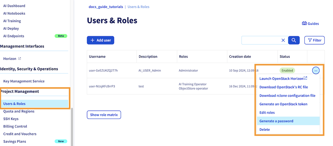

Edit your S3 compatible user roles
Once your S3 compatible bucket has been created, you need to check that the associated user has the necessary rights to interact with your data and the OVHcloud AI Solutions (AI Notebooks, Training and Deploy).
For Local Zone deployment, you did not need to associate a user with your bucket. However, it is important to check that you also have at least one user with the necessary rights.
To do that, click on Users & Roles in the Project management category, in the OVHcloud Control Panel (UI) left-hand side bar.
Whether you have created a new user or use an existing one, check that this user has at least the following rights: AI Training Operator and ObjectStore Operator, as shown below:
For more information about editing user rights, you can check the dedicated documentation.
Retrieve user credentials
Before continuing, you need to ensure that you have the following information so that you can authenticate via the CLI and use your bucket:
  • Username
  • Password
  • S3 compatible access key
  • S3 compatible secret key
As we saw in the previous step, all your Public Cloud project users are displayed in the Users & Roles menu in the Project Management category. You will find there your existing usernames. The username we are interested in is the one to which you gave permissions in the previous step.
If you have lost the password associated with this username, you can regenerate it by clicking the ..., then on Generate a password, which will revoke the old one.
user credentials
Then, you need to retrieve the access key and secret key associated to this user. To do that, return to the Object Storage section. By default, you will redirected to the My containers section. Click on the Object Storage Users category. Here you will find the access key for each of your existing users. You can also view the secret key by clicking the ... button, then on view the secret key, as showed on the screnshot below:
user keys
