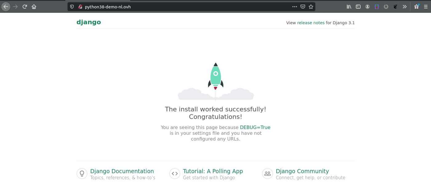

Then restart your instance and your Django will be online.
Django
