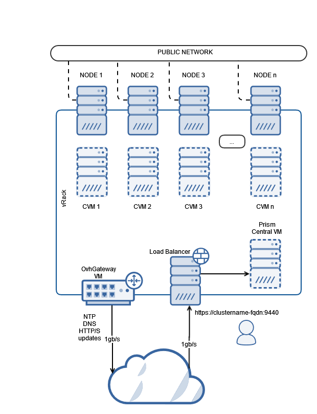

A Nutanix cluster consists of a stack of OVHcloud services:
Dedicated servers (3 minimum) are connected within the vRack which is an L2 network, the hosts (node) private network.
Two VLANs are used, VLAN 0 for public internet and VLAN 1 for Nutanix infrastructure (Hosts, CVMs, Prism Element and Prism Central).
The public IP address of each node is not accessible since the Additional IP is dedicated to the Internet access. This access is ensured by the "OVHGateway" wich is a dedicated VM created by OVHcloud on your cluster.
The load balancer is used to expose the Prism Central WebUI to the public Internet. For security reasons, you are able to restrict the WebUI to IP addresses of your organisation.

The OVHgateway provides Internet access to the cluster via the Additional IP address.
This VM uses two network cards (in the vRack), one for the private network on VLAN 1, the other one for the public internet on VLAN 0.
The VM uses NAT to route traffic from the private network to the Internet. You can therefore use it for outgoing traffic but not for incoming traffic.
OVHgateway has a lightweight design, using 1 vCPU, 1 GB memory and a 1 GiB disk.
Bandwidth for Internet access is 1 Gbps.
This machine is only for you to download your first sources (Windows ISO, appliances, etc.). You will need to replace this virtual machine with another operating system. See this guide for more information: Replace OVHgateway.

Once the cluster is delivered, OVHcloud provides you with a FQDN for your cluster.
Acces to Prism Central is available under https://<fqdn>:9440. This access is provided through the load balancer.
