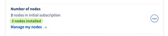

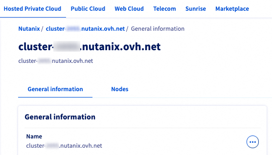

  1. In the General information tab, you can see the Number of nodes. Click Manage my nodes.

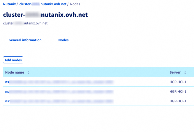

  2. In the Nodes tab, select Add nodes.
    Add nodes tab

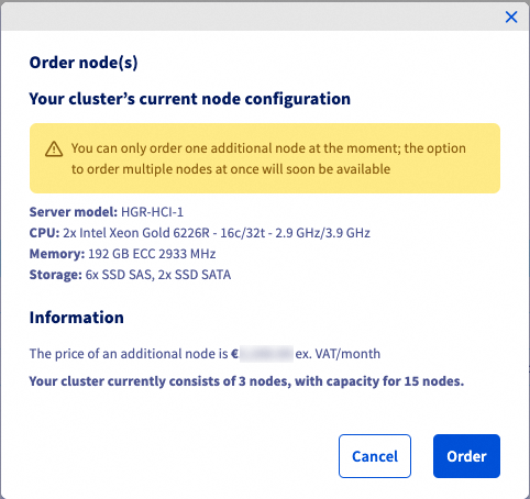

  3. Review the configuration and pricing in the pop-up window, then click Order to add the node(s).
    Order popup

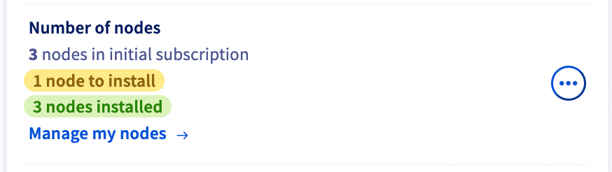

Once the node is delivered, you can see the status in the General information tab.
The Number of nodes area will show a new node to install.
New node to install

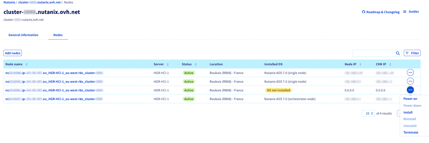

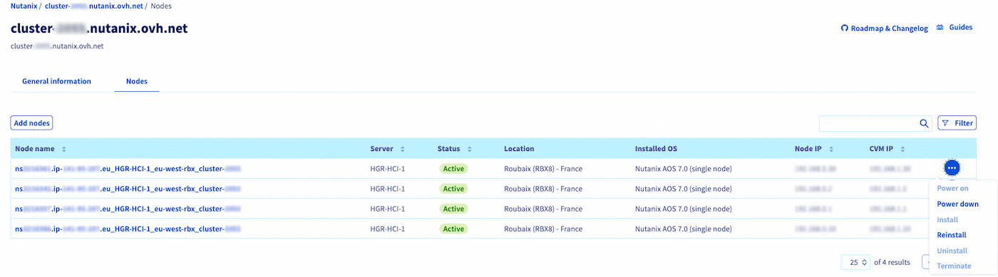

If you click Manage my nodes again, you will see a list of your nodes. For any node with an OS not installed status, click the more options ... button and select Install.
Node status

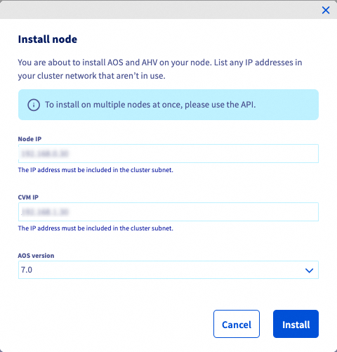

Enter the configuration details for your node. Be sure to install the same AOS version as your cluster.
Click Install.
Install option

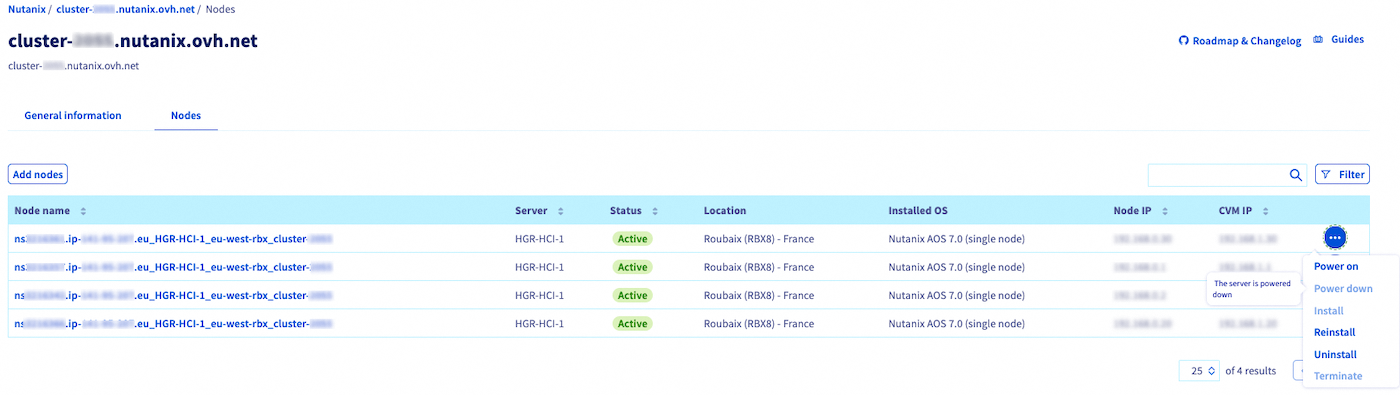

Scale In (remove a node)
Power down a node
    Manage my nodes
  2. Here, you have 2 options:

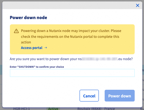

For the node you wish to remove, click the more options ... button and select Power down.
Power down
A warning pop-up will appear. Type the required term and click Power down.
Powering down a Nutanix node may impact your cluster. Please check the requirements on the Nutanix portal to complete this action.
Power down warning

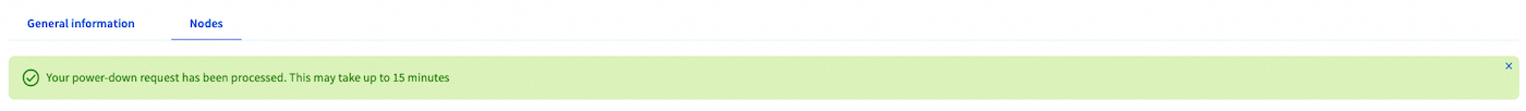

A confirmation banner will appear.
Power down confirmation

Uninstall the node
Once the node is powered down, click the more options ... button and select Uninstall.
Uninstall button

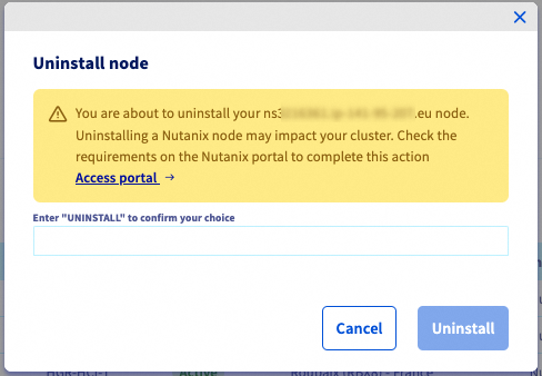

A warning pop-up will appear. Type the required term and click Uninstall.
Uninstalling a Nutanix node may impact your cluster. Please check the requirements on the Nutanix portal to complete this action.
Uninstall warning

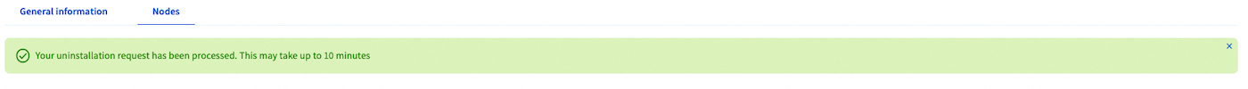

Uninstall confirmation

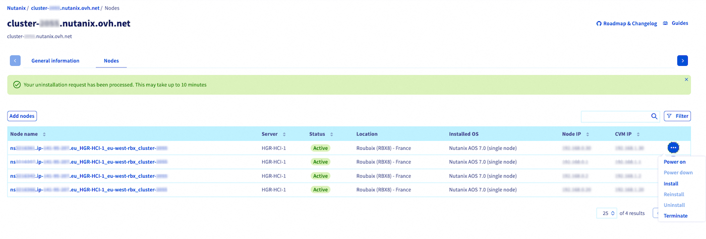

Remove the node
Once the node is uninstalled, click the more options ... button and select Terminate.
Remove the node
A warning pop-up will appear. Type the required term and click Confirm.
Your suspended service will appear in your nodes list for approximately one week before being permanently deleted. This allows you to reactivate the service if you need to reverse the deletion.
