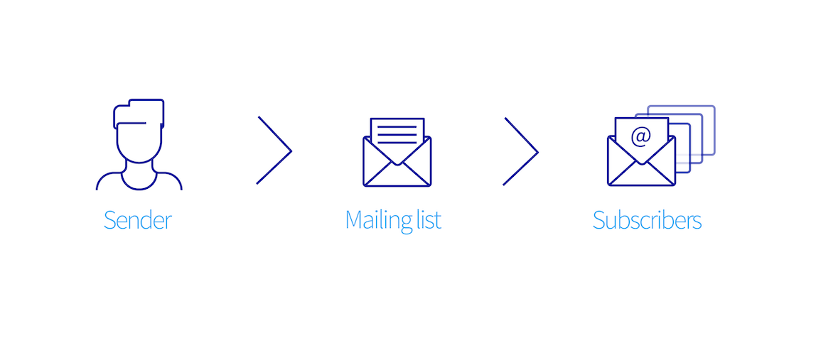

Non-moderated mailing list
emails
The sender sends an email to the mailing list, and the subscribers receive the email directly.

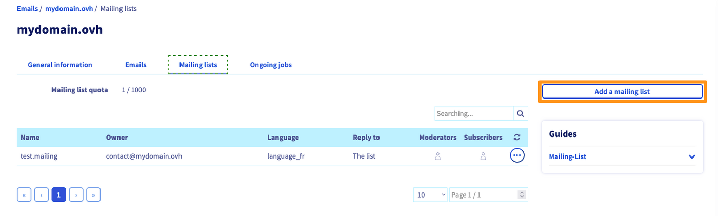

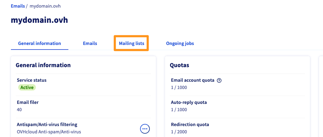

To create a mailing list, go to the Mailing lists tab for your email service.
emails
If you have already created mailing lists, they will be listed in the summary table. In the example below, a mailing list has already been created.

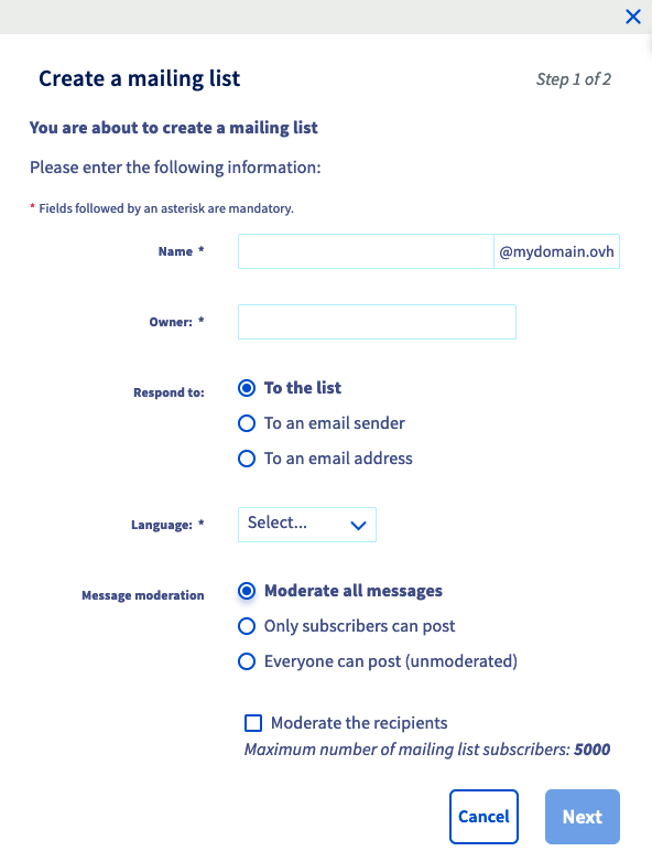

To create a new mailing list, click Add a mailing list.
emails
Fill in the form with the information listed in the table below:
InformationDescription
NameThe name of your mailing list.
OwnerEnter the email address of the mailing list owner (they will also be the moderator).
Reply toDefine the recipients when a subscriber replies to the mailing list.
LanguageSelect the language for the automatic subscribe and unsubscribe messages for your mailing list.
Moderate all emailsThe owner or moderator must approve any emails sent to the mailing list.
Only subscribers can postRestricts the mailing list, so that only subscribers can send to it.
Everyone can post (non-moderated)Emails sent to the mailing list are sent directly to subscribers, without validation.
Moderate recipientsThe owner or moderator must approve subscriptions to the mailing list.
emails
Maximum number of mailing list subscribers:
  • 5,000 if emails are moderated
  • 250 if emails are not moderated

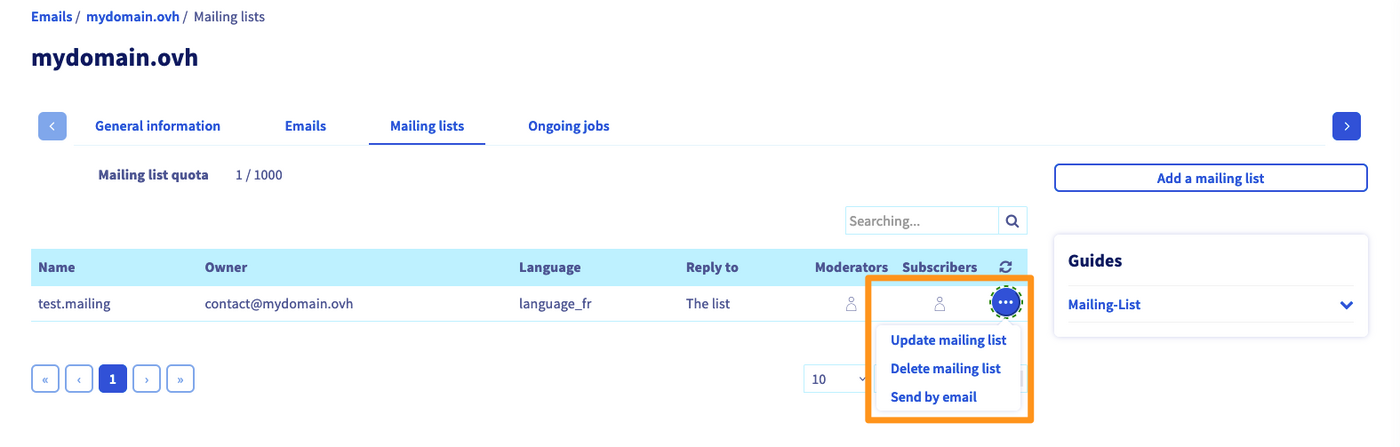

Manage mailing list options
To modify the mailing list options, click the ... to the right-hand side of it. You can then update the options, delete the mailing list, or share the list of subscribers via email.

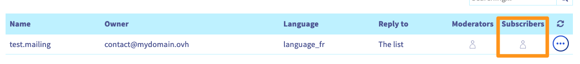

Manage subscribers
To manage subscribers to your mailing list, click on the silhouette next to the “Subscribers” column.

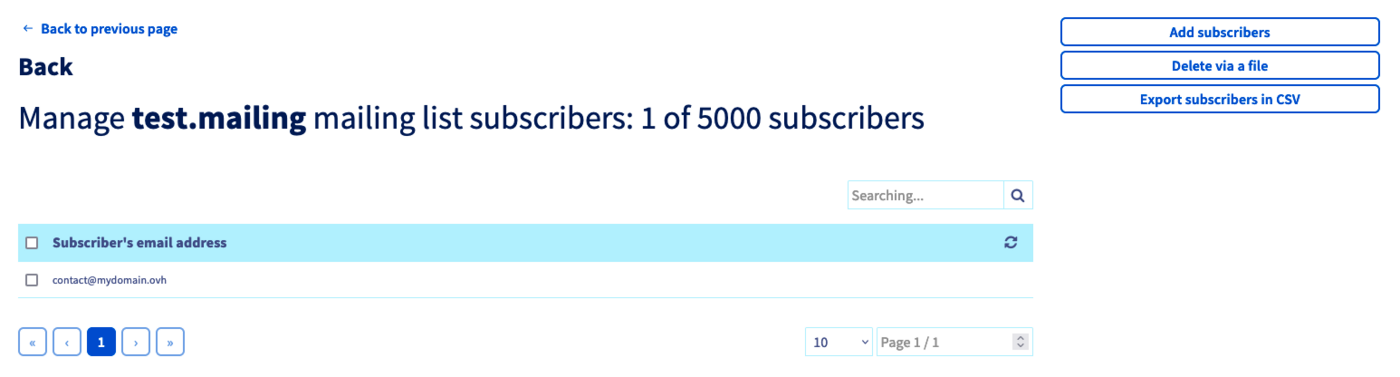

The following window will pop up:
emails

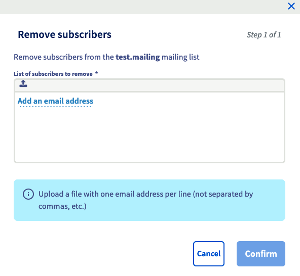

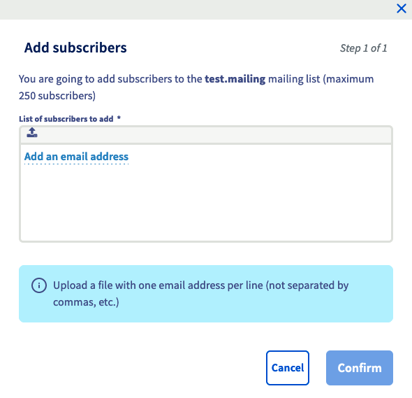

Add/Remove subscribers
Add subscribersRemove subscribers
Click Add subscribers on the right-hand side.Click Remove via a file on the right-hand side.
emailsemails
There are two ways of adding and removing subscribers:
  • entering the email address manually by clicking Add an email address
  • importing a text file containing one email address per line, by clicking on the upload icon next to the manual entry button
Export your list of subscribers to a CSV file
Click Export subscribers in CSV format to generate a CSV file containing all of your subscribers. This option is not available in our example, because no subscribers have been added.

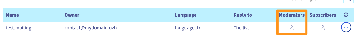

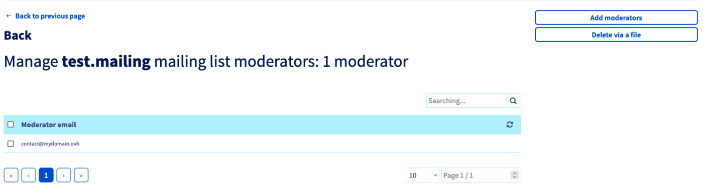

Manage moderators
To manage moderators on your mailing list, click on the silhouette in the “Moderators” column.
emails
emails

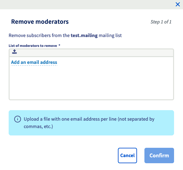

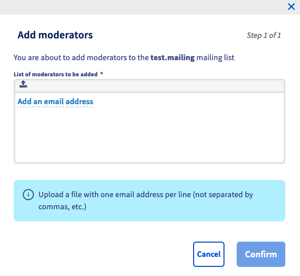

Add/Remove moderators
Add moderatorsRemove moderators
Click Add moderators on the right-hand side.Click Remove via a file on the right-hand side.
emailsemails
There are two ways of adding and removing moderators:
  • When several moderators are defined on a mailing list, only one moderator needs to validate an email to send to subscribers.
  • When a moderator sends an email to the mailing list, only they receive the moderation email.
Depending on the number of subscribers you need to add, this may take some time to do.
