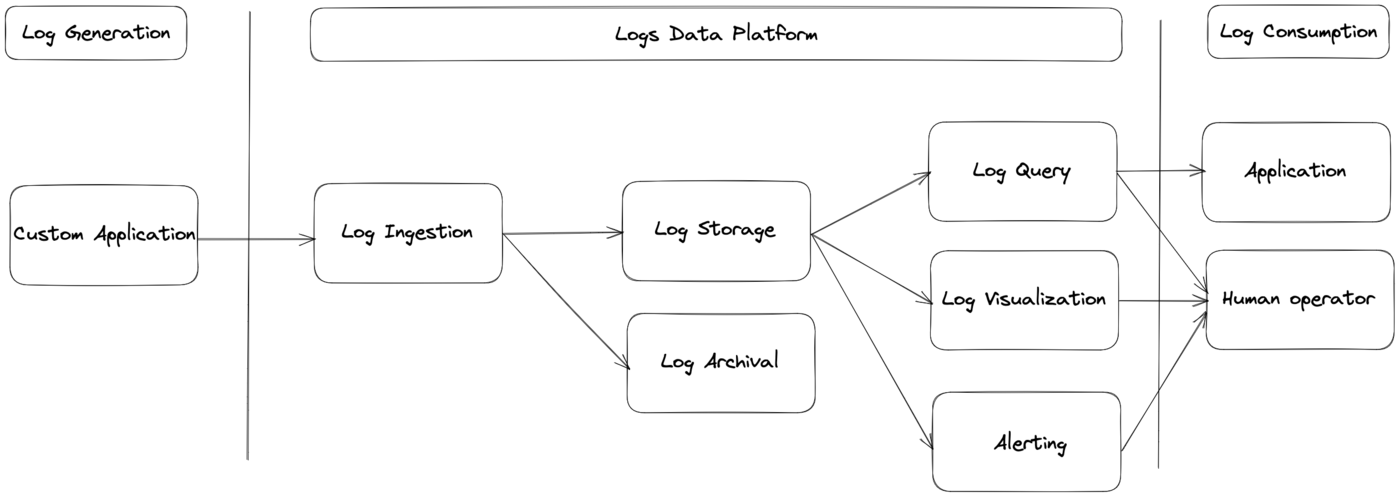

Summary
To help you visualize the information of this guide, the picture below should sum up what each component from Logs Data Platform brings you:
 summary of the concepts described in this guide.
