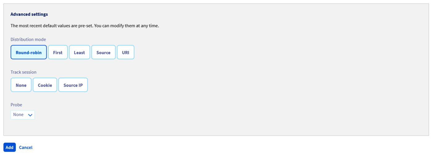

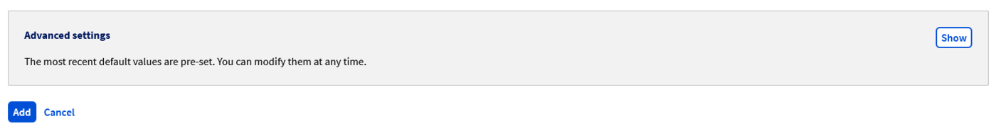

From the OVHcloud Control Panel
You can configure probes when you add or modify a server farm, in advanced settings.
You will then have access to the configuration for the probe type.

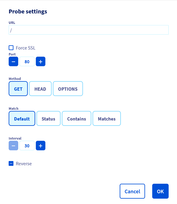

If the probe type you have selected allows it, you can configure advanced settings that are specific to that probe.
A new configuration window will appear, with the probe’s settings.
