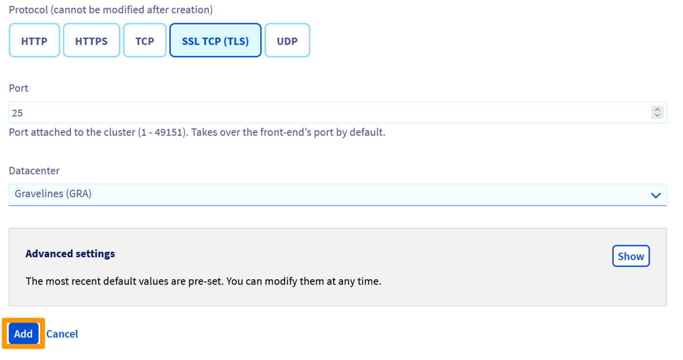

A TCP server farm must be added to the service; this component manages traffic balancing across the servers.
Via the OVHcloud Control Panel
In the Farms tab for servers, click on the +TCP/TLS button.
Fill in the fields. The mandatory fields for a basic configuration are Port and Zone. For SMTP, port 25 is used. If no ports are specified, your OVHcloud Load Balancer will automatically use the same port as the corresponding front-end.
Optionally, you can add an SMTP probe on your farm.
Add a server farm via the Control Panel
Click on Add once you have filled in the fields.
Your server farm should appear in the list, in the Farms tab.

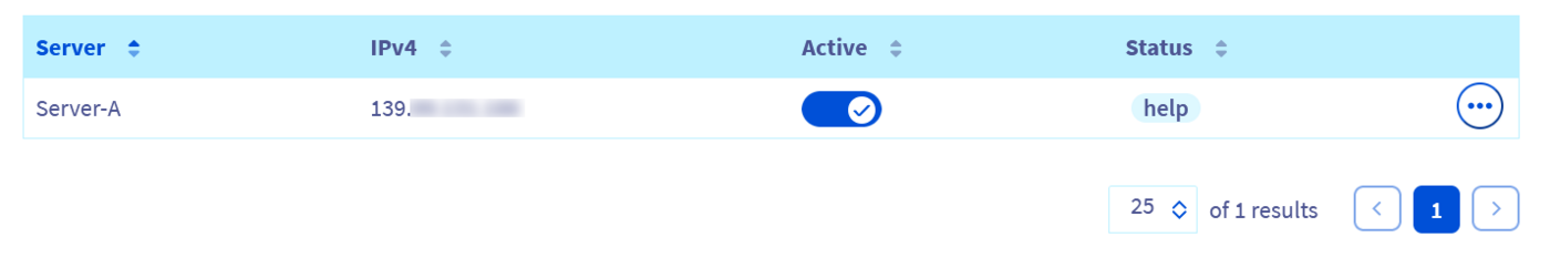

In the Farms tab, select the farm you want to add a server to by clicking on the corresponding line. The list of servers already configured in the farm will appear beneath the list of farms, along with the Add a server button. Click this button to add a new server.
The mandatory fields are the IPv4 address, Status, and ProxyProtocol version. If a server port is configured, it will override the port defined in the farm. To keep the configuration as standard as possible and easy to maintain, we recommend only using this parameter in advanced cases.
It is important to configure ProxyProtocol in version v1 so that you can retrieve the real source IP on your SMTP service. Postfix is compatible with this protocol.
Add a server to a farm.
Your server should appear in the server list, in the Farms tab, just below the list of farms.
Details of the server created.

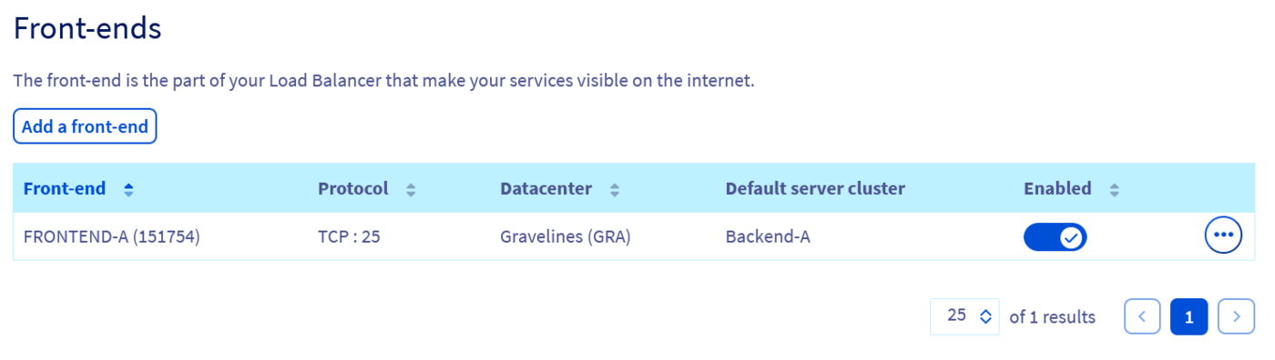

Go to the + Front-ends tab, and click +TCP/TLS.
Fill in the fields. The mandatory fields for a basic configuration are Port (25 for a standard SMTP service), Zone, Default farm and Probe (if a probe was configured on your farm). If you want your service to be available across several ports at once, you can specify a list of ports, separated by commas, or a port range, in the format "-".
If you have routed Additional IPs to your OVHcloud Load Balancer service, you can also attach a front-end to one or more specific Additional IPs.
Ensure the farm you created earlier is specified as the “default farm”.
Add a front-end
Click Add once the fields are filled.
Your front-end must appear in the list, in the Front-ends tab.
Details of the front-end created

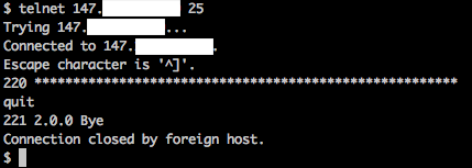

Confirmation
Upon completing these steps, you will have a functional Load Balancer service for your SMTP servers. The service status can now be checked by requesting your IP Load Balancer as an SMTP server.
Connection to SMTP via telnet
