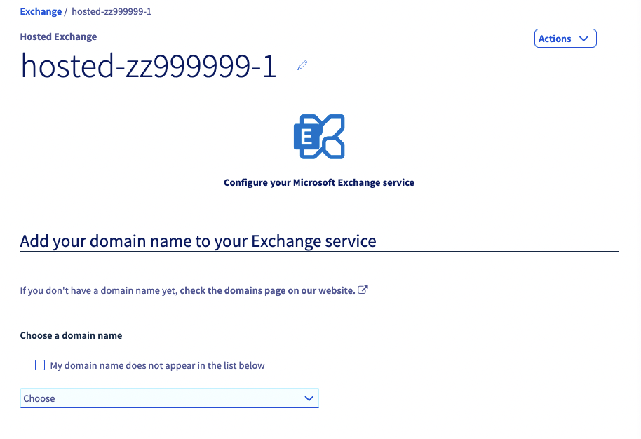

Once your Hosted Exchange service has been created and is available, select it in the OVHcloud Control Panel.
The name of a Hosted Exchange service in your OVHcloud Control Panel begins with hosted-, contains part of your NIC handle and ends with a figure (1 for the first Hosted Exchange service installed, 2 for the second, etc.).
Configure your service for the first time
Since you have not used your service yet, you will need to configure it for the first time. Once you have done so, you can then use your new Exchange email addresses.
To do this, when you first access the management interface for your Hosted Exchange service, a configuration assistant will open. To get started, click the Start button.
With this configuration assistant, you can makes several changes depending on your situation:
Choosing a domain name
Choose one of your domain names from the list, or select the check box My domain name is not in the list below to enter a domain name that is not managed in your Control Panel, but that you can configure.

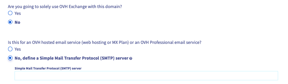

Are you going to only use the OVHcloud Exchange solution with this domain name?
The question "Are you going to use OVHcloud Exchange only with this domain?" will determine the type of configuration for your domain name.
  • If you use an Exchange offer alone or with other OVHcloud email offers, the configuration can be done automatically, or manually using only OVHcloud email servers.
  • If you are using your Exchange solution as a complement to an external email service to the OVHcloud email offers, you will be asked to enter the URL of your external email service’s incoming server under the heading (SMTP) server.

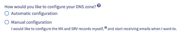

How do you want to configure your DNS zone?
  • Automatic configuration: The domain name entered will be automatically configured in its DNS zone, if it is managed by OVHcloud on the same NIC handle as your Exchange service.
  • Manual configuration: The domain name is not managed in the same control panel as your platform, it is managed by another domain name provider, or you simply want to configure it yourself.
    You can then find the values to enter at the end of the configuration process, or in the Associated domains section for your platform.

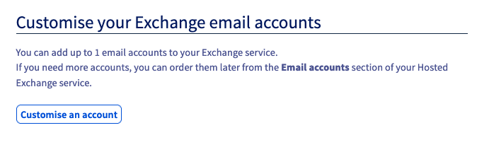

Configure Exchange accounts
Determine the name of your Exchange email addresses, and add additional information.

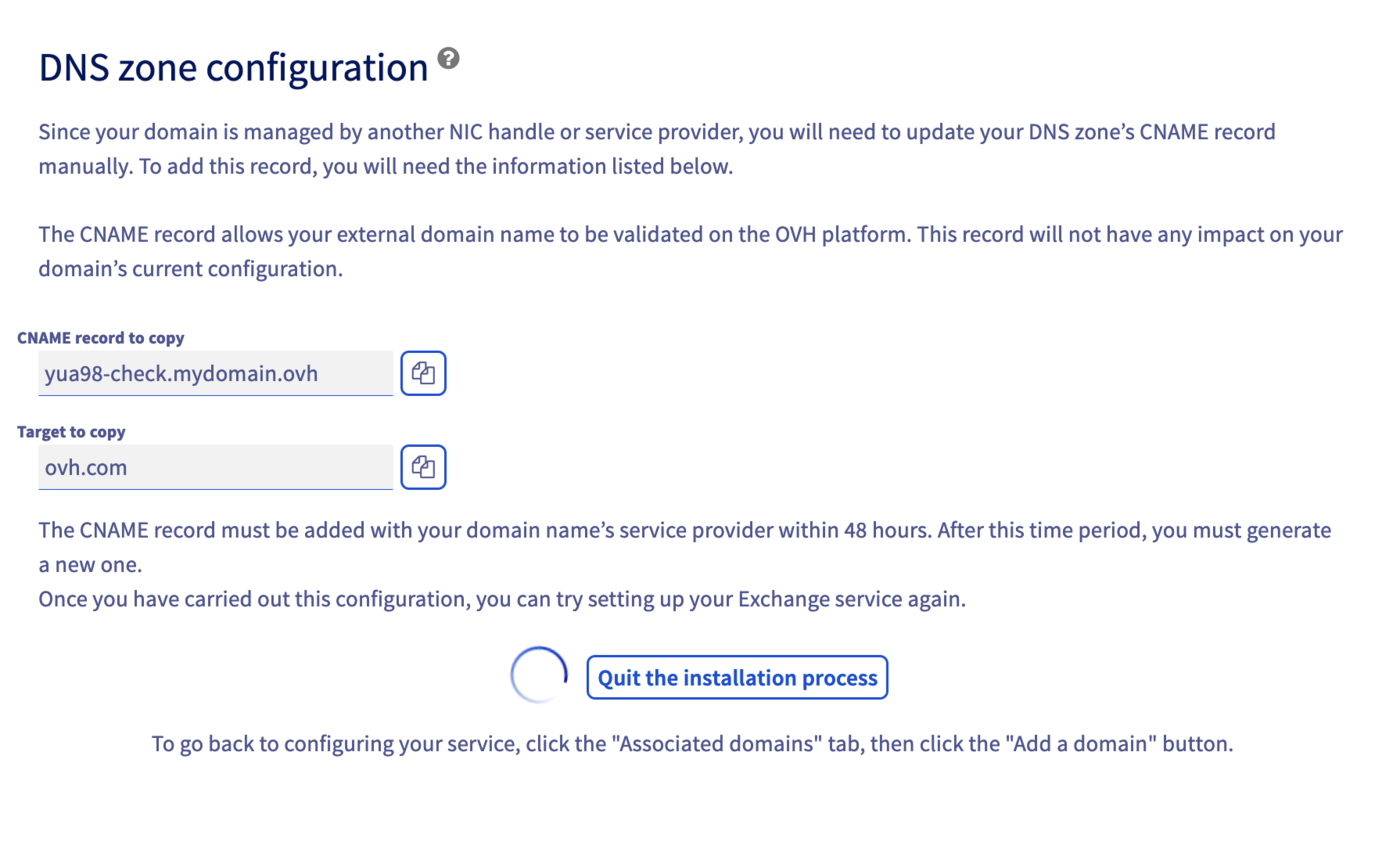

  • If you configure your Exchange platform with a domain name that is not managed on the same control panel as this platform, or with another domain name provider, you will see the following window:
email
This window will prompt you to add a CNAME record to the domain name’s DNS zone. The purpose of this entry is to check that you are actually managing this domain name.
Without this validation by CNAME record, you cannot use the platform with this domain name.

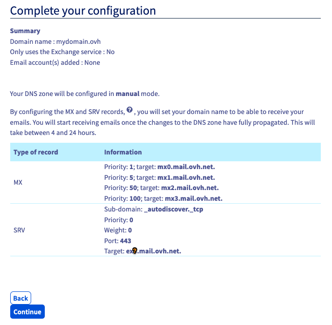

  • If you configure your Exchange platform with a domain name that is not managed on the same control panel as this platform, that is managed with another domain name provider, or if you have chosen to manually configure your domain name, the following window will appear:
email
Here, you will find the values to enter into your DNS zone. The MX records correspond to the receiving servers of your emails. The SRV field corresponds to the automatic configuration of your email addresses.
You can find the DNS zone configuration details for your email service on our Add an MX record to your domain name’s configuration page.

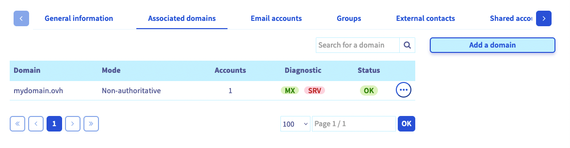

To add a new domain name, select the Hosted Exchange service concerned in your OVHcloud Control Panel, and click on Associated domains. You will see a table showing all of the domain names currently configured, or about to be configured on your service. To add new ones, click on the Add a domain button, then follow the various steps of the process.
To find out more, please refer to this guide on Adding a domain name to an Exchange service.
If a domain name requires a specific action for its configuration, a red box will appear in the Diagnostic column of the table. By clicking on it, you will see the modifications that need to be made. If this domain name does not use OVHcloud configuration (its DNS servers), you will need to carry out the modifications in the interface you use to manage your domain name’s configuration.

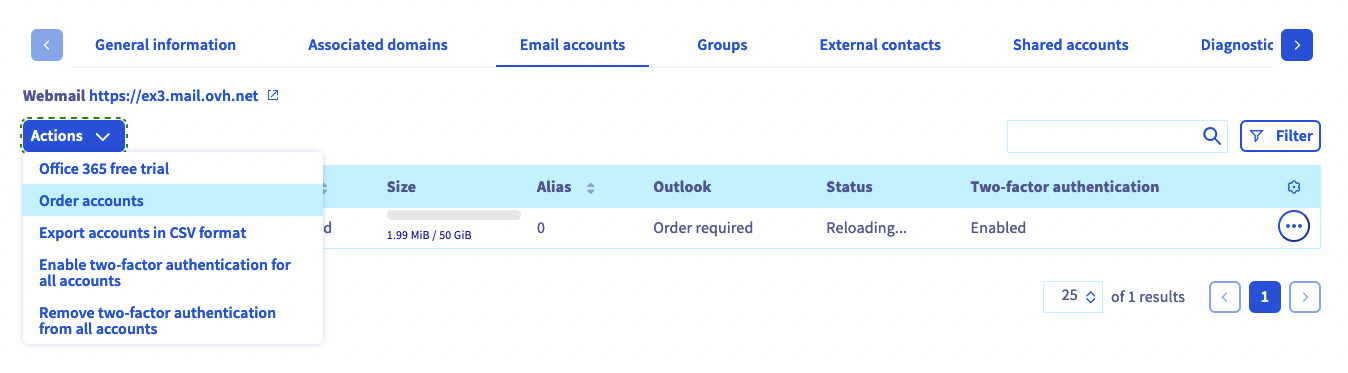

To do this, click on the Hosted Exchange service concerned in your OVHcloud Control Panel, then on Email accounts. You will see a table showing all of the accounts currently configured, or about to be configured on your service.
The accounts that have not yet been configured configuration will appear in the table as “@configureme.me”. To configure them, click on the pencil icon, then follow the steps.
Repeat this step as required, depending on the number of accounts you have. You can order new ones by clicking on the Actions button, then Order accounts.
