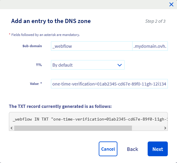

  • If "TXT" records are present for the domain name alone (e.g. mydomain.ovh.) and for its subdomain in "www" (e.g. www.mydomain.ovh.), you must delete them so that they do not conflict with the CNAME record that you enter in step 4. Click the ... button to the right of the table row for your domain name with the subdomain "www", then click Delete record.
  • You must create a record of type "TXT". Click on the Add an entry button in the top right-hand corner of your screen and select the TXT "Pointer record". Enter the Sub-domain with the value _webflow in the Target field, and enter the value in the Site settings > Publishing tab > Production section of your Webflow account, of type one-time-verification=XXXXXXXX. Replace XXXXXXXX with the value present in your Webflow account.
    dnszone
    Click Next to validate your TXT record and proceed to step 4.

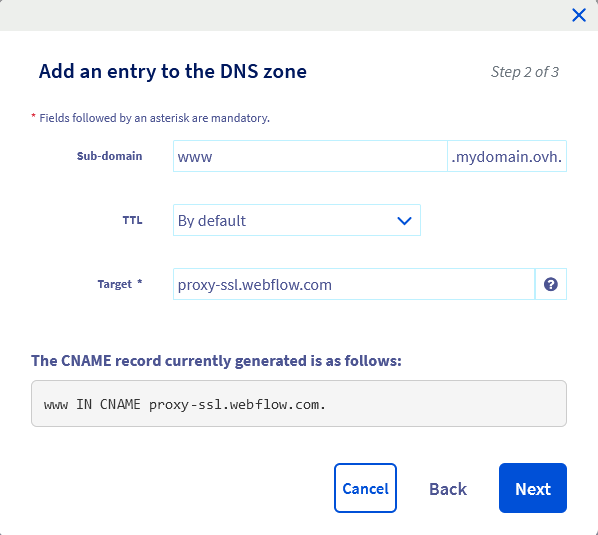

  • Click the ... button to the right of the table row corresponding to your subdomain in "www." (e.g. mydomain.ovh.), then click Modify record.
  • If you do not have an existing "CNAME" record, click the Add an entry button in the top right-hand corner of your screen, and select the CNAME "pointer record’. Enter Sub-domain with the value www and enter proxy-ssl.webflow.com in the Target field.
    dnszone
    Click Next to validate your "CNAME" record.
