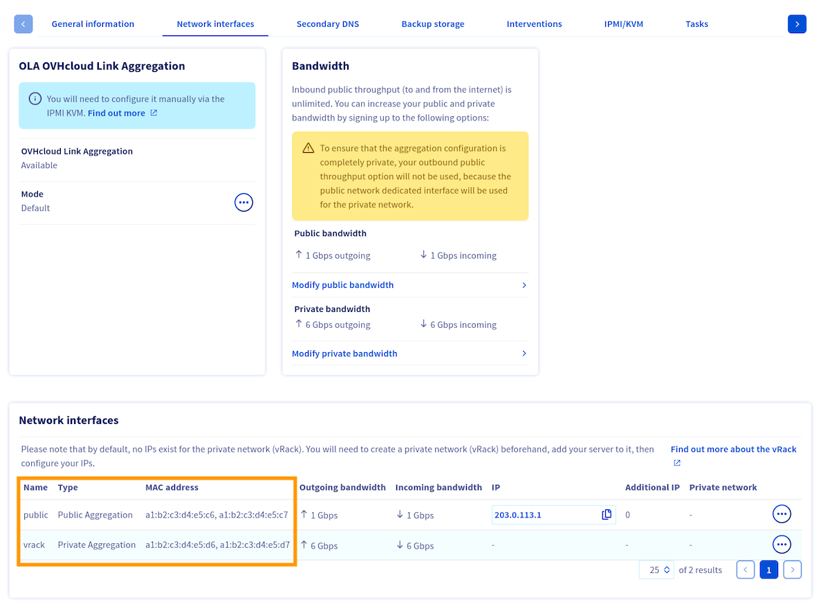

Retrieving MAC addresses
Switch to the tab Network Interfaces and take note of the MAC addresses for each interface (public/private) which are displayed at the bottom of the menu.
OVHcloud Control Panel
Please note that the MAC address of the main public interface is the one receiving DHCP offers, both in the server's operating system and in rescue mode. This interface handles public connectivity in the default configuration.
Additionally, the MAC address of the main private interface is the one with the lowest value. In the example image above, this is the address a1:b2:c3:d4:e5:d6.
