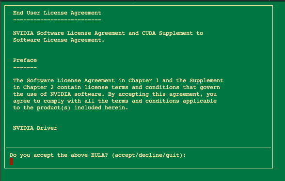

Accepts the process

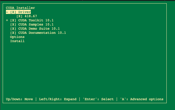

And then select all the components to install
cuda step 2
