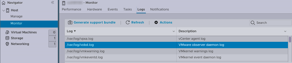

You can view the access log history in the following files via SSH:
  • /var/run/log/vobd.log contains the logs that can be used for monitoring and troubleshooting:
2023-02-13T16:22:22.897Z: [UserLevelCorrelator] 410535559us: [vob.user.account.locked] Remote access for ESXi local user account 'root' has been locked for 900 seconds after 6 failed login attempts.
2023-02-13T16:22:22.897Z: [GenericCorrelator] 410535559us: [vob.user.account.locked] Remote access for ESXi local user account 'root' has been locked for 900 seconds after 6 failed login attempts.
2023-02-13T16:22:22.897Z: [UserLevelCorrelator] 410535867us: [esx.audit.account.locked] Remote access for ESXi local user account 'root' has been locked for 900 seconds after 6 failed login attempts.
  • /var/run/log/hostd.log contains ESXi host logs (tasks, access to the web interface, etc.):
2023-02-21T08:44:19.711Z error hostd[2101004] [Originator@6876 sub=Default opID=esxui-d48c-26a4] [module:pam_lsass]pam_do_authenticate: error [login:root][error code:2]
2023-02-21T08:44:19.711Z error hostd[2101004] [Originator@6876 sub=Default opID=esxui-d48c-26a4] [module:pam_lsass]pam_sm_authenticate: failed [error code:2]
2023-02-21T08:44:19.712Z warning hostd[2101004] [Originator@6876 sub=Default opID=esxui-d48c-26a4] Rejected password for user root from xxx.xxx.xxx.xxx
2023-02-21T08:44:19.712Z info hostd[2101004] [Originator@6876 sub=Vimsvc.ha-eventmgr opID=esxui-d48c-26a4] Event 175 : Cannot login root@xxx.xxx.xxx.xxx
All this information is also available through the web administration interface. Click the Host menu and navigate to the Monitor section, and then click Logs.

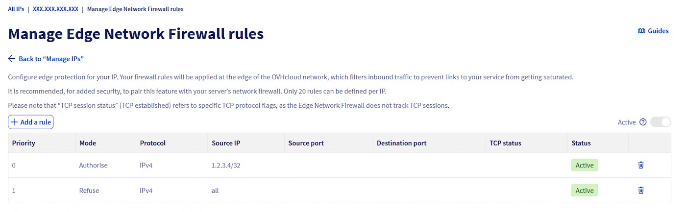

The Edge Network Firewall solution
As a reminder, the Edge Network Firewall is not taken into account within the OVHcloud network. As a result, the configured rules do not affect connections from this internal network.
You can enable and use our Edge Network Firewall filtering solution. This solution will allow you to easily manage legitimate access, in addition to the access you have set up through your ESXi system.
It will also prevent you from unexpectedly locking your administrator account in the event of an attack.
It is recommended that you filter legitimate access in this way:
  • Rule 1 (Priority 0) allows trusted external networks to access your ESXi system.
  • Rule 2 (Priority 1) blocks everything else.

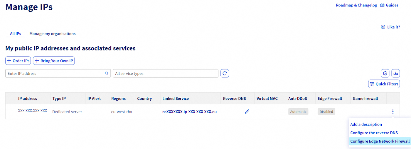

You can access the Edge Network Firewall settings in the OVHcloud Control Panel, by selecting Network, then choosing Public IP Addresses under "Public Network". There, you can find your dedicated server by searching for its IP address.
Network_Firewall
To the right of the table, click the ... button corresponding to your dedicated server, then select Configure Edge Network Firewall.
Network_Firewall

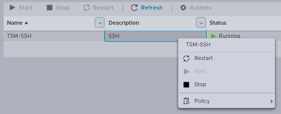

Click the Host menu and navigate to the Manage section, then click Services.
In the list, find the TSM-SSH service and right-click on the associated line.
Stop the service by clicking Stop:
services_ssh
Select the Policy, then edit it as shown in the example.
Choose the Start and stop manually option to prevent the service from being active when the server starts.
services_ssh

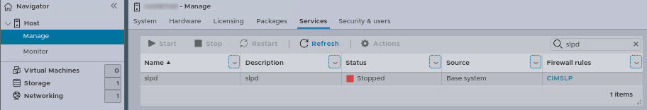

Apply the same settings for the slpd service:
services_slp

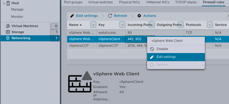

Firewall rules

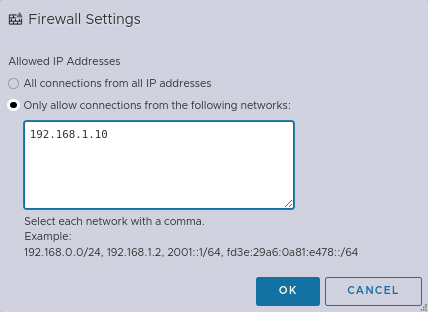

Click the Networking menu, then Firewall rules, and choose Edit settings for each service you want to protect:
rules
Edit the rule to add only IP addresses or networks that need access to your ESXi system.
Example that only allows connections from IP 192.168.1.10:
custom
