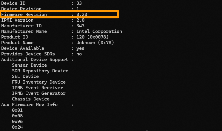

Check the BMC firmware version using the following command:
sudo ipmitool mc info
bmc
  • If the firmware version is equal to or lower than 1.14, please contact our support team by creating a support ticket via the OVHcloud Help Center to request a firmware update.
  • If the version is higher than 1.14, no action is required.

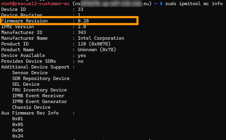

Once your server is restarted in rescue mode, install the ipmitool package.
root@rescue12-customer-eu (nsxxxxx.ip-xx-xx-xx.eu) ~ # apt install ipmitool -y
Next, check the firmware version:
ipmitool mc info
bmc
