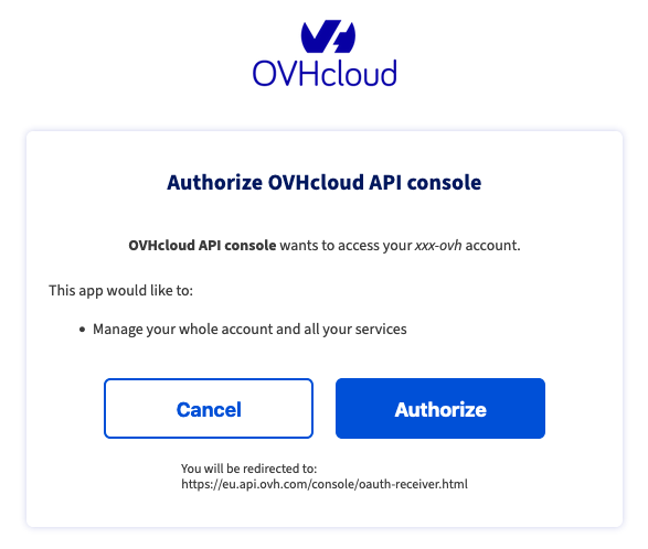

To use the APIs on your products, you must sign in to this site using your OVHcloud credentials.
  • Click Authentication in the upper left.
  • Select Login with OVHcloud SSO.
  • Enter your OVHcloud credentials.
  • Click Authorize to allow performing API calls through the console.

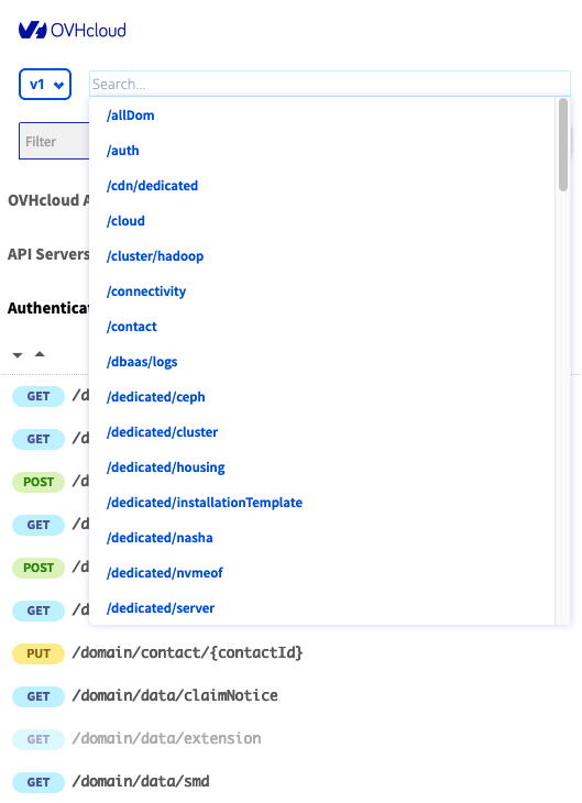

Explore available products on APIs
You can see the list of OVHcloud products that can be managed with APIs on the left menu. This list is sorted alphabetically.
API
For example, to view the domain name APIs, click /domain in the list.
After you click the product, a list of the product's APIs appears below.
API
You can also use the selector on the left of the list of products to switch between the /v1 and /v2 branches of the API. If you're not familiar with the API branches, you can read the following documentation about the API v2.

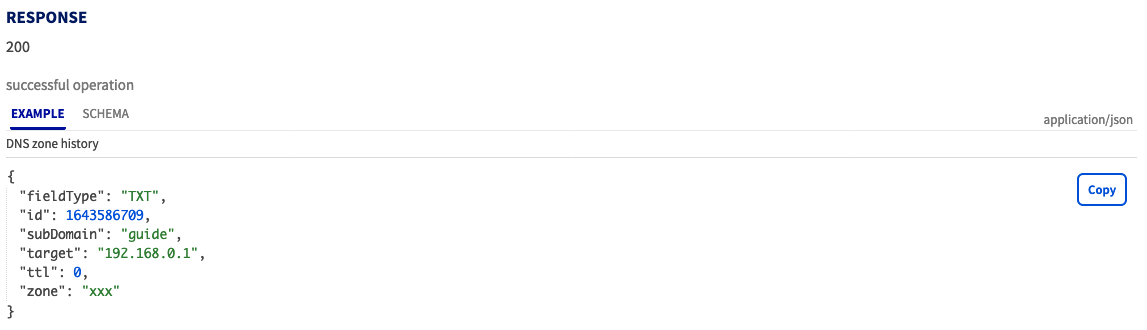

Once you have set the parameters, you can launch the API by clicking EXECUTE.
The Response tab displayed will give you the API execution report.

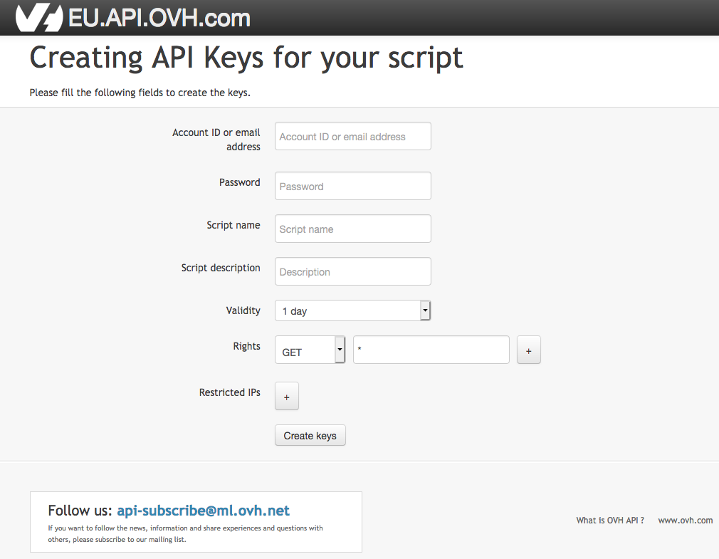

Create your app keys
Any application that wants to communicate with the OVHcloud API must be declared in advance.
To do this, click the following link: https://auth.eu.ovhcloud.com/api/createToken.
Fill in your OVHcloud customer ID, password, and application name. The name will be useful later if you want to allow others to use it.
You can also add a description of the application and a validity period.
The Rights field allows you to restrict the use of the application to certain APIs.
In order to allow all OVHcloud APIs for an HTTP method, put an asterisk (*) into the field, as in the following example where the GET method is allowed for all APIs:
