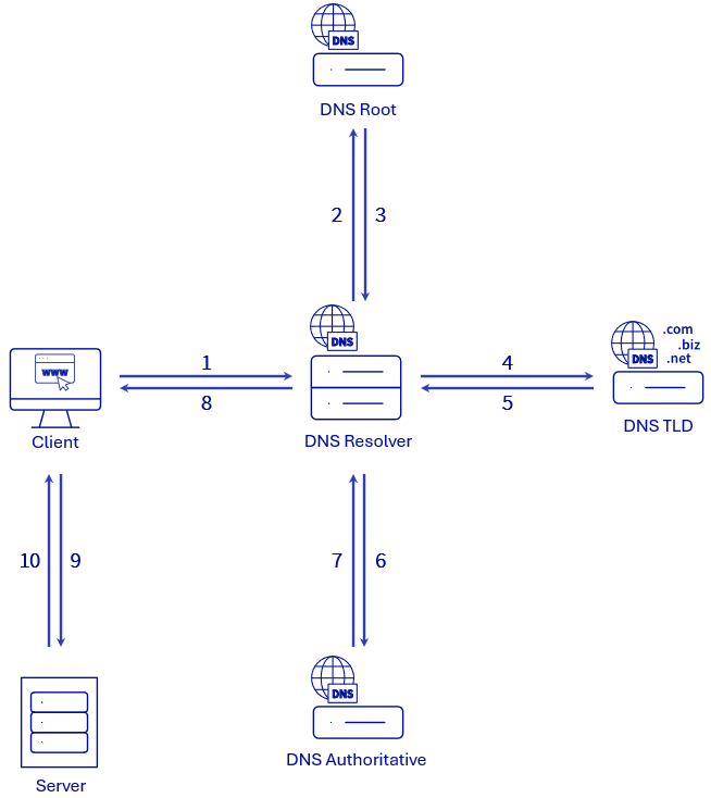

DNS resolution
There are 4 types of DNS servers.
Below is a table showing these 4 types of DNS servers and how they interact. The examples given in the table will be based on a DNS request sent from a web browser to find the IP address of the website domain.tld.
DNS Server TypeDescriptionExample
DNS resolver (or recursive DNS)The first server to receive the DNS request from a client (web browser, email software, and so on). This step is represented by step 1 of the diagram above. This server acts as a gateway between the client and the rest of the DNS network. It queries the other three types of DNS server until it retrieves the IP address, requested by the DNS request, from the reference DNS server. The client sends the DNS query to find the IP address of the domain name domain.tld.The web browser sends a DNS query for the IP address of the domain name domain.tld. This will show you the server hosting the website linked to the domain name domain.tld.
Root DNS serverContains a directory for all TLDs (TLDs such as .com, .net, .uk, etc.). It will inform the DNS resolver of the address of the DNS TLD server corresponding to the extension present in the DNS query requested by the client (steps 2 and 3 of the above schema).The DNS resolver forwards the DNS query it has received for domain.tld to the root DNS server and receives in response the address of the DNS TLD server that manages the .tld extension.
DNS servers for extensions/top-level domain names (TLD DNS)Contains a domain name directory for a given extension. It will inform the DNS resolver of the reference DNS server address corresponding to the domain name present in the DNS query requested by the client (steps 4 and 5 of the above schema).The DNS resolver then forwards the DNS query it has received for domain.tld to the TLD DNS server that manages the extensions in .tld and receives in response the address of the reference DNS server that manages the DNS zone of the domain name domain.tld.
Authoritative DNSThe last DNS server queried by the DNS resolver (steps 6 and 7 in the diagram above). It contains the active DNS zone for the domain name present in the DNS query requested by the customer. The content of this type of DNS server will be detailed later in this guide.The DNS resolver then forwards the DNS request it received for domain.tld to the authoritative DNS server that manages the DNS zone for the domain name domain.tld, and in response receives the IP address (example 203.0.113.0) of the server that hosts the website for the domain name domain.tld.
Once the DNS resolver has retrieved the IP address of the server searched via the DNS request requested by the client, it returns this IP address to the client (step 8 of the diagram above).
The client then sends another request directly to the server associated with the IP address retrieved using the DNS resolution (step 9 of the diagram above). This allows them to connect to it or retrieve the elements they need to resolve this second request (step 10 of the diagram above). In our example, the client (web browser) queries the server with the IP address 203.0.113.0 to retrieve the content to be displayed for the domain.tld website.

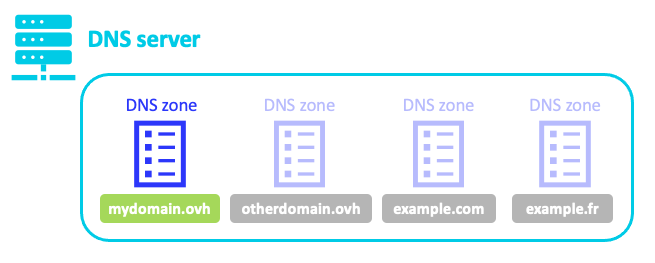

Contents of a DNS server (Authoritative)
A DNS server (Authoritative) contains a domain name directory that can have different extensions (TLDs).
For each domain name in the directory, there is a DNS zone associated with it, which contains the DNS configuration to be applied to the domain name.
A DNS zone contains technical information, called DNS records.
As a result, the DNS servers (Authoritative) must be registered (with a domain name registrar) in order to use the DNS zone they host.
