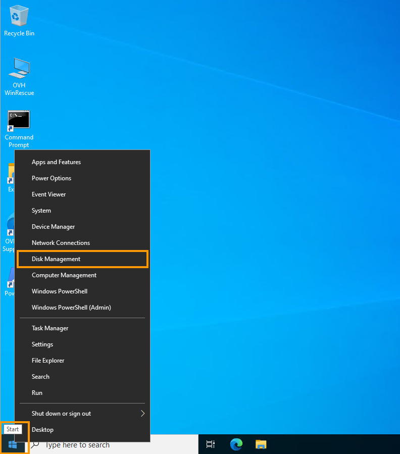

1. Access disk management
Right-click the Start menu and select Disk Management.
disk_manager_menu

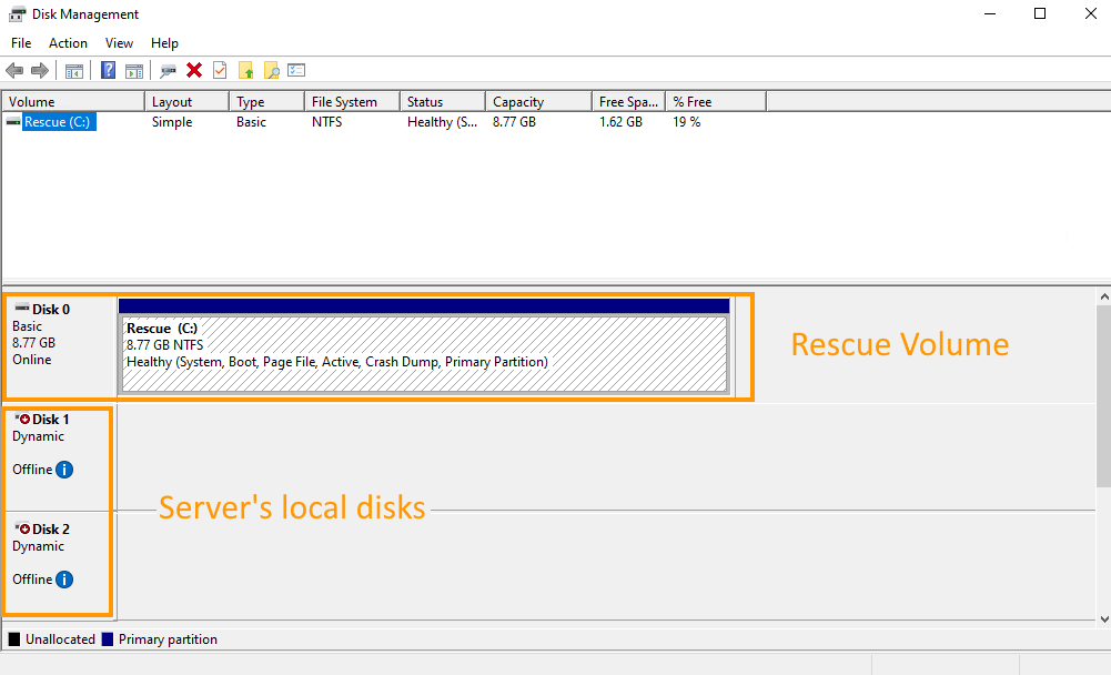

You can then see the disks and volumes of the server.
disk_manager_window
Your server's Windows disk is probably Disk 1. You must import it to be able to access it.
Please note that if you have several disk groups, the number of the Windows disk may vary. You may have to import several disks to get the Windows one.
You also have to import the second disk to properly import your software RAID volume.

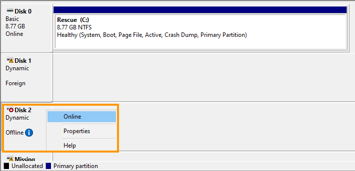

2. Import local disks

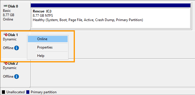

Right-click Disk 1 and select Online.
disk_import_disk1
Do the same thing for the second disk (Disk 2) to properly import your software RAID volume.
Right-click Disk 2 and select Online.
disk_import_disk2

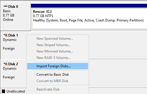

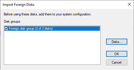

Disks are now seen as "Dynamic" and "Foreign".
Right-click Disk 1 again and select Import Foreign Disks.
disk_import_menu

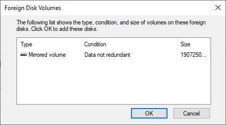

Click OK twice.
disk_import1
disk_import2

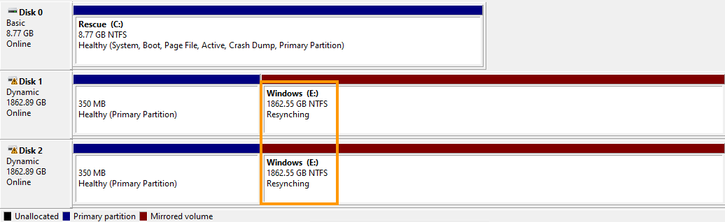

You can see that the local disk is now accessible and that the Windows disk is drive (E:) (spreading on two software RAID disks with Mirrored volume type).
disk_import_sync
In this example, the volume status is "Resynching" because the server was hard-rebooted into rescue mode. This is an expected status and it is not caused by the rescue mode itself.
This will not affect data on the volume and resynchronisation will continue once the server is rebooted into its installed OS.

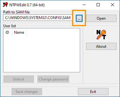

To reset passwords, the tool NTPWEdit is required.
Once you are connected via Remote Desktop, open the browser and download it from its official website.
Navigate to the folder where the downloaded ZIP file is located and extract its content.
Next, open the ntpwedit64 executable to start the application.
In this interface, you can manipulate the SAM file in order to clear the admin user's password.
You must browse the local Windows drive to find your system's SAM file.
Click the three dots button (...) to browse the drive containing your server's local Windows folder.
It usually is the Windows (E:\) drive.
ntpwedit1

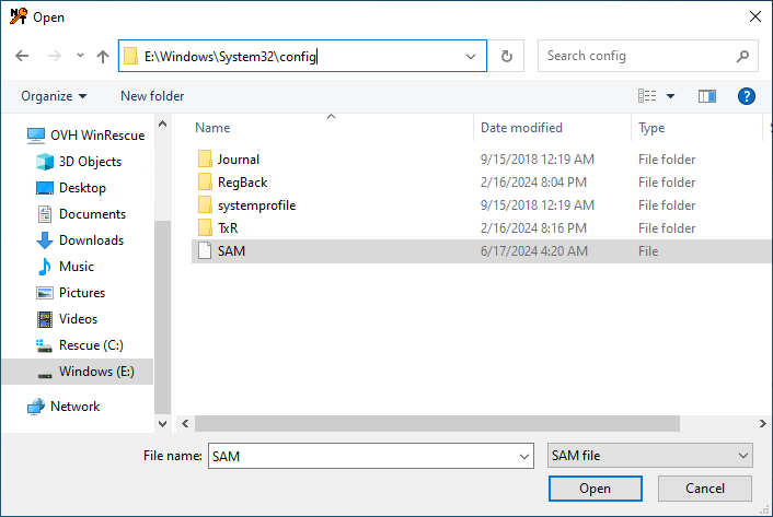

Browse to E:\WINDOWS\SYSTEM32\CONFIG\.
Select and open the SAM file to display the user accounts by clicking Open.
ntpwedit_sam

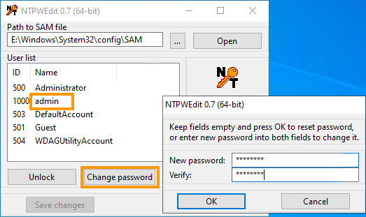

Select the user account "admin" and click on Change password.
ntpwedit2
In the popup window, enter your new password in both fields and click OK.
The new password will be accepted regardless of any password complexity.
Keep in mind that this password will allow remote connection to the server once rebooted on its operating system.
Finish by clicking Save changes and Exit.

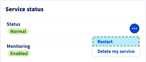

Step 3 - Reboot the server
First, change the netboot back to "Boot from the hard disk" in your OVHcloud Control Panel (see step 1).
Then restart the server from the Control Panel.
Click the ... button near "Status" in the "Service Status" section and click Restart.
