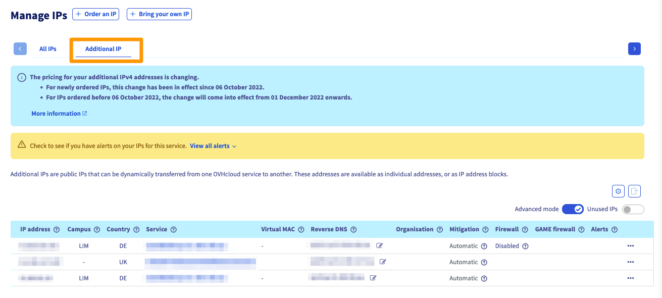

Log in to the OVHcloud Control Panel, open the Network menu in the left-hand sidebar and click Public IP Addresses.
Click the Additional IP tab.
Additional IP tab in OVHcloud Control Panel

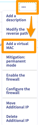

Next, locate your Additional IP address in the table and click the ... button to open the menu. Select Add a virtual MAC.
Context menu with Add a virtual MAC option

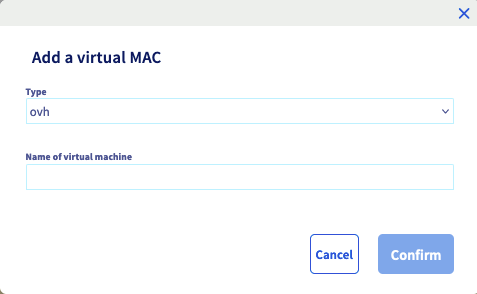

Select ovh from the Type dropdown box, type a name in the Name of virtual machine field, and then confirm your options.
Virtual MAC type and name configuration dialog

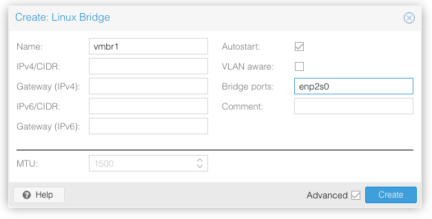

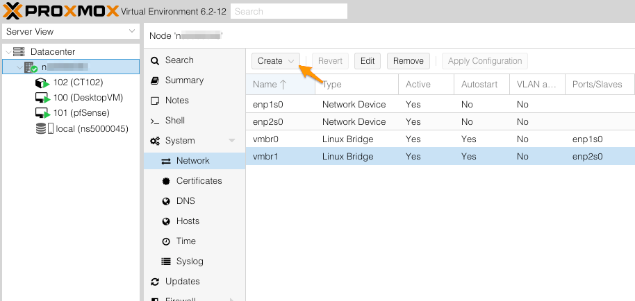

Since pfSense or most routers require two network interfaces to separate the public and private network, it’ll be necessary to have two bridge interfaces on your hypervisor. In this demonstration we’re using Proxmox VE 6.
In this example, we have two interfaces enp1s0 and enp2s0 but the interface enp1s0 is already bridged with the interface with vmbr0. So we will need to make an additional bridge interface vmbr1 with enp2s0:
Proxmox network interfaces list with existing bridge
Creating a second bridge interface vmbr1 in Proxmox
Note that if your server doesn’t have a second network interface, it’s not necessary to bridge it to an interface, the bridge will work fine but would only be able to route internally on the server. Using an interface on a network bridge can allow you to route to other virtual machines, dedicated servers, Public Cloud instances and even Hosted Private Cloud infrastructures using vRack.

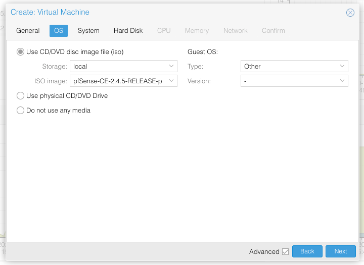

  • Under the OS tab, choose: Other OS type

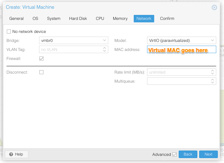

  • First item under the Network tab, make sure the bridge is vmbr0
  • Second item under the Network tab, Model should be: VirtIO (paravirtualized)

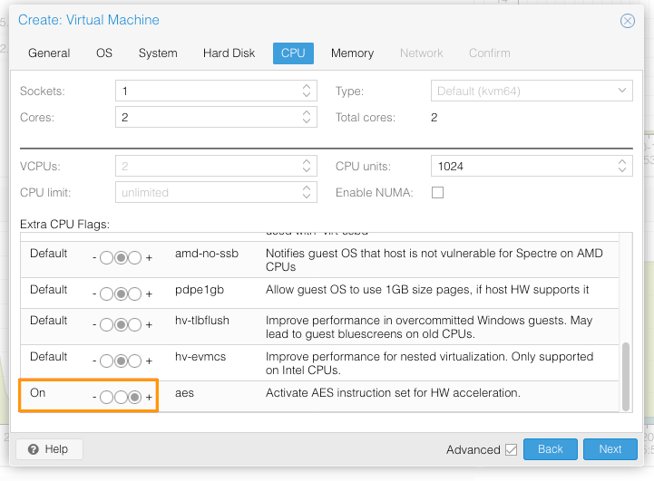

  • If your CPU has the AES instruction set, this should be enabled
Proxmox VM creation wizard OS type selection
If your CPU has the AES instruction set, it must be enabled (from the CPU tab)
Enabling AES instruction set in VM CPU settings
When you’re at the Network tab of creating the virtual machine, make sure you enter the Virtual MAC address that is created in the OVHcloud Control Panel.
Entering the virtual MAC address in VM network settings

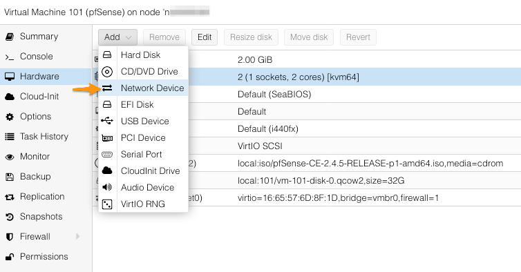

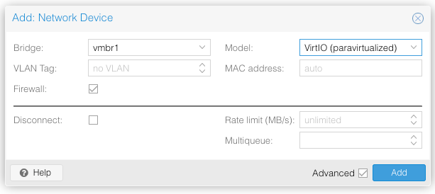

After creating the virtual machine, you’ll need to make sure that a second network interface is created on your second bridge interface:
Adding a second network interface to the pfSense VM
Second network interface assigned to vmbr1 bridge

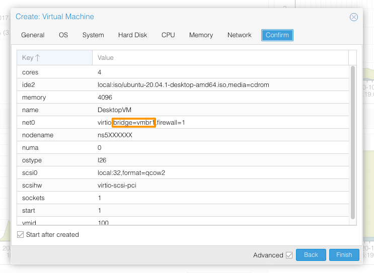

Creating the virtual machines: Virtual desktop
Since some of the settings on pfSense are accessible using its web GUI, the easy way would be to set up a virtual desktop. In this demonstration, we’re using an Ubuntu 20.04 ISO. When creating the virtual desktop, make sure the bridge interface being chosen is the secondary one and not the bridge interface to your public network.
Ubuntu desktop VM creation with secondary bridge selected

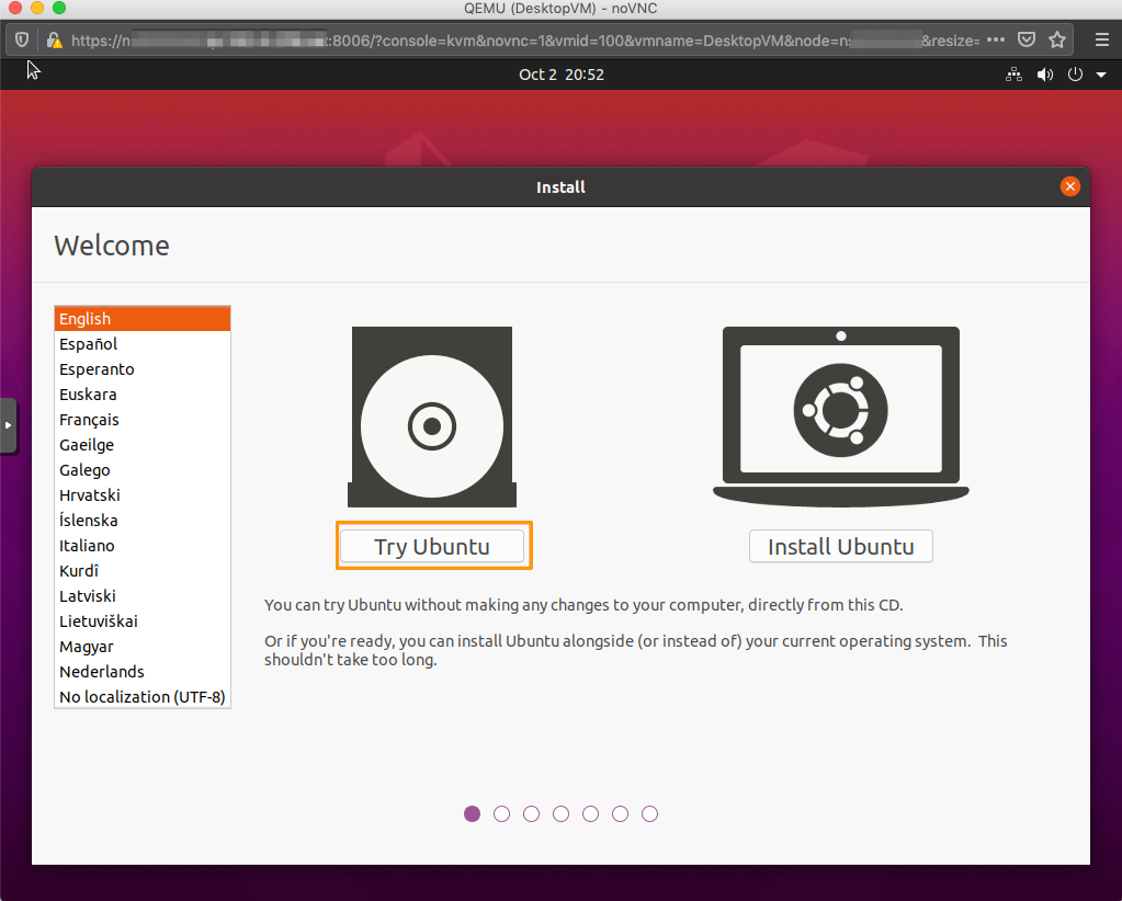

We’ll be starting the virtual desktop before starting up the pfSense virtual machine. For the demonstration, we’ll just select Try Ubuntu just to start working on pfSense, might install later.
Ubuntu live desktop with Try Ubuntu option selected

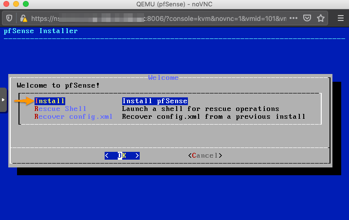

We’ll now be starting the pfSense virtual machine and proceeding with the OS installation.
pfSense OS installation welcome screen

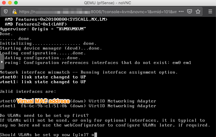

After the OS installation is completed, first thing pfSense will ask is setting up VLANs. Since pfSense is being installed into a hypervisor, we wouldn’t suggest configuring it on the virtual machine but if you need VLANs, this should be done on the virtual interface at the hypervisor level.
pfSense VLAN configuration prompt after installation

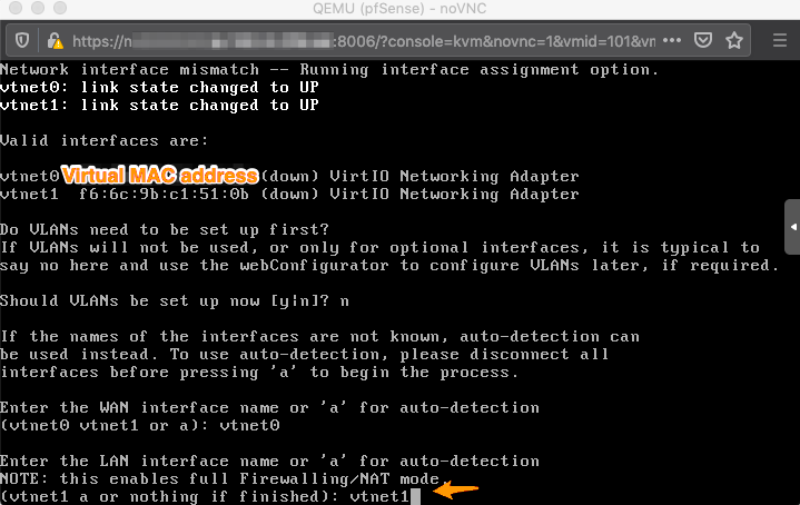

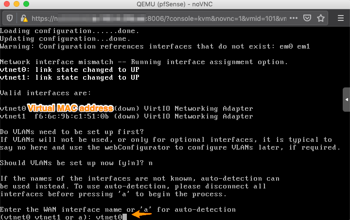

Next step is choosing which interface will be your WAN and which will be your LAN. We’ll be able to see which should be the WAN by seeing that it has the virtual MAC address that was created in the OVHcloud Control Panel.
pfSense WAN and LAN interface selection by MAC address
pfSense console confirming WAN and LAN assignments
This example we chose vtnet0 as our WAN and vtnet1 as our LAN. After this step, pfSense will ask if you’d like to proceed and confirm which interface is WAN and LAN. After confirming, it’ll automatically configure 192.168.1.1 on its LAN interface.

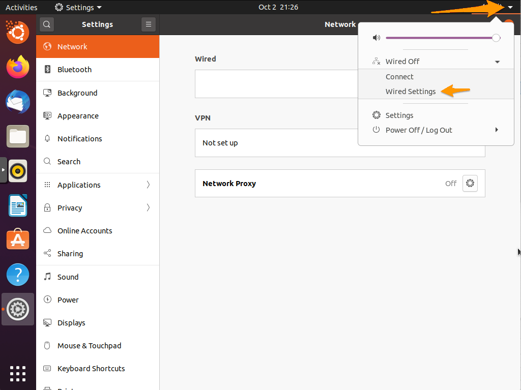

Go to the Wired settings on the Ubuntu VM.
Ubuntu VM wired network settings panel
Now we enable the network, if it was already enabled simple disable then enable it again.
Enabling the wired network connection on Ubuntu VM

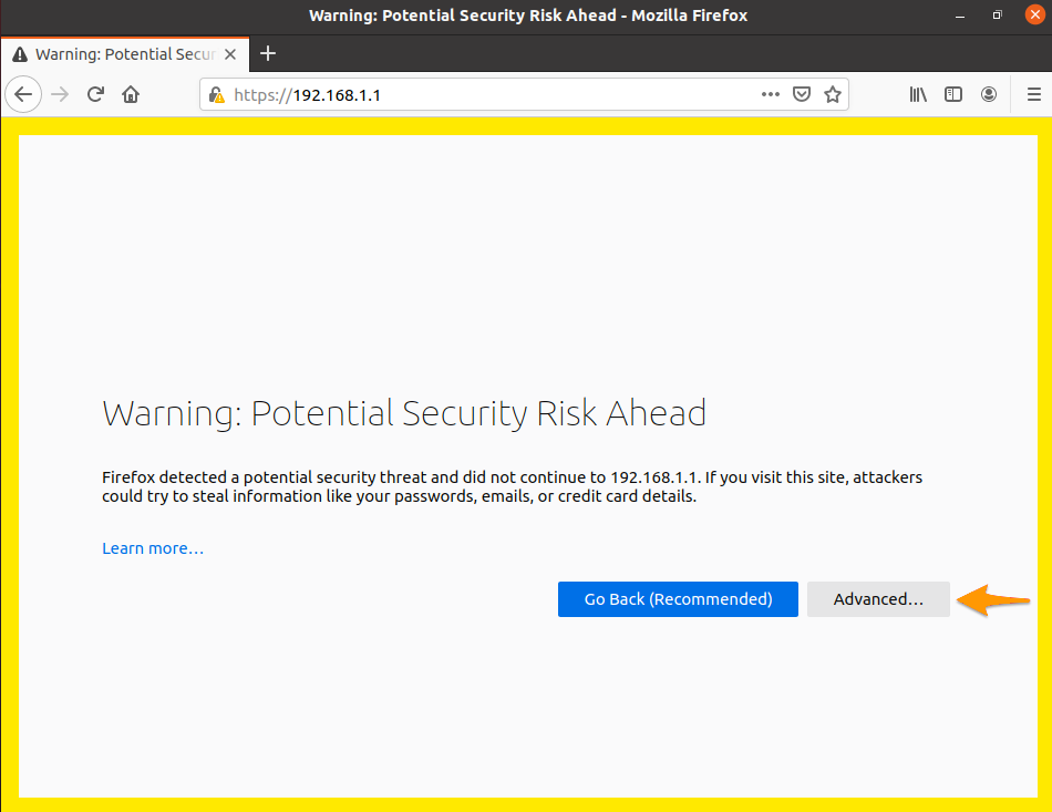

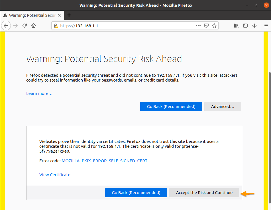

Open a web browser and enter 192.168.1.1 into the URL, there will be a security warning about the interface but it’s not something to be concerned about. Be sure to open advanced select Accept and Continue.
Browser security warning when accessing pfSense web GUI
Accepting the security exception to proceed to pfSense

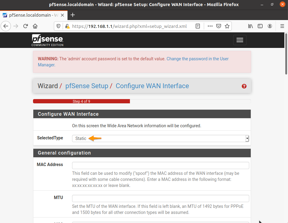

Default username and password should be admin as the username and pfsense as the password, be sure to login. We’ll now be going through the general setup, the important thing to do would be to set SelectedType as Static under Configure WAN Interface, this would be at step 4 of 9. All the other settings shouldn’t be changed with the exception of the DNS can be up to you but in this use case we had put 213.186.33.99 since it’s our resolver within our network.
pfSense general setup wizard with WAN set to Static

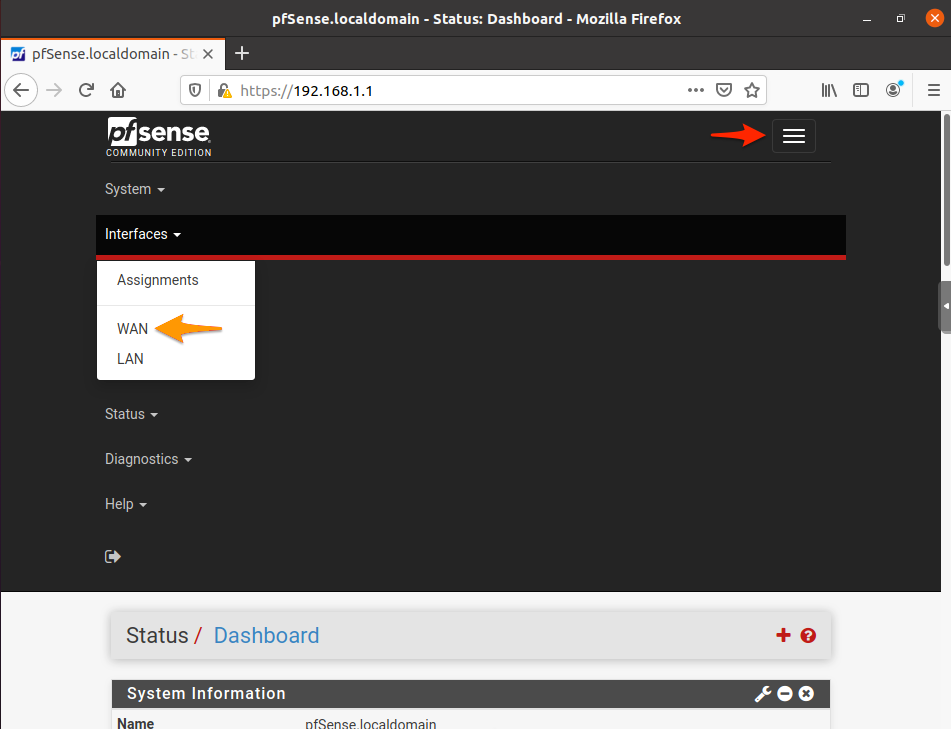

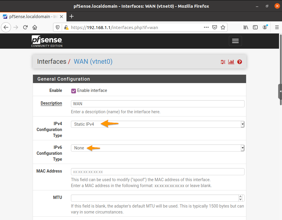

At the stage, the pfSense VM doesn’t have a public IP. Click on the menu icon on the top right corner, under Interfaces select WAN.
pfSense Interfaces menu selecting WAN configuration

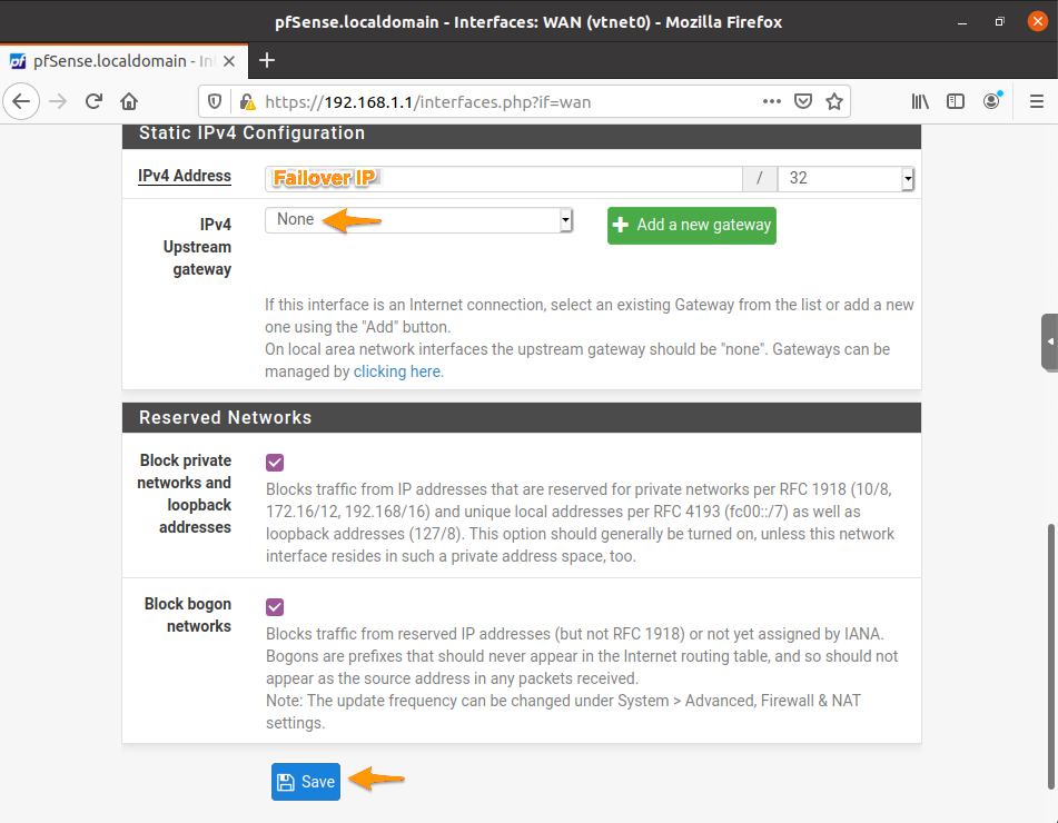

Make sure the settings are matching from what is shown in the below screenshots and enter your Additional IP. The IPv4 Upstream gateway will be configured later.
WAN interface settings with Additional IP and /32 subnet
Saving WAN interface configuration changes

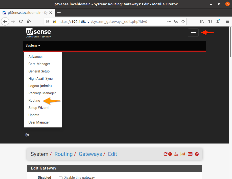

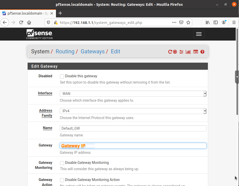

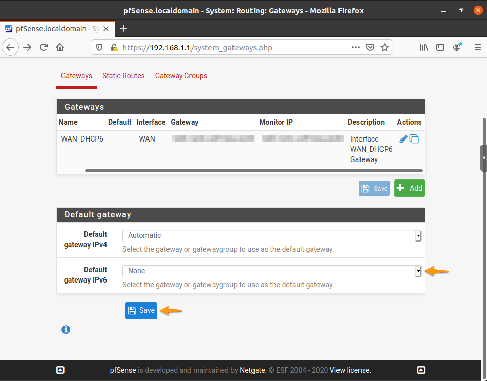

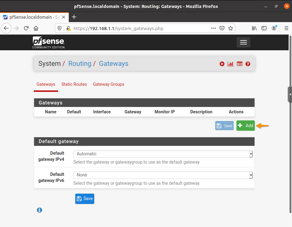

Now that we have a public IP on the interface, we’ll need to make sure it’ll route correctly on our network. Click on the menu icon on the top right corner, under System select Routing.
pfSense System menu selecting Routing configuration
Make sure the settings are matching from what is shown in the below screenshot, then select the Add icon to create our gateway.
Routing gateways page with Add button highlighted
New gateway creation form in pfSense

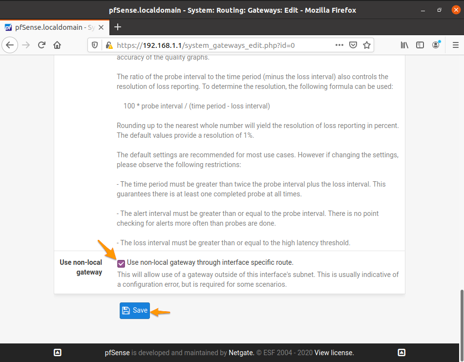

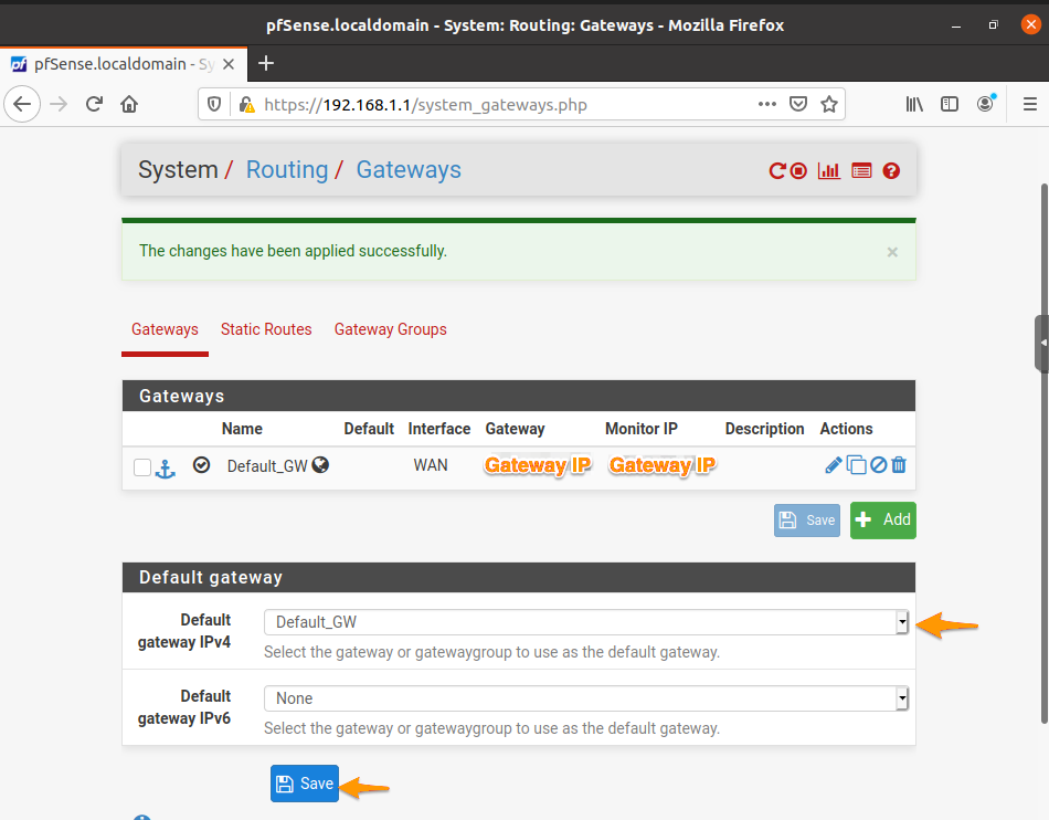

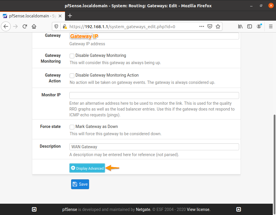

Make sure the settings are matching from what is shown in the below screenshots and enter your Gateway IP. Make sure to open the advanced settings.
Gateway IP address and interface settings
Gateway advanced settings with upstream configuration
Saving the new gateway configuration
Gateway list showing the newly created upstream gateway
Now that we have an Upstream gateway, we’ll need to assign the gateway to the WAN interface. Again we click on the menu icon on the top right corner, under Interfaces select WAN.
Navigating back to WAN interface to assign the gateway
Selecting the upstream gateway on the WAN interface

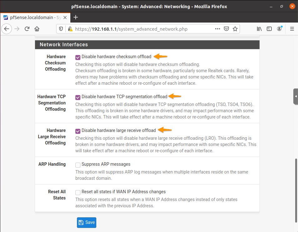

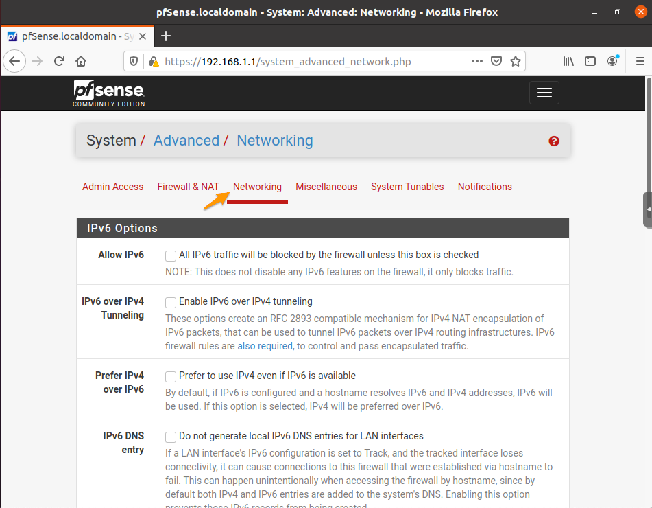

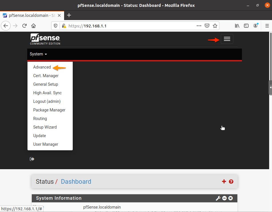

Since we’re running pfSense as a virtual machine and it doesn’t have it’s own dedicated network card, some changes should be done. Click on the menu icon on the top right corner, under System select Advanced.
pfSense System menu selecting Advanced settings
In this menu, select the Networking tab. At the bottom of this menu, make sure the settings are matching from what is shown in the below screenshots.
Advanced Networking tab with hardware checksum offloading disabled
Saving advanced networking optimizations for VM environment
Now we should be done! You should see that web browsing can be done just like a desktop behind a NAT firewall.
