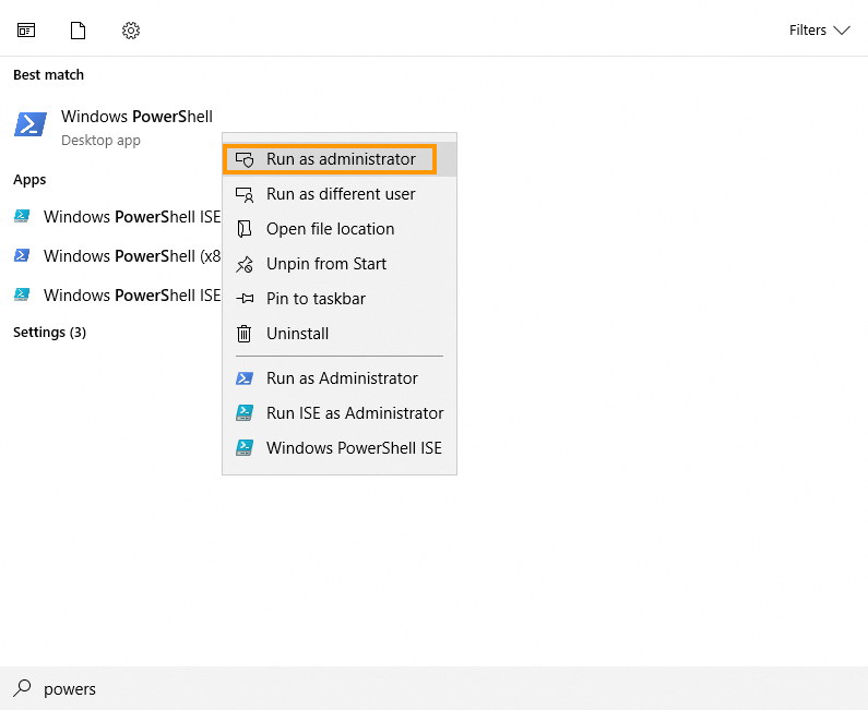

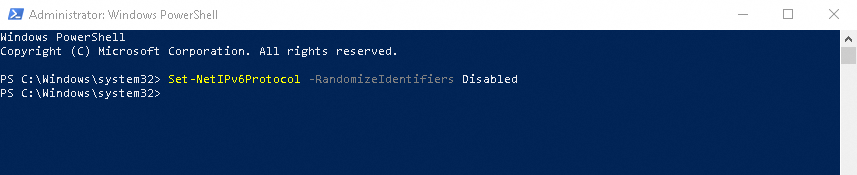

Step 1: Use RDP to connect to your server
Find more information in this guide.
Step 2: Open your server's network configuration
First, right-click on the network icon in the notification area to go to the Network and Sharing Center.

Open the Start menu, search for Windows PowerShell, right-click it and select Run as administrator.
Run PowerShell as Administrator
In the PowerShell window, run the following command:
Set-NetIPv6Protocol -RandomizeIdentifiers Disabled
Disable randomized identifiers
This step is required for IPv6 connectivity on OVHcloud infrastructure. It makes Windows build its IPv6 link-local addresses from the adapter's MAC address (EUI-64) instead of using random values. The change takes effect immediately and persists across reboots.
