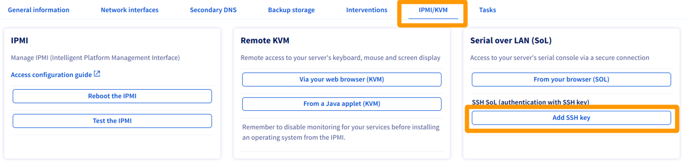

To enable one of these methods, click on the IPMI/KVM tab.

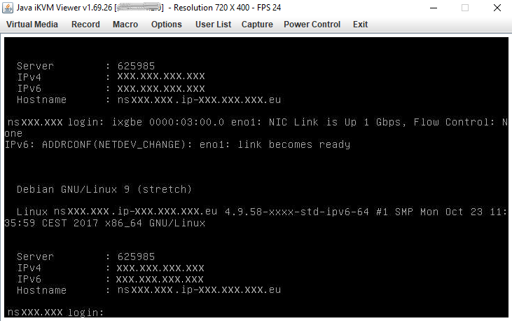

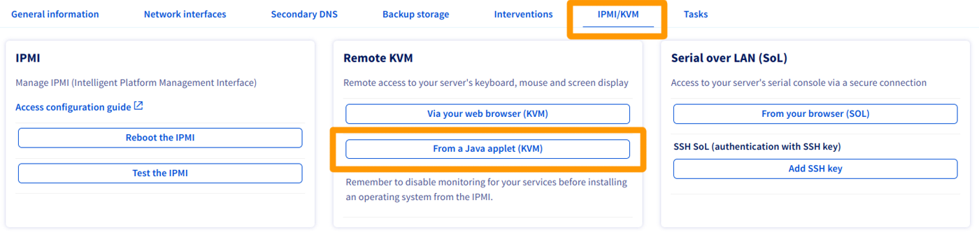

Open KVM via Java applet
We recommend installing the latest version of Java.
You will need to ensure that Java is installed on your desktop for the Java applet to work. If you do not have Java installed, go to the official page to do so.
In the Remote KVM section of the OVHcloud Control Panel, click on From a Java applet (KVM):
Java KVM Access

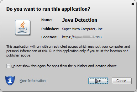

Download the file kvm.jnlp when you are prompted to do so, and run it:
Java KVM Opening
You will then land on the login page, where you will be prompted to enter your credentials, as you would need to when logging in via a terminal or external software application:
Java KVM Overview
You can now manage your server.

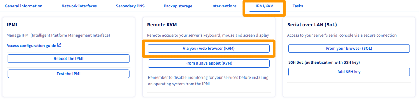

In the Remote KVM section of the OVHcloud Control Panel, click on Via your web browser (KVM).
HTML KVM Access
Activation takes a few seconds. You will receive a message confirming that the IPMI connection is available.
HTML KVM Opening

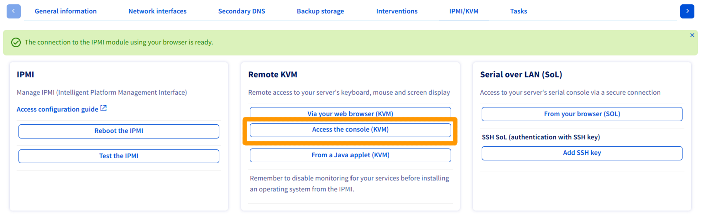

Click on Access the console (KVM) to open the console in your web browser.

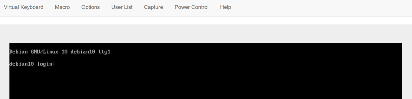

HTML KVM Overview

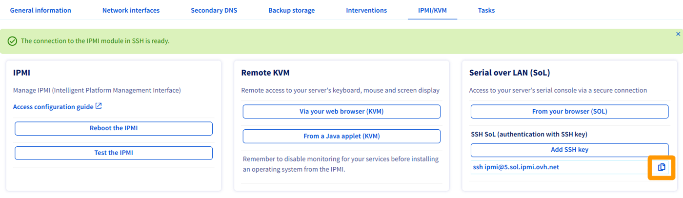

Open SoL via SSH
For more details about creating SSH key pairs, see this page.
In the Serial over LAN (SoL) section of the OVHcloud Control Panel, click on Add SSH key.
SSH SoL Access
A popup will open so you can enter the public SSH key you want to use to connect with. Then click Launch SoL session via SSH.
SSH SoL SSH Public Key
When the session is ready, a success message and an URI will appear so you can connect to the dedicated server via Serial via SSH. Copy that URI to the clipboard.
SSH SoL Opening

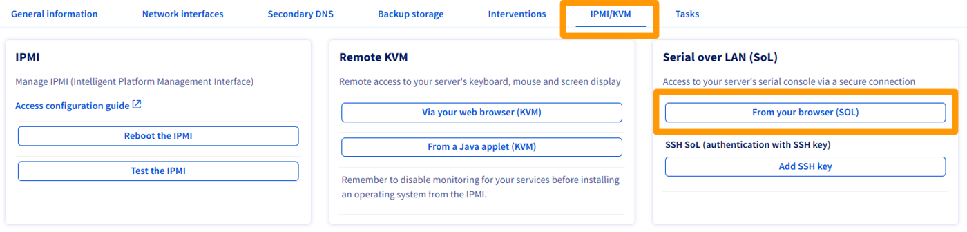

Click on From your browser (SoL) in the Serial over LAN (SoL) section of the OVHcloud Control Panel:
JavaScript SoL Access
If the switch to the popup does not happen automatically, you can still click the Go to console (SoL) button.
JavaScript SoL Opening

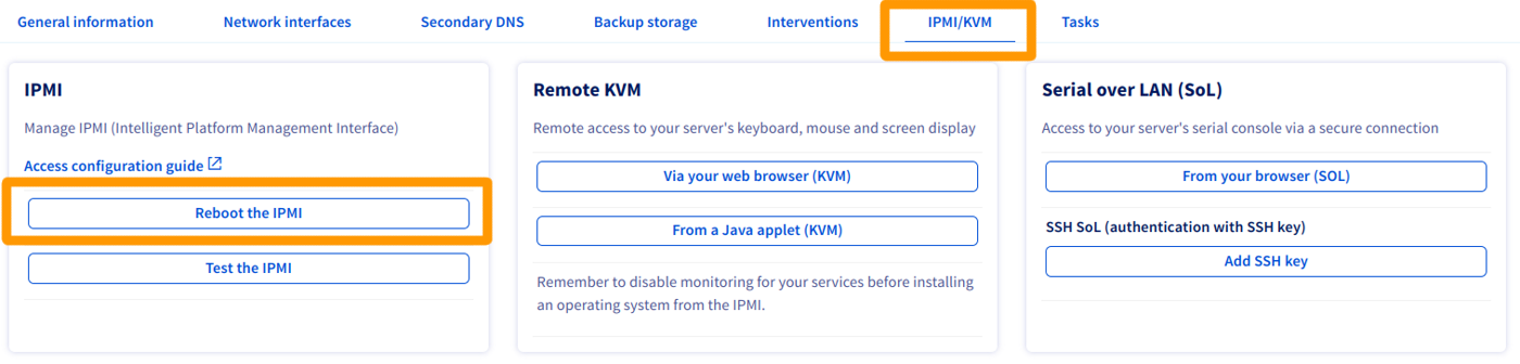

Test and reboot the IPMI

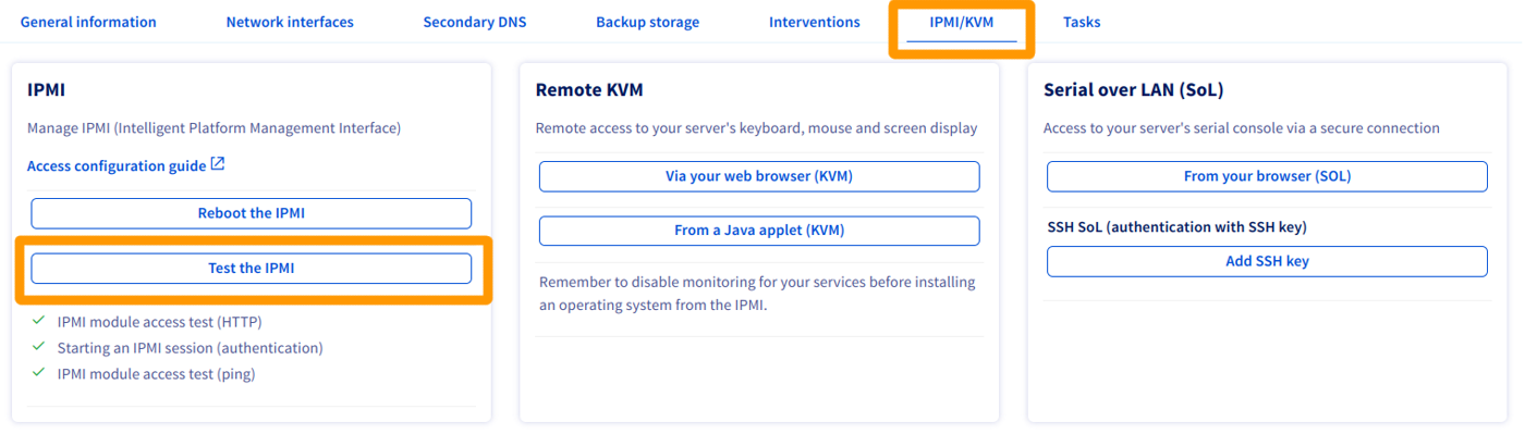

Your IPMI may stop responding. If you cannot access it, you can test it first by clicking on Test the IPMI, and checking the result of the diagnostic:
IPMI Test
If everything appears to be normal, as per our example, you may be experiencing a local technical issue (internet connection, local desktop). If the IPMI encounters any issues, you can reboot it by clicking Reboot the IPMI.
IPMI Reboot
It will take several minutes for the IPMI to reboot.
This operation will not affect the applications, data and services running on your dedicated server.

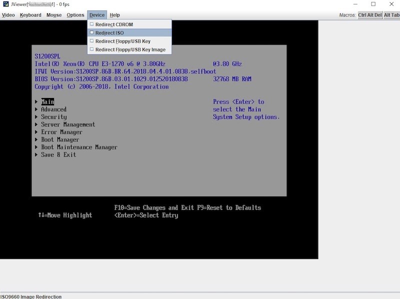

To begin, open IPMI in a Java applet from the OVHcloud Control Panel. Then, click Device from the menu bar and select Redirect ISO from the drop-down menu.
Redirect_ISO

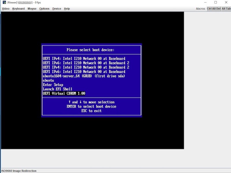

Next, select the ISO you wish to use from your local computer's file system. Once you have selected your ISO, press the Ctrl Alt Del button in the top-right corner of the screen to reboot the server. Press the appropriate F key to access the boot options.
You may need to use the soft keyboard for inputs to register in IPMI. To access this, click the Keyboard option from the menu bar at the top of the window. Then, select Soft Keyboard from the dropdown menu and click Show.
Select the UEFI Virtual CDROM 1.00 option from the boot menu to start the server from the ISO attached previously.

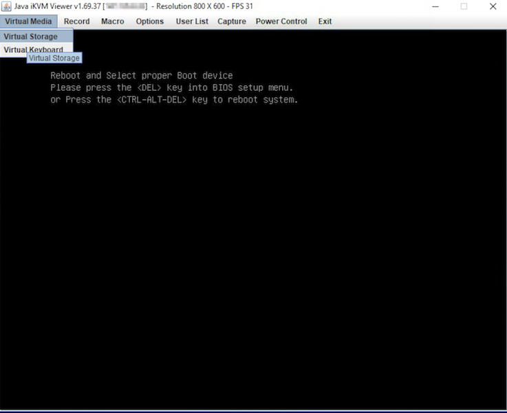

To begin, open IPMI in a Java applet from the OVHcloud Control Panel. Then, click Virtual Media and select Virtual Storage.
Virtual_Storage

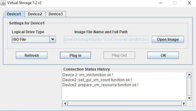

From the new screen, select ISO File from the "Logical Drive Type" drop-down menu. Next, click Open Image and navigate to your ISO file. Finally, click Plug-in and OK to finish.
ISO_file

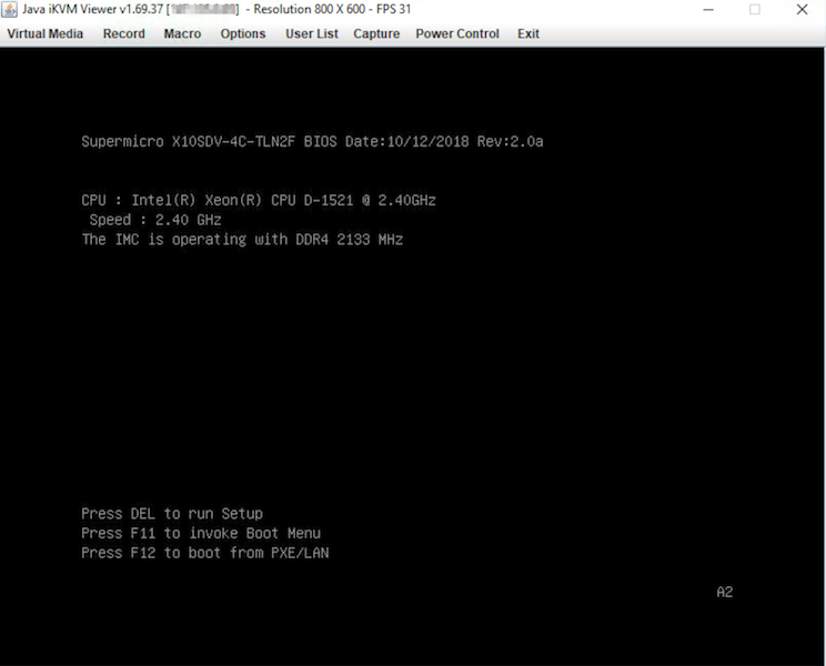

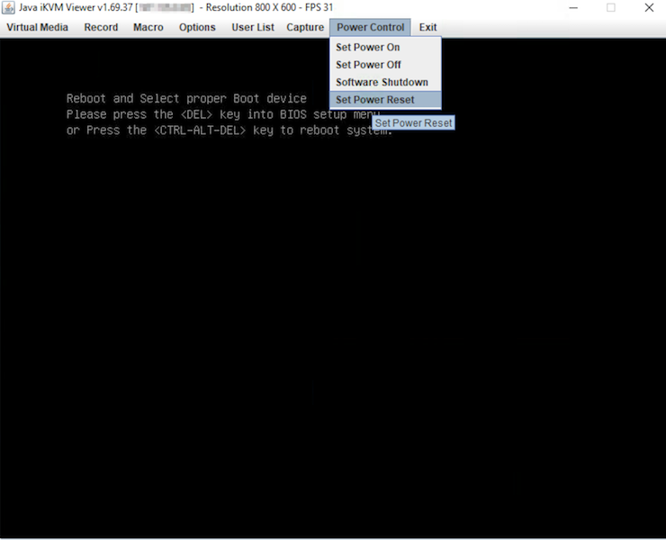

In order to be able to boot from our ISO file, we need to access the BIOS and switch our boot options. To do so, select Power Control and click Set Power Reset.
Power_Reserver
You may need to use the soft keyboard for inputs to register in IPMI. To access this, click the Virtual Media option from the menu bar at the top of the window. Then, select Virtual Keyboard from the drop-down menu.

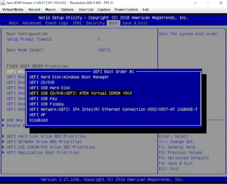

During the bootup process, press the DEL key when prompted to access the BIOS. You may also press the F11 key and navigate to the BIOS by selecting the option Enter Setup.
Boot_Menu
In the BIOS navigate to the Boot tab and change the UEFI Boot Order #1 to UEFI USB CD/DVD:UEFI: CDROM virtual ATEN YSOJ.
Bios
Lastly, press the F4 key to save your changes and restart the server.

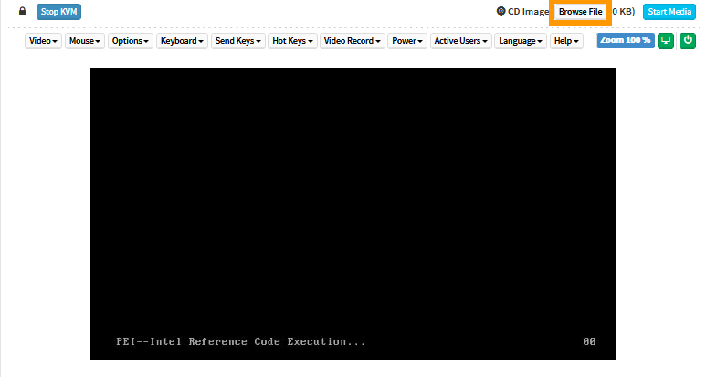

Installing an OS using web browser KVM (only for the latest servers)
OVHcloud does not guarantee the functionality of any operating systems installed via IPMI. This route should only be taken by an experienced server administrator.
In the OVHcloud Control Panel, open the KVM web browser console.
Here you have access to the same information and functionalities as in the Java-based IPMI modules.
Be sure to execute the next steps at a good pace. The process might be cancelled if there are longer pauses between actions.
Click on the Browse File button and select your image file.
KVM Install
Click on Start Media. This will prepare the ISO for the installation process.
KVM Install
The file size displayed is not the actual size. This is normal, since the file is not fully uploaded in this step.
KVM Install

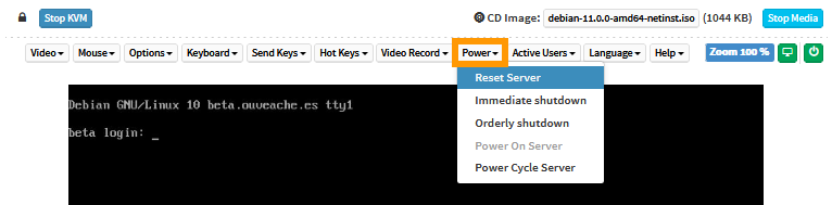

Click on Power and select Reset Server from the drop-down menu.
KVM Install

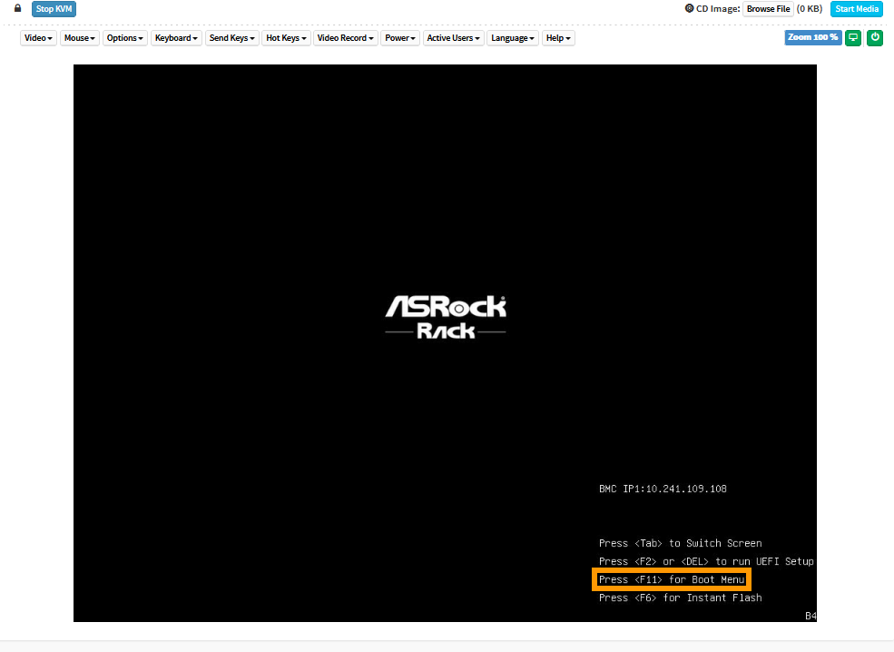

Wait for the boot selection screen to appear and press the appropriate key to enter the boot menu (F11 in this example).
KVM Install

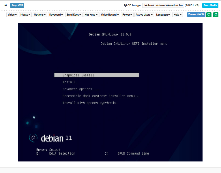

In the boot menu, select the optical drive (UEFI: AMI Virtual CDROM0 in this example) and press Enter.
KVM Install
The ISO file will now be uploaded, then the server will boot from the file.
KVM Install
