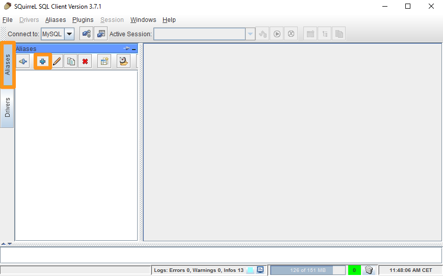

Connect from software (SQuirreL SQL)
  • Launch SQuirreL SQL and click on Aliases, then on +.
launch SQuirreL SQL

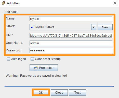

  • Fill in the fields below and then confirm by clicking OK :
    • Name: Choose a name
    • Driver: Choose PostgreSQL
    • URL: Enter the server address and port in the following form jdbc:postgresql://server:port/database
    • User Name: Enter the username
    • Password: Enter the password
config connection

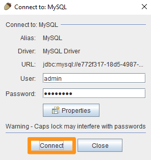

  • Confirm again by clicking the button Connect.
valid connection

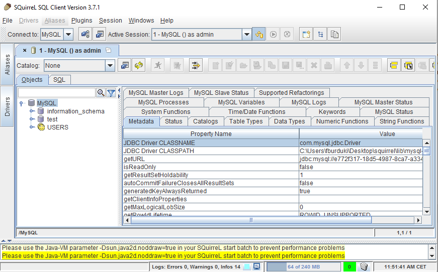

You will now be connected to your database:
config connection
